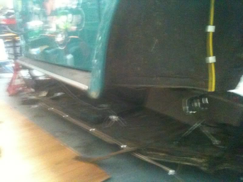

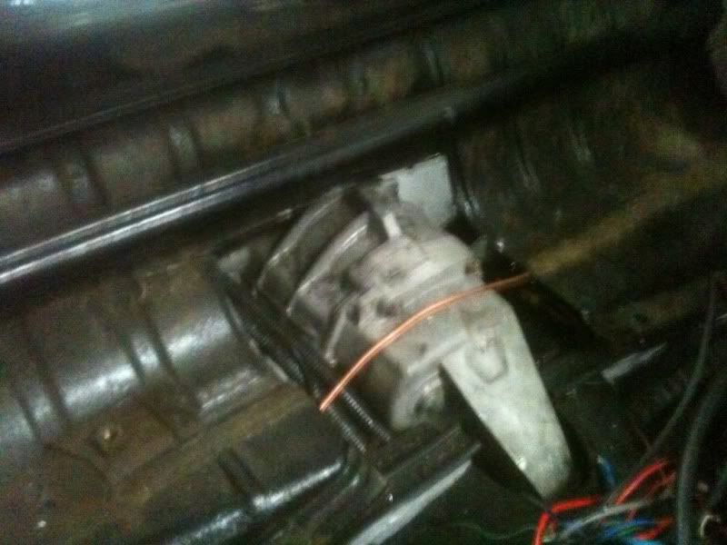

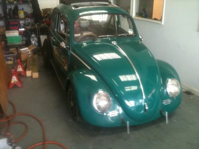

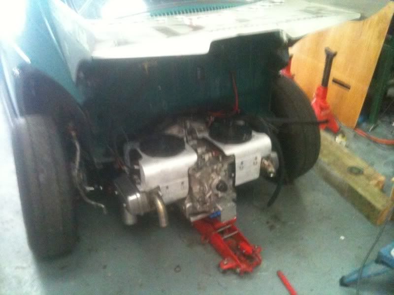

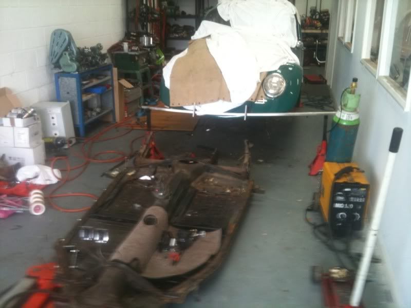

Fast65 May 30th 2011 15:20
major leep forward to day it swaped chassis
first time this has been off since 1965
http://i71.photobucket.com/albums/i1...c.jpg~original
http://i71.photobucket.com/albums/i1...f.jpg~original
I had to cut a bit more body work out to get the G50 in
http://i71.photobucket.com/albums/i1...6.jpg~original
but shes in
http://i71.photobucket.com/albums/i1...2.jpg~original
http://i71.photobucket.com/albums/i1...b.jpg~original
http://i71.photobucket.com/albums/i1...5.jpg~original
now the real work can start woo hoo
cheers andy
