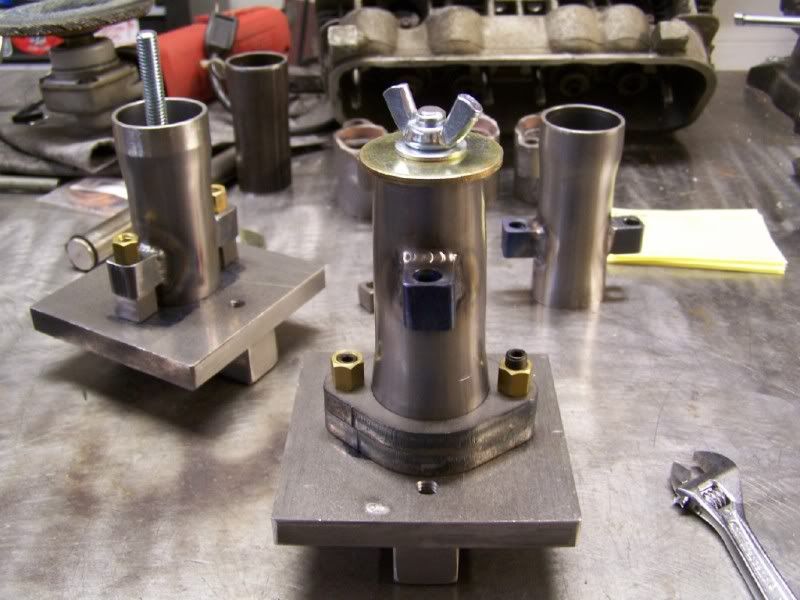

I finally got around to making my stub pipes. These are made out of 1 1/2" .095 wall DOM tubing with 3/8" flanges, and the tabs are 5/8".
http://i52.photobucket.com/albums/g3...5.jpg~original
I made a jig to weld everything together out of 3/8" plate so nothing would move when heated up. It works for locating tabs, and then for flanges.
Here's a few pix of the process...
http://i52.photobucket.com/albums/g3...8.jpg~original
This is a mock up head for testing. They drop right on!
Now I can start my header build!!!!:woohoo:

Brujo65, The tubing is 1 1/2" flared to 1 5/8" with a tool I made on the lathe. The only tube that touches is the exhaust push rod tube on #1 and #4 cylinders. They don't touch very much with a stock tube I had laying around, but the tubes on the real motor were already "modified" when I built the motor at Jake's ;)

Very nice! I thought about doing larger flanges (like CSP) for better bolt clearance, but wanted to keep it a "standard" size. The jig will help keep everything were it should be from the heat of welding. Give your friend a "practice part" to see if he can do it or not. Welding thick to thin material can be tricky for the novice. I like to help everyone out in some way... posting "how to do it" is one of them.

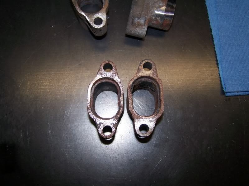

Wally is correct. I thought it was common knowledge there are two stud patterns per head. Sorry :o . I used factory cast stubs I cut off some old heat exchangers to pattern my hole locations on the jigs. If you make the holes on the mounting tabs for the studs to go through too large you risk exhaust leaks from heating and cooling cycles. Can take a pic of the difference between the two if needed.
Xellex February 16th 2012 06:09
That would be nice, thanks! I nthe meantime, I'll redo all my measurements.
wrenchnride247 February 16th 2012 21:31

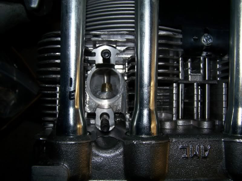

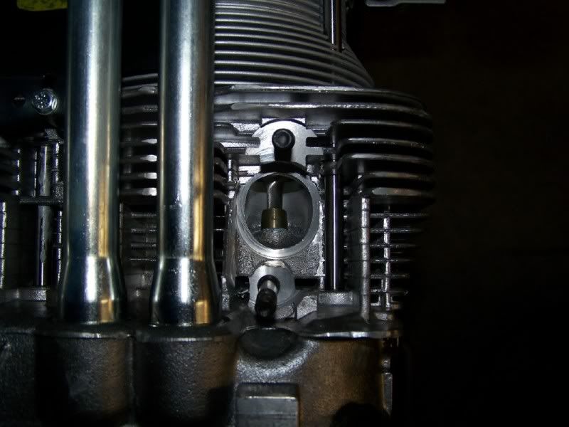

Ok, here are a few pix for you.
The one on the left is for #1 and #4. Of course the one on the right is for #2 and #3
Look at the studs in reference to the valve stem. This is #2 or #3
You can really see the difference in this pic.
Wally February 17th 2012 03:37
Those are GREAT pictures to show the difference in type 4 head stud orientation!
Thanks for the effort!
Xellex February 17th 2012 07:23
Yep, thanks alot! Now I can see what you were talking about... I did the stupid mistake to assume the studs should have been originally perfectly centered, and that those in the heads that I was measuring were bent...
It's funny that by the looks of it, the #1 stud pattern isn't at least a mirrored image of the #2... I wonder if there's any logic reason why VW did them this way...
