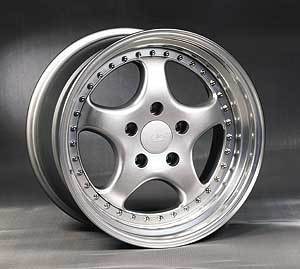

17" or 18" on a BJ IRS beetle?
I have little "problem", havent yet decided which size wheels + tires planning to buy.
I have 3cm wider front fenders and 6cm wider fenders at rear + early 944 alu arms + coilovers at the front.
Wheels i have decided to get, are these:
http://www.kerscher-tuning.de/images...Zw==&width=300
http://www.kerscher-tuning.de/raeder/index.php?id=2
Great looking wheel for beetle, i think. Front wheels planned at size 7,5" and et 41, rear wheels 9,5 or 10" and et between 50-60.
Only problem that there is not much choices at tires if i want at back wider than 255 at size of 17", there is few, like 265/40 or 275/40, but these usually cost more than 265/35 18.
Will the ride be much worse if i get 215/40 18 + 265/35 18 tires instead of 215/45 17 + 265/40 17 tires?
I know that these front wheels and tires will fit to front, but what about rear? If the wheels have too much et, spacers can be used, what would be optimal et with these wheel sizes?

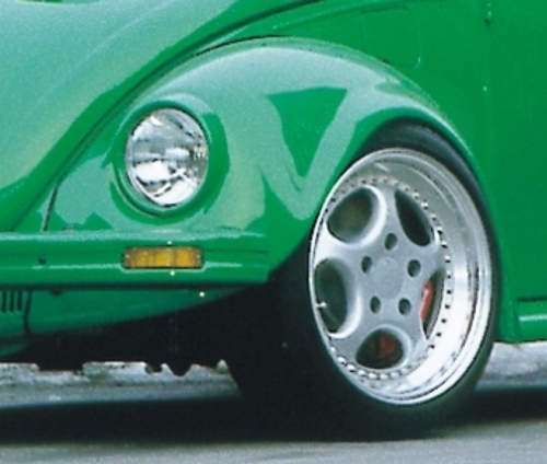

-Alex- September 1st 2011 13:18
Ok, things have changed. I have bought mendeola a-arm suspension (not yet arrived).
Really have decided to use 18" rims, like 3-piece one used or new. Kerscher wheels are nice because you can choose ET.
Planning to go reasonable :D , so front 7,5" wheels and rear 9,5" wheels. Wonder what et would best... Maybe at rear 60-73mm and front about 40mm

onixbonilla September 3rd 2011 13:08
Hi Alex.I would go for the 18".
The ones you choose are excellent choice with the classy looks that
do not age as most modern wheels.
Don't desperate, we will get our Mendeolas in a couple of weeks!!!:D
-Alex- September 5th 2011 03:12
Yeah, i will go with 18" wheels. This style wheel is classic but aggressive, i like them.
