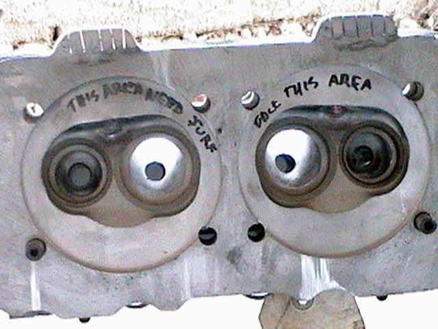

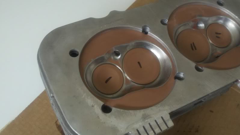

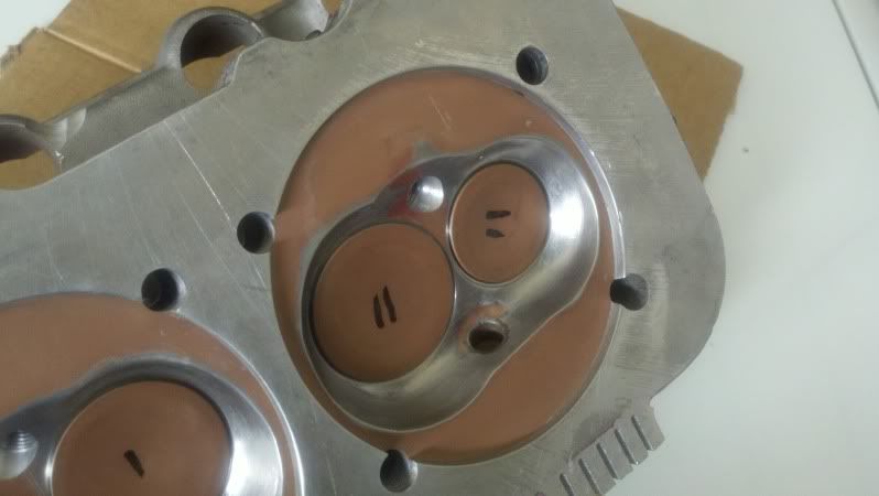

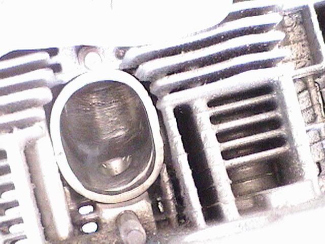

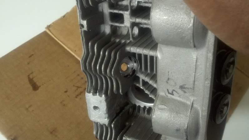

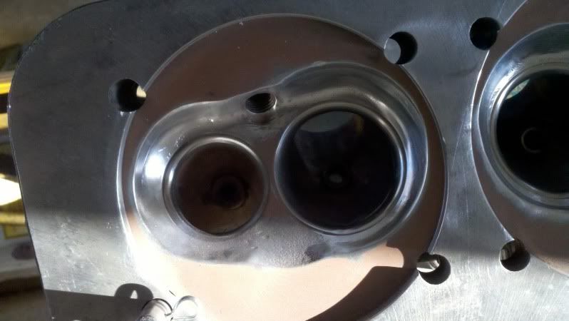

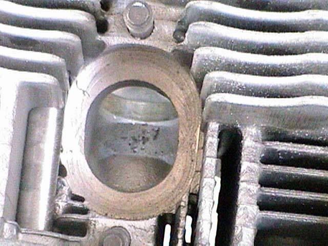

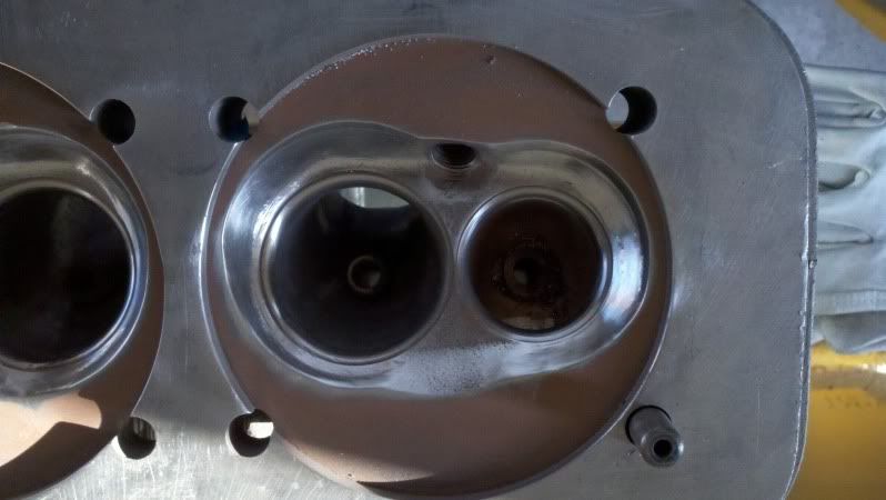

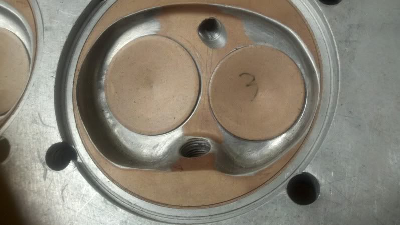

Hi everyone, I am getting to a point where I can get the second spark plug hole installed. I un-did some of my last porting, due to having seen someone else porting which I felt was much better. These heads are from a 411, they were from the 1.7 engine. I think the exhaust is 39mm X 41 or 40mm. Have a look and make suggestion on any imporvements I can make before the plug addtion and coating and "O" grooves.
http://i86.photobucket.com/albums/k9...9.jpg~original
http://i86.photobucket.com/albums/k9...d.jpg~original
http://i86.photobucket.com/albums/k9...7.jpg~original

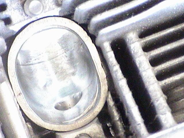

This is the flange, the exhuast pipe will be welded to it
I will need to have the seats re-ground.
Hi, am havig my machinst mill me a "O" ring groove into the head and cylinders, man I need to get this engine running.

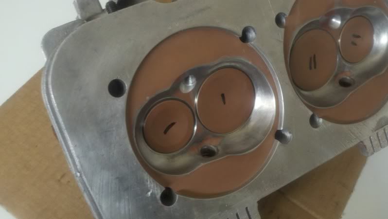

Dual spark plugs

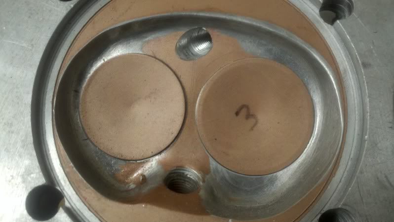

Hi everyone, I had European Motorworks add a second spark plug to my 1.7 and 2.0 heads.
Here are the 2.0 heads.
http://i86.photobucket.com/albums/k9...0.jpg~original
Jorge at EMW said that the second spark plug should be angled toward the exhaust valve, also there are 10mm. I will have the heads cryoed and re-coated.
