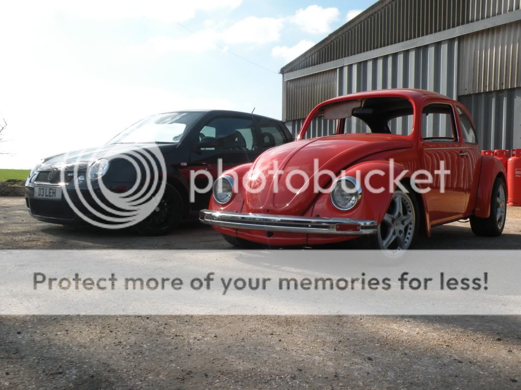

So im finally coming to the end of my 3 year long project on my bug
http://i591.photobucket.com/albums/s...8.jpg~original
and now need to consider the engine.

BTW, That is a nice looking ride.
