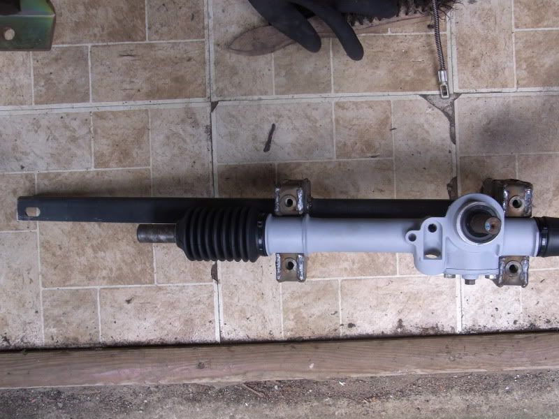

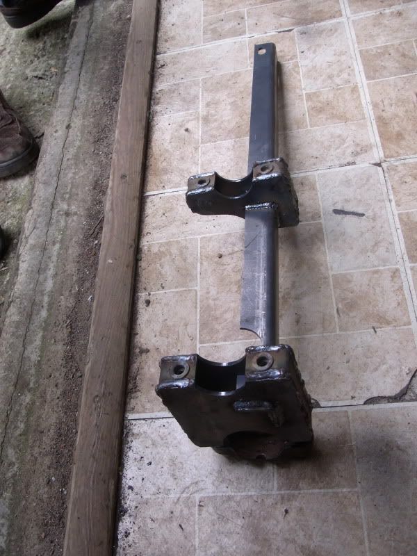

al_kaholik October 27th 2011 03:35
The rack mount. Its in paint now and has been drying overnight
http://i61.photobucket.com/albums/h6...4.jpg~original
http://i61.photobucket.com/albums/h6...3.jpg~original
Still waiting for a few little bits in the post that are taking an age to get it all finally mounted up.
-Alex- October 27th 2011 14:35
Al_Kaholik have had some installation problems, i understand his frustation. But there should not be difference between LHD and RHD cars.
I have to say to all that this is not direct bolt on, there is a little fabrication to be done.
My bracket is a accurate copy of classic centrums bracket, so with their bracket there is also same problems. But minor trimming i plan to make to my design.
Few things have came in to my mind
- Upper grease nipple on top tube may need to move littlebit from other side
- Narrowed beam and this style rack kit may not fit together
- Rubber end of the rack comes close to shock, as you can see from link below
http://www.boxergasse.com/html/stefa...tschinger.html
Don't know if there is some differences between various polo racks.
I still think that this polo rack is easiest to adapt to beetle and best is that then you can use long equal lenght tierods.
