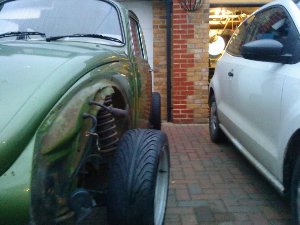

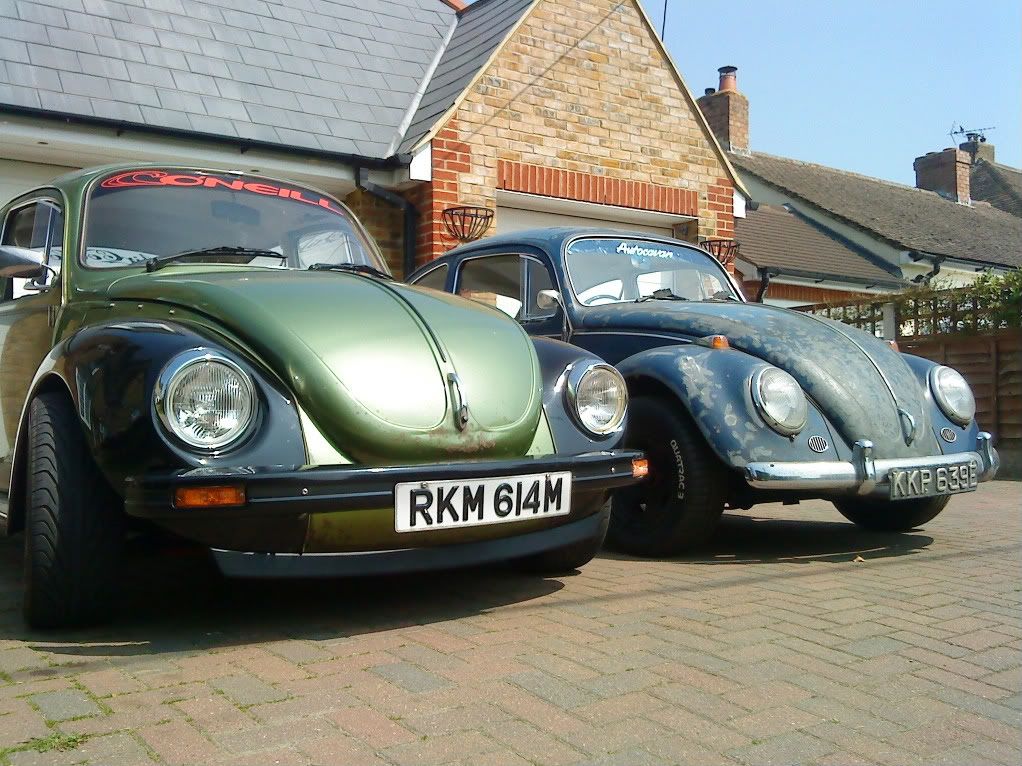

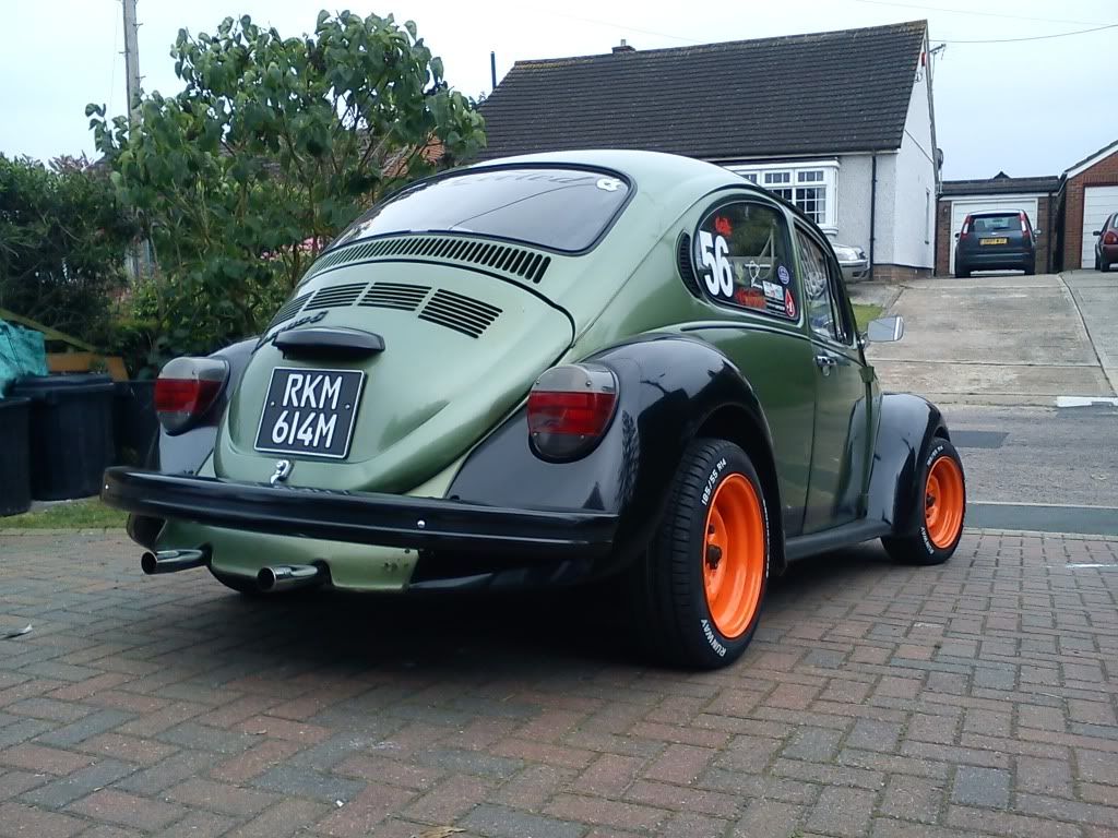

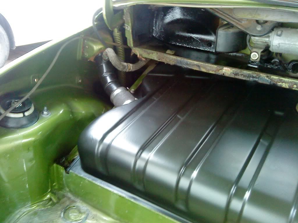

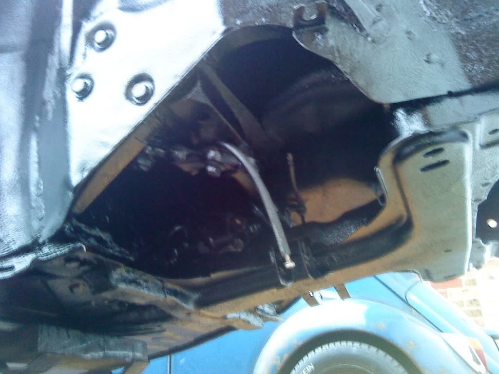

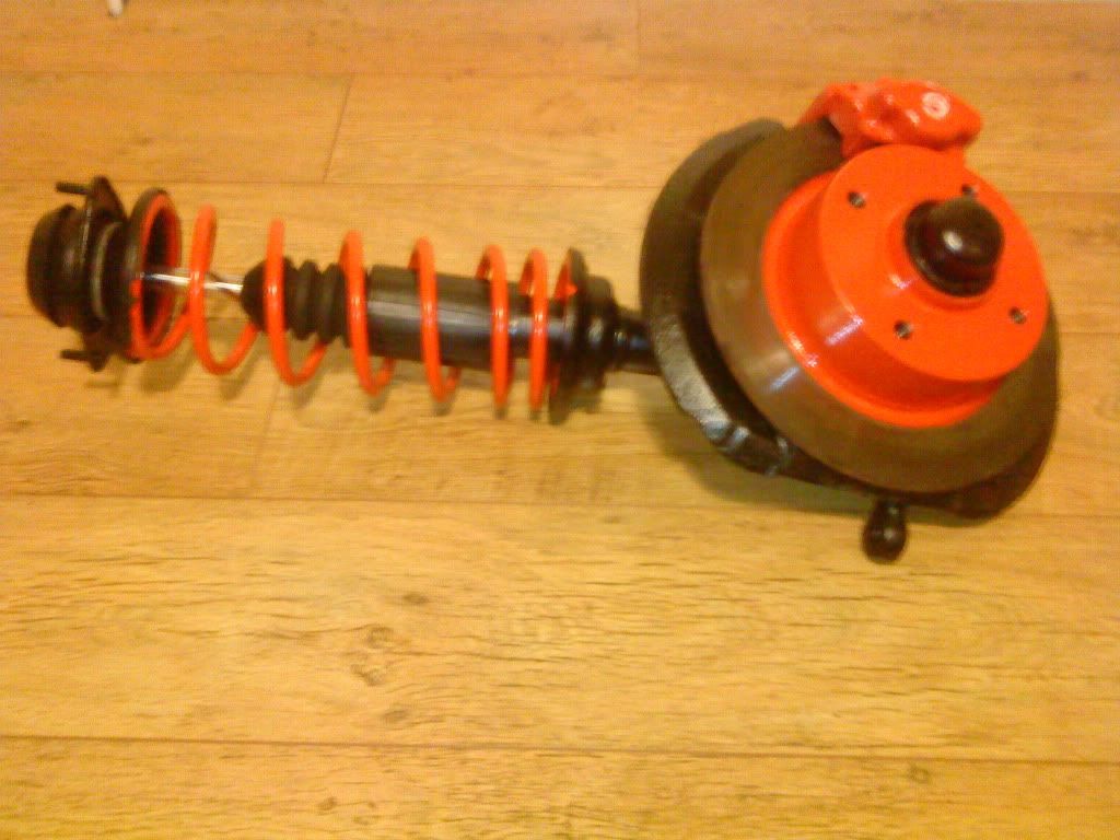

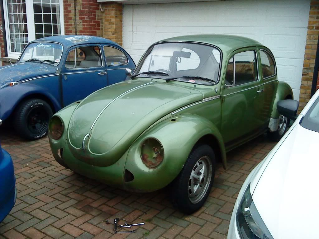

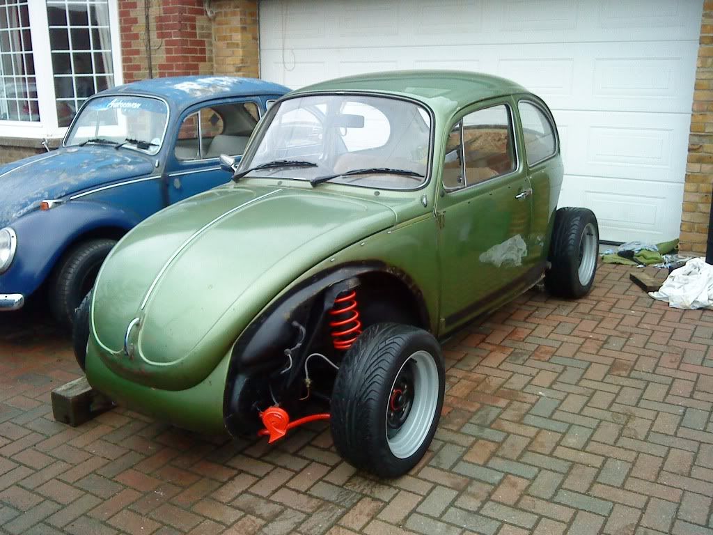

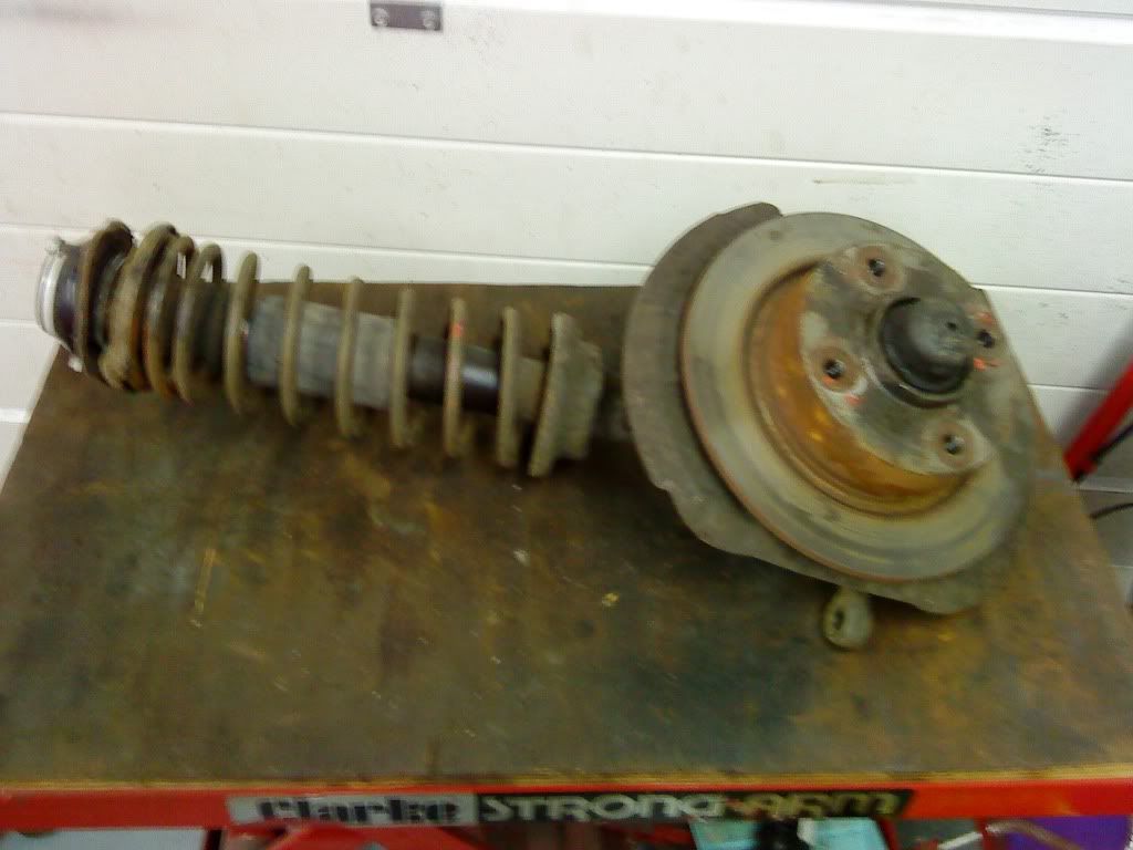

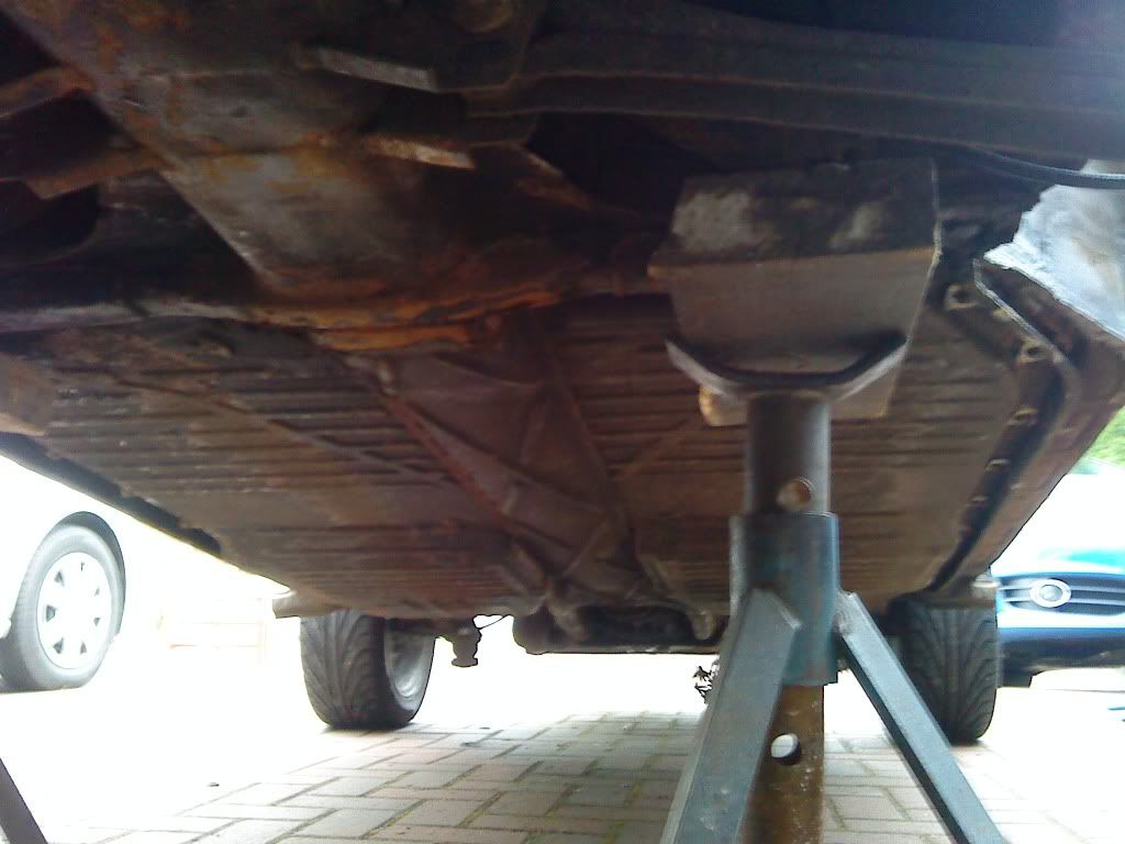

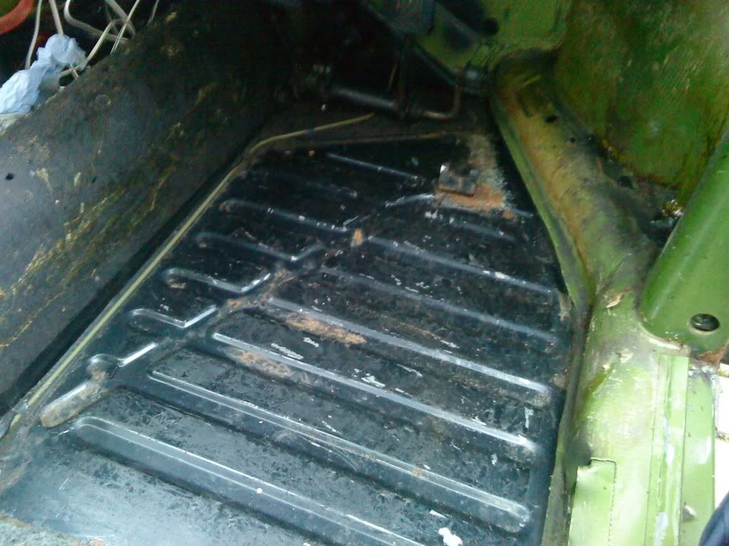

Hi everyone I thought I would show my Bug its a 1974 1303s I got the car just over a year ago and has been my daily drive. When I got the car it was completely stranded and original :) and in good nick. I'm 18 and been driving almost a year.

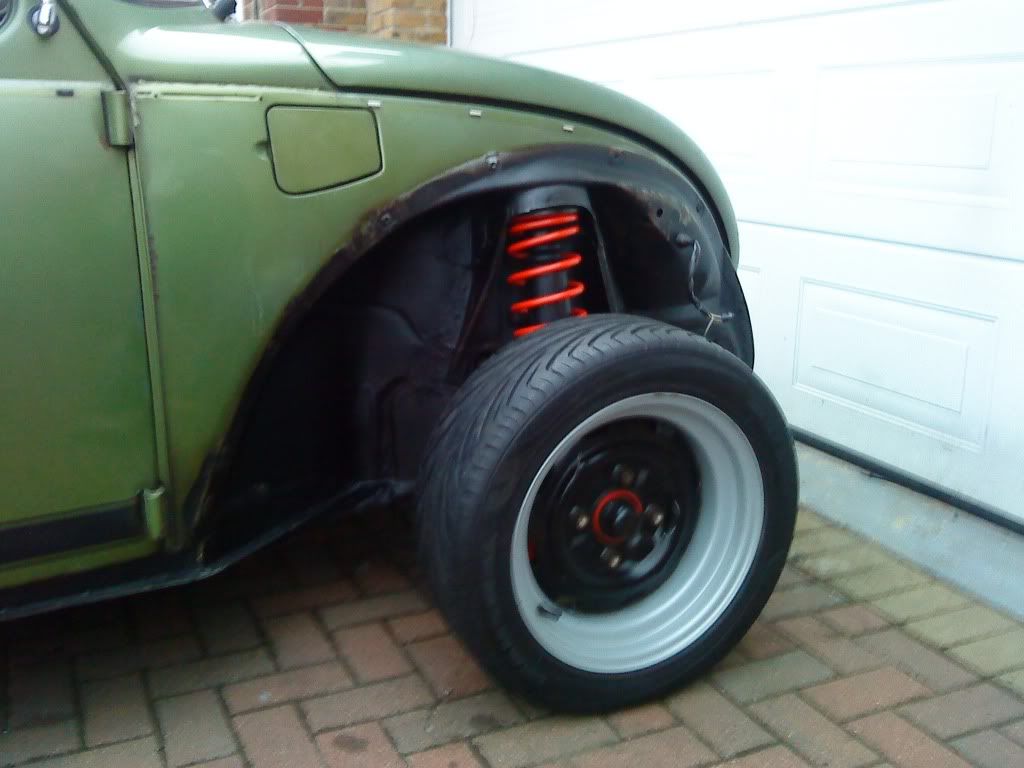

Since I'v owned the Bug I have striped most the car and checked it and rebuilt it its all waxoiled, I have put 2" lowered springs on the front and replaced basicly everything but soon i will be lowering it on adjustable struts and adjustable spring plates :) the pics will explain what iv done.

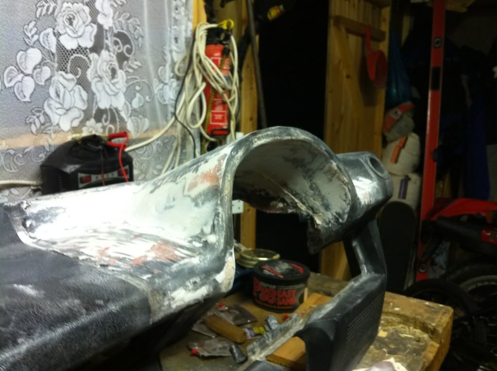

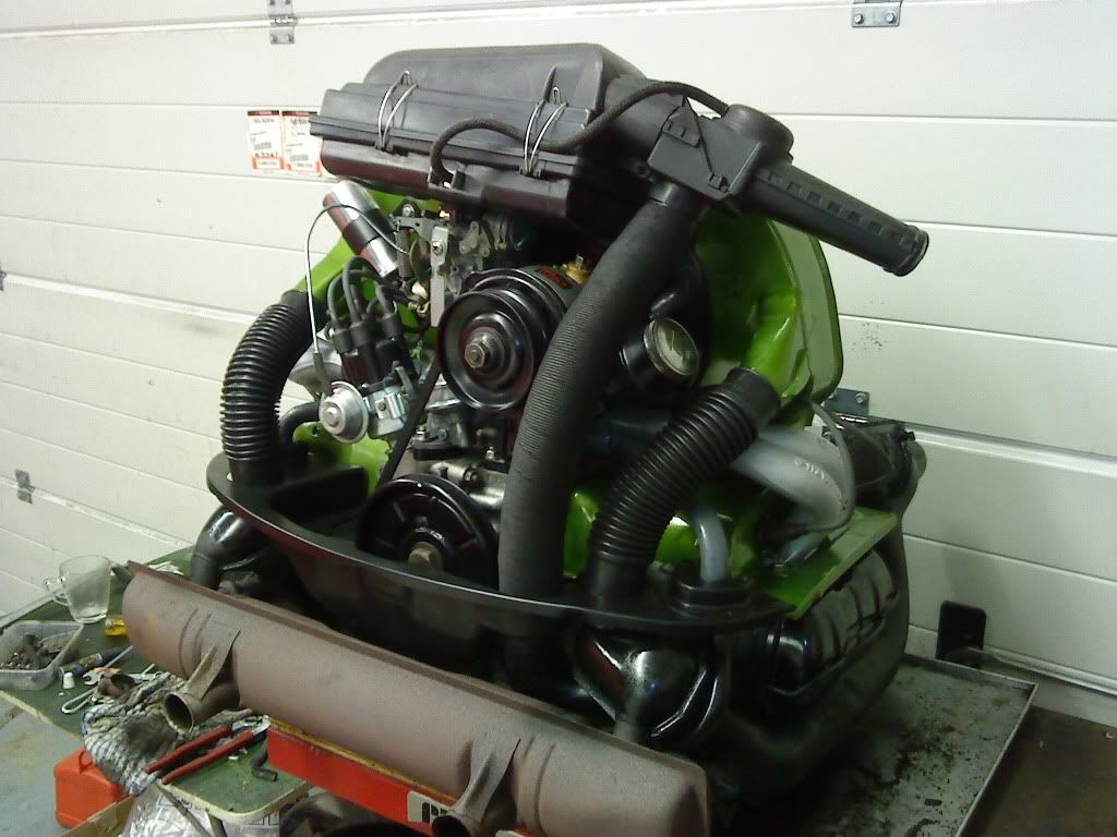

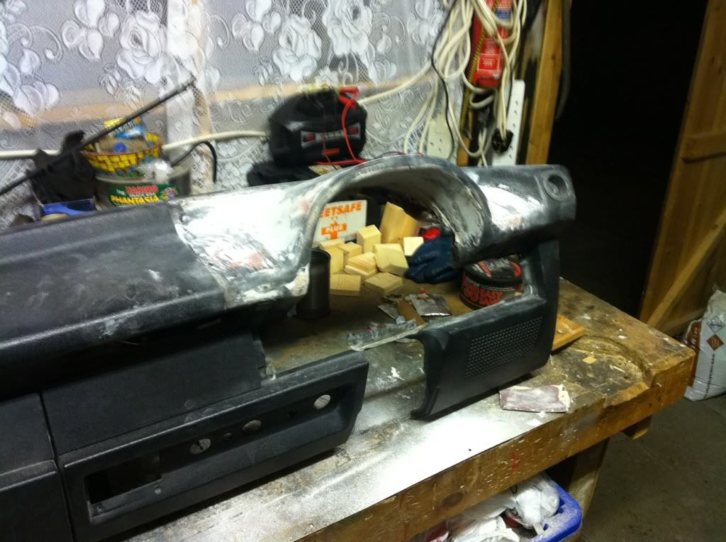

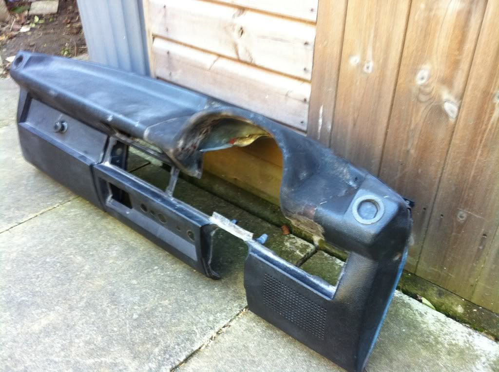

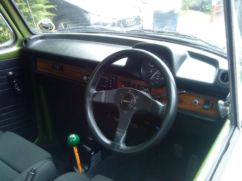

Thanks everyone im working on a couple of bits at the moment like my 5 gauge dash ;) and a 1914cc engine.....
I have been looking at everyone's Germanlook dashes and i think it really makes some cars, So i thought i would try something different as well :D The dash i am using is a dash i got from VZI, i didn't use mine as its still ok and its still in my car as i use it every day :D
This is a old pic i'v done more work on it now, i have shaped it a lot better now but cant upload pics at the moment.

Front struts?
Front 1303s adjustable coilovers!!!!!
Really dont know what the best for your money will be so can you help?
I look for performance / price but dont want to spend 1000s
I was thinking maybe Kerscher or Topline?
oasis January 18th 2012 16:05
Being in the UK, you have more options than we do in the US. I had TopLine on my 1302 and I'm 95% sure I would do it again should I get another Super. The only other option I considered at the time was Kerscher. By the time I paid the price difference and had them shipped to the US, I couldn't justify the price difference. I'm not sure how having TopLine shipped to you would affect your decision-making.
By most accounts that I remember, Kerscher is a little more robust in that it can be tweaked after being already installed and has dynamic intermediate settings whereas the TopLine MaXX (the one I used) had a finite number of settings which required the strut to be off of the car for any changes to be made.
Since I didn't race my 1302 or had wildly varying conditions, the TopLine MaXX struts were more than enough -- easy to install (the original struts were actually more difficult to work loose), high quality, and excellent response as I did take my Super to the limit on occasions.

looking good, the orange steels work well with the black wings and green body.

ok cheers that helps i was thinking kerscher but going to see if i get any more info topline do sound good though.
Yer cheers judgie will look better lower and with the 1914cc engine :)
