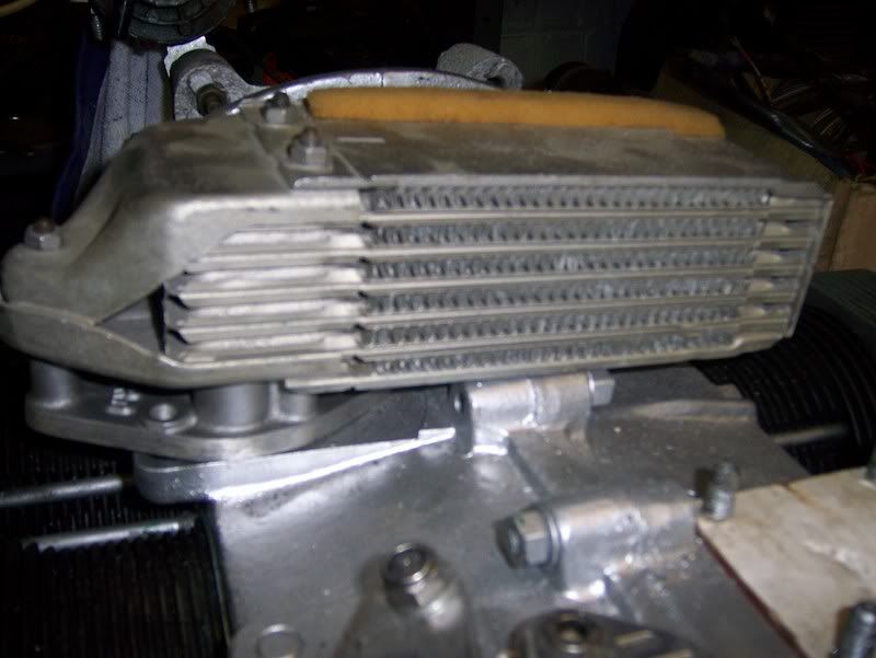

KAFUR1 March 7th 2012 12:24
So that's a type 1 case with the oil cooler laying down with a 911 shroud ???? How did you get the oil cooler to lay down in the back of the 911 shroud on the type 1 set up???????
old gh bug March 7th 2012 16:23
Hi Kafur 1
Well spotted it is a type 1 with a standard type 1 oil cooler layed down. there is a guy very close to me who builds aero engines from vw type 1's and this is a mod that he uses he has designed it himself and also he has made a lot of other things for his engines including his own fuel injection system, oil system for inverted flight etc , he has now retired and only does it for a hobby , it seems to work well for me,, so far on the little use i have had of the engine when it was in the car.I am also running an external cooler.
Here is a pic of it :=
http://i104.photobucket.com/albums/m...3.jpg~original
http://i104.photobucket.com/albums/m...7.jpg~original
