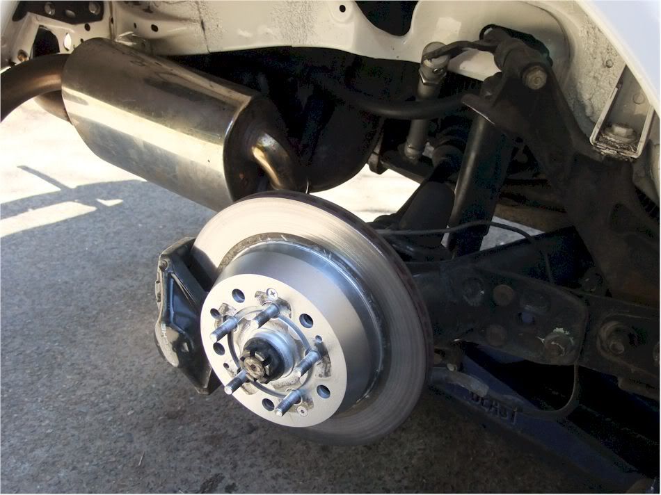

Steve C March 10th 2012 17:11
I did what you want to do on my sons 1303. The pads are tad wide for 944 rotor surface.
Late 944 hubs are a different animal.
You can use your stock drive shafts if you fit a Beetle stub axle in.
http://i1184.photobucket.com/albums/...1.jpg~original
http://i1184.photobucket.com/albums/...0.jpg~original

As Steve said. You can use 86 944T rear rotor to match the caliper (24mm wide, 3mm spacers required under caliper to center rotor), or Boxster S (2000-2004) caliper (comes cross drilled, no spacing required).
