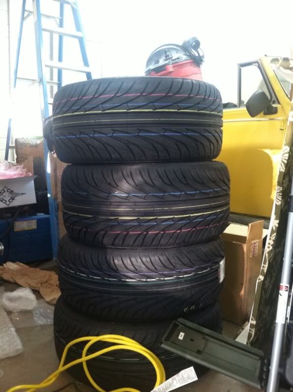

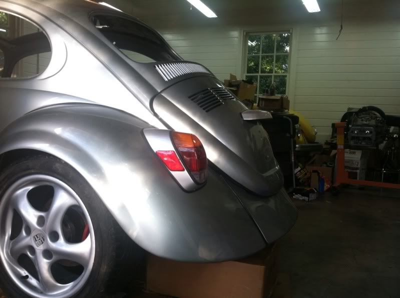

I'm in the process of building a GL 1302. The engine is a 2110 EFI Turbo/ Intercooled. It hasn't been on the dyno but I'm estimating 275-300hp. I have a set of 3 piece Hartmann wheels. The rears are 18x9.5 ET 15. The tires are Nankang NS-II 265-35-18. My question is, is this to much tire for the car/engine combo? I have the Kersher Kafer Cup Style finders so fitment is not an issue. Below is a picture of the car with 17X8.5 Turbo Twist. These will go on the yellow car in the background.

Typically tire heat for racing and hydro planing in the wet for street are big concerns for a light car with fat rubber. I think you'll be okay with a 265 on the rear for street and the tires look like they should evacuate water fairly well, so wet driving shouldn't be too bad.
