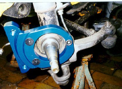

Steve C November 18th 2012 05:40
I had brackets made to bolt to the stub axle, I enlarged the dust cover mounting bolt holes, I removed the stock calliper bracket ears.
flat November 18th 2012 07:17
Yeah definitely no welding.
On the drop spindles I drill in two holes to hold the caliper bracket. It's the only way to go about it since there are no existing reference holes. And the stock caliper ears get cut off accordingly.
On stock spindles I fabricate brackets similar to what Steve posted.
