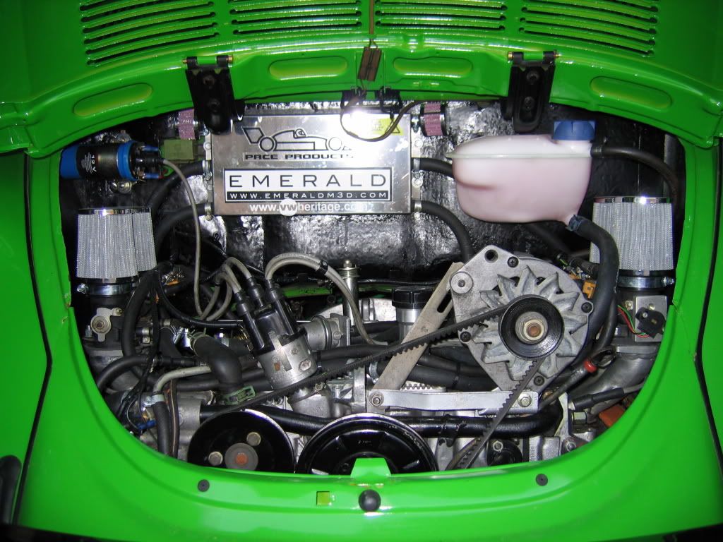

Some may recall my injected WBX GT Beetle which has been my main toy for the last 10 years, slowly evolving from a "Street Sleeper" to something less subtle...
http://i357.photobucket.com/albums/o...4.jpg~original
http://i357.photobucket.com/albums/o...E.jpg~original

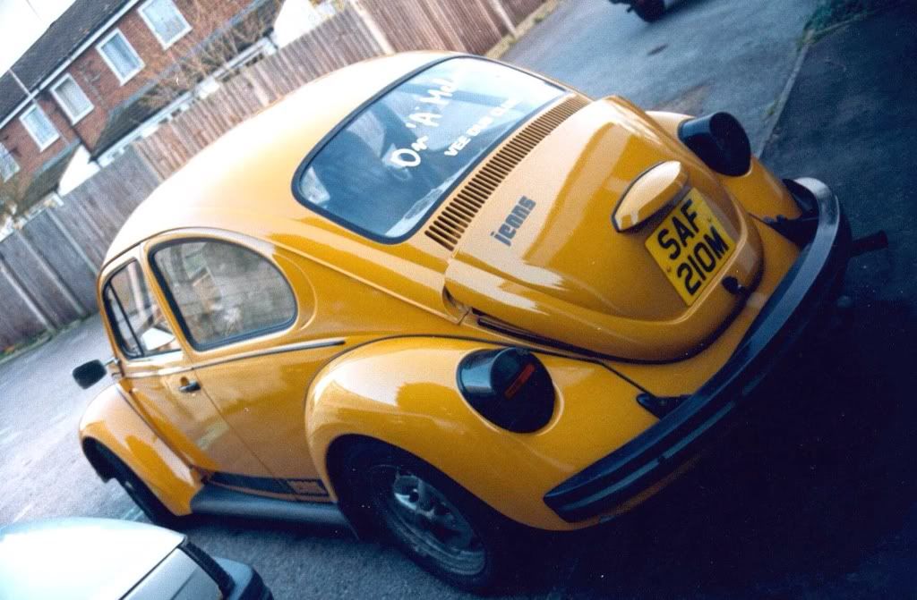

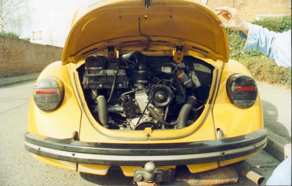

Well, there's been another toy tucked away slowly waiting its time - my Jeans Beetle. Purchased by me in 1986 when I was an eager young 16year old (To save you the mental arithmetic, I'm 43...). I am the second owner. It's first rebuild was done in 1992, and by '94 it was running a 1679cc unit with Engle120, 9.5 compression, and K-jet injection.

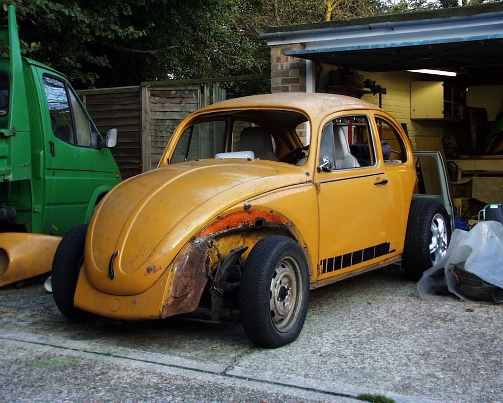

I took it off the road in '95 for "a few small jobs", and by '98 it was looking like this:
http://i357.photobucket.com/albums/o...5.jpg~original
So, 3 house moves, a wife, 2 children, the WBX Bug, and 16 years later, i was beginning to wonder whether to scrap it. But it's my first car - the one that got me in to all this! So I just couldn't...

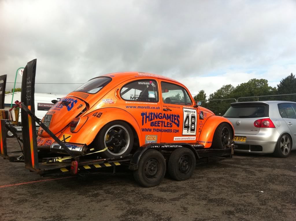

Then I had a go in this round Castle Coombe...

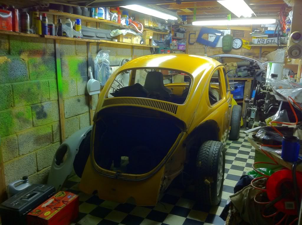

So, having owned the car for 27 years, and being the right age for a mid-life crisis, I decided it was time to thrash it round the track. I've never been turned on by straight-line stuff - corners are far more interesting to me. I have some previous history with track racing having been involved as crew in the UK's "Beetle Cup" in '93 & '94. The Beetle Cup died some time in the late '90s I think, and there's been nothing similar since then. However in the last few years the "Beetle Challenge" has been trying to resurrect the spirit of the series, with slightly relaxed rules. It was Simon Sergides's Orange Bug I had a go in around Castle Coombe - 2165cc, IRS, Quaife - it got me hooked. Sadly the recession bit and the Beetle Challenge is struggling to get decent numbers on the grids, but the regs are there. So I have decided to build to the regs, and enter in maybe the MSV Trackday Trophy and mix it up with Golf Gti's & Porsche 944's.
So, first step was to haul the car out of long-term storage and tear it down completely.

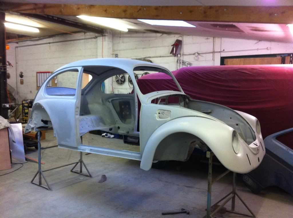

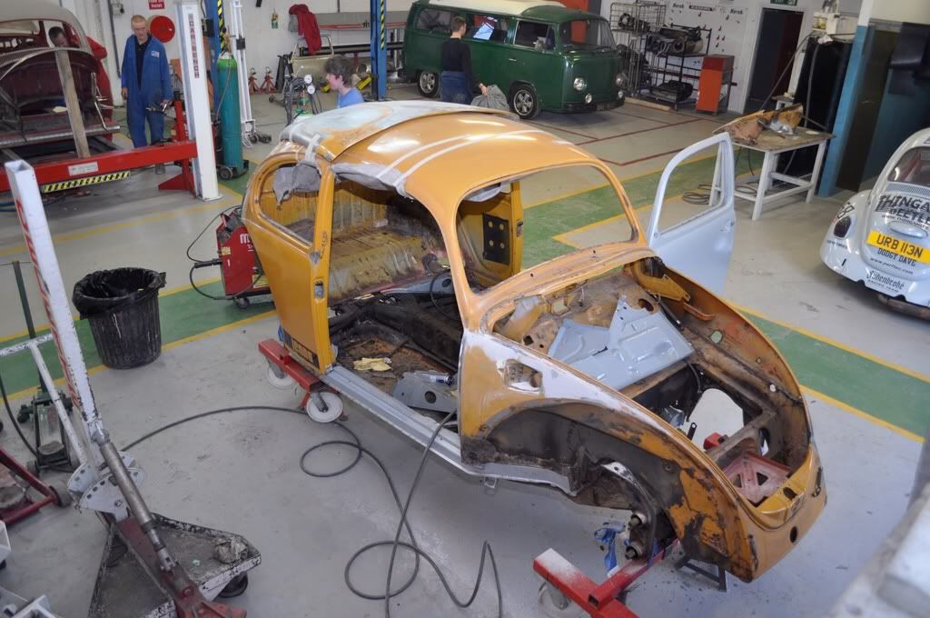

Once it was a bare shell it was sent off to the bodyshop:
http://i357.photobucket.com/albums/o...0.jpg~original
http://i357.photobucket.com/albums/o...A.jpg~original

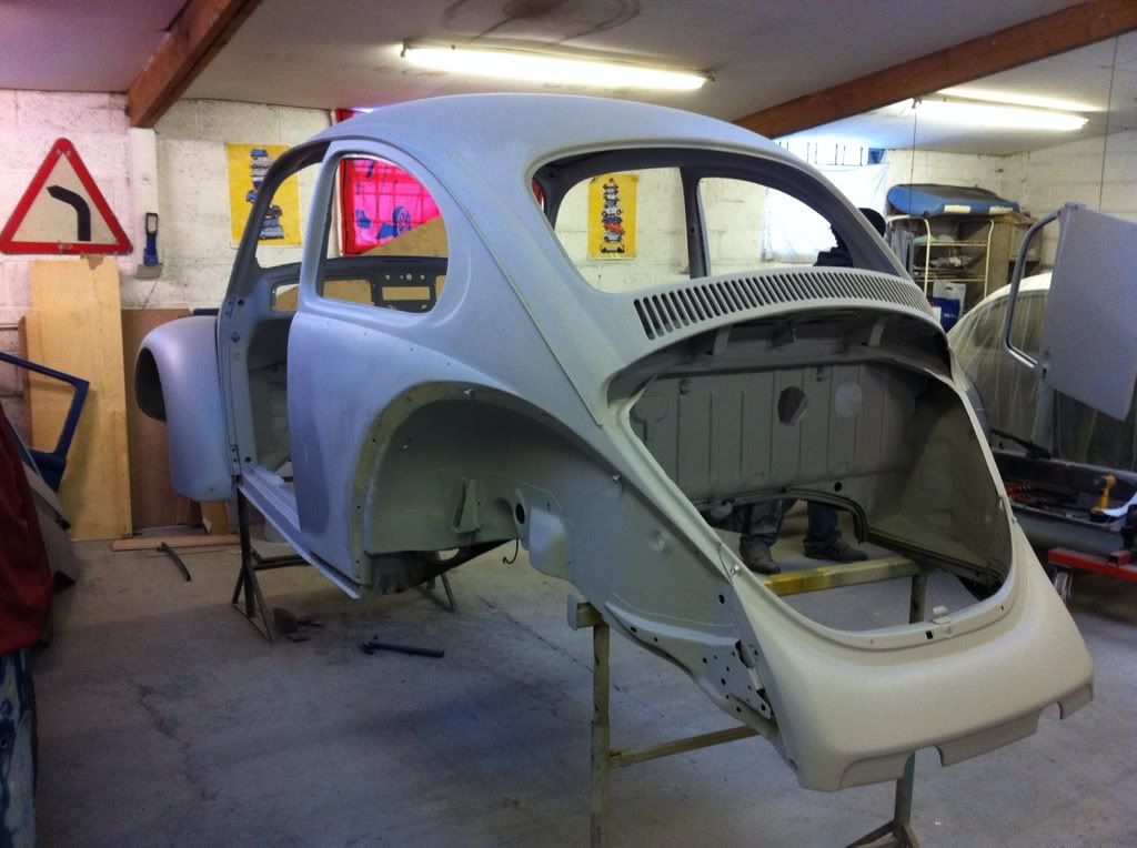

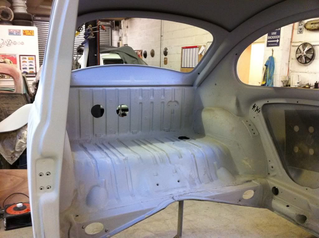

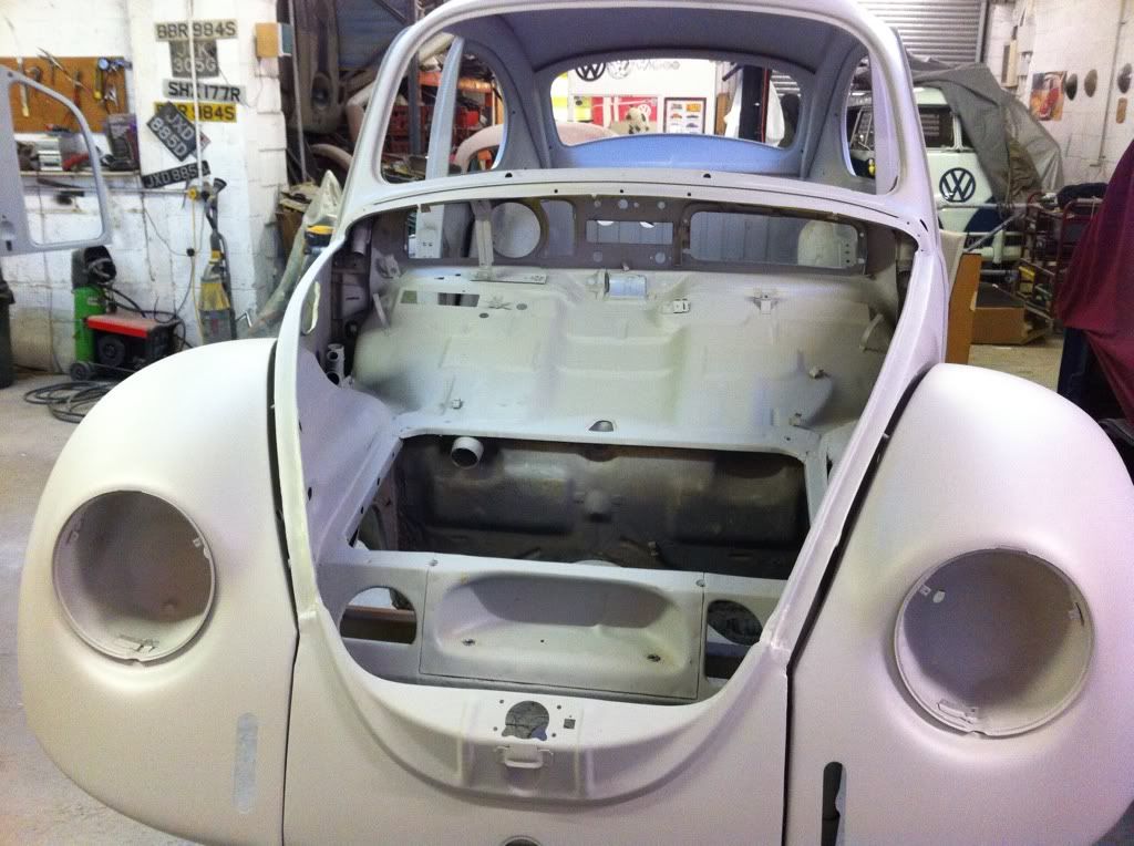

A promising start, but sadly it was not to continue... Basically i was not happy with the work being done, and after a few months hauled it out of there :-( Cue 8 months of depression before I found someone else to pick up on it. There's obviously a big gap between above and below, but this is how the shell is today:
http://i357.photobucket.com/albums/o...C.jpg~original
http://i357.photobucket.com/albums/o...8.jpg~original
http://i357.photobucket.com/albums/o...3.jpg~original
Last few mods to the shell to do, and then next week should be in paint!

Great story! Hmmmmmm wonder what those holes in the firewall are for? Turbo and intercooler?.....

Sadly no turbo/intercoolers allowed - Beetle Challenge regs state "non-turbo", MSV Trackday Trophy rules state "if turbo fitted then must be correct type for engine" so ruled out there as well. Other series seem to have similar restrictions. :-( Still, i'm targetting somewhere around 180bhp so it won't be short of power. The holes in the bulkhead are for cold air ducting straight to the back of the fan (from NACA duct in right rear window) and to oil cooler under boot floor (from NACA duct in left rear window). There is still another hole to be drilled in the boot floor for the oil cooler air-feed.

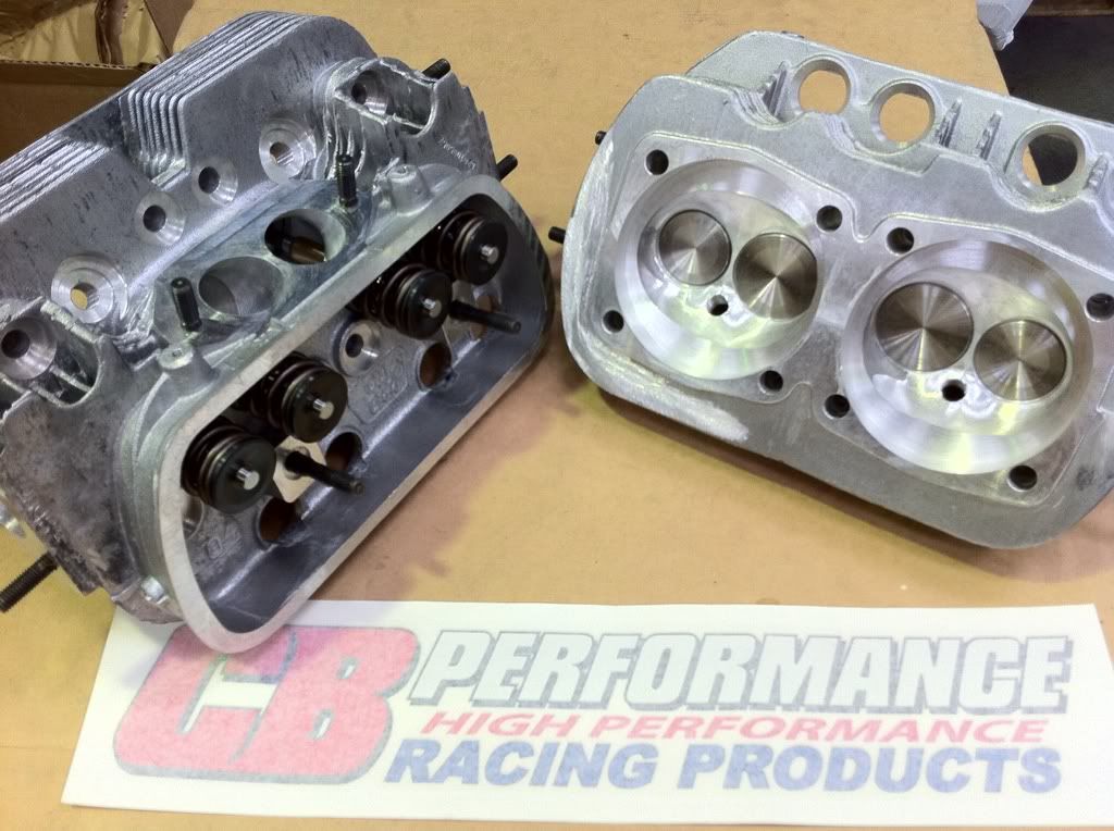

So, the build... All this body prep is no good without some motorvation, so the plan & rationale behind the engine is to start from a new-ish Mag case to keep the weight down out back. That means in reality best to keep it 90.5 bore to keep as much strength in the case as possible. A used CB 78mm crank makes it 2007cc. In order to get the max out of it then we need it to rev to 8500rpm (yikes!) so Mahle Forged pistons & CB 5.4" H-beam rods needed to link them. I think the cam settled on was an FK87, but can't be sure at the mo.
Case and crank may be used, but i did score a good deal on some new CB CNC 044's which are great as a starting point but are being worked on further, particularly to up the CR to 10.5.

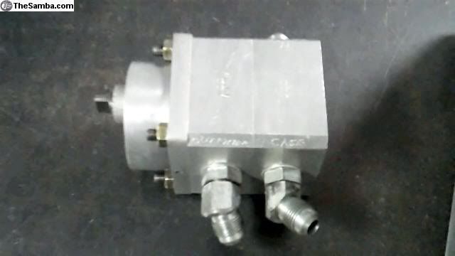

Having built a few circuit engines before, and also watching some other circuit racers have oil pressure issues, I set my heart on a decent Dry Sump system. I had a friend badger Rick at Bugpack for ages to get one of their pumps, but it never showed - something about them only being made in batches and then some bloke in Vancouver wanted one for a rally bug... Anyway I gave up on that idea, then out of the blue this popped up on The Samba:
A used but excellent condition ARPM 2-stage pump and for a few hundred bucks is was flying its way across the Atlantic :-) Then a Pace Products tank came up on eBay for less than £100... The tank fits perfectly in the spare wheel well, slid down next to the battery. That way I have as much weight up front as possible.

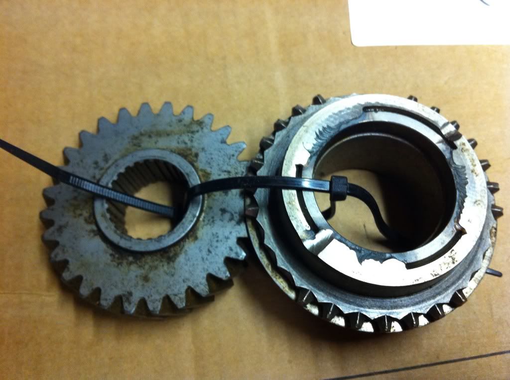

Gearbox-wise a friend is building me an IRS box as a Christmas present. He's 68 and has been building VW & Porsche boxes for 40 years, so I trust his skills. He also donated the (again used) welded 1.04 4th gear. With a 4.375 R&P it will make good use of the 8000rpm of the engine.

Awesome so far, even if I did steal your oil-pump ;). You may want to consider an Accusump with the oil tank mounted so far forward. Mine is mounted low enough that oil-pressure takes 2-3 full seconds to build after the engine has started. With the Accusump, I can pressurize the system before starting and there is no oil light.

I have to say I'm not fully sold on the idea of an Accusump. I completely understand their benefits when it comes to sudden oil loss on a wet-sump system such as under heavy cornering or braking for example when the oil surges away from the pickup pipe, however this shouldn't be an issue with a dry sump. This then leaves it solely as a pre-lube system for startup, and while this gives clear benefits, the added complexity of the valves and joints makes me wonder if it is worth it - all those joints and valves are restrictions and potential leak points. On my WBX I have the oil cooler right at the front and used to have issues with leaks at joints at various points in the hoses - nothing major, just wetness, but enough to annoy. In the end I made 2 hoses that go all the way from engine to cooler and solved all those problems. Of course this is the first time I have used a dry-sump system so don't know how long the pressure will take to build up - if it is too long then I can always retrofit one.

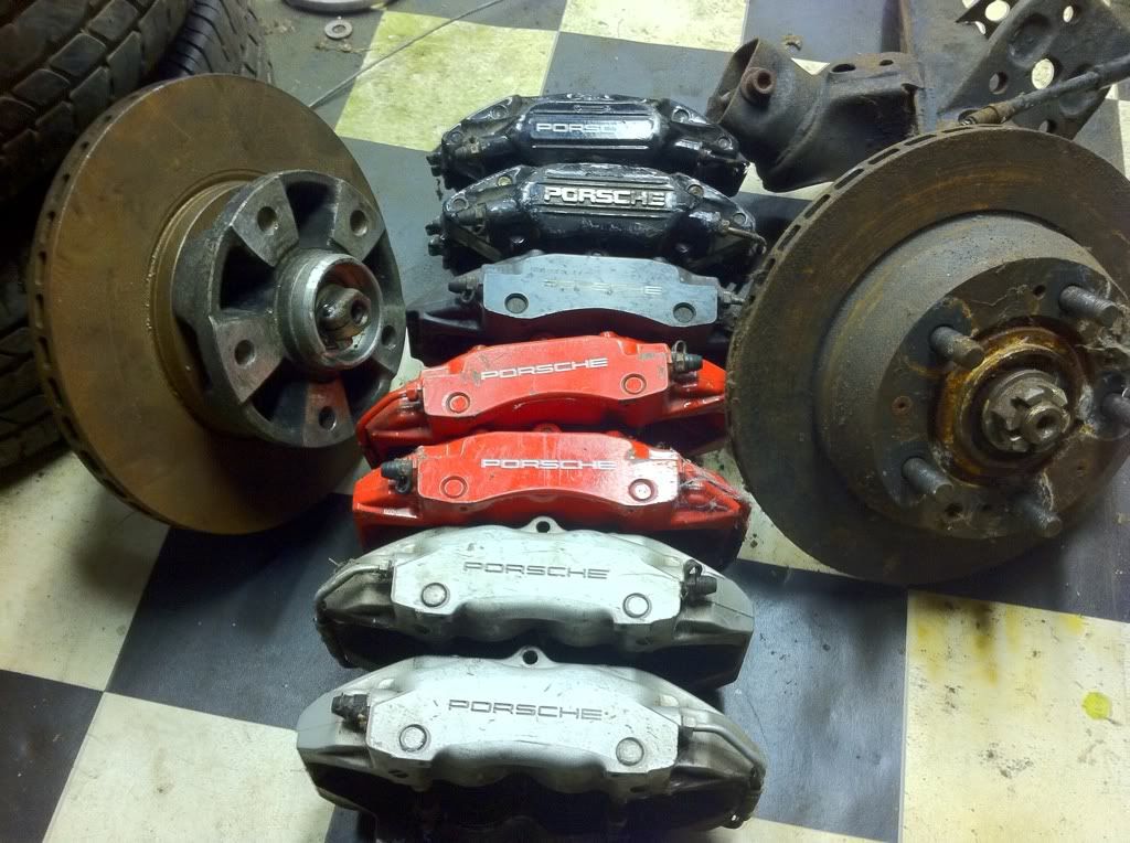

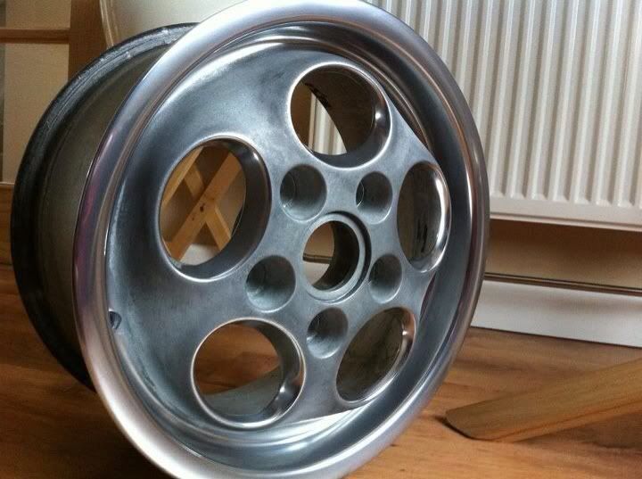

So, before I sign off for tonight, i had a rummage in the garage to see what brake options i could find...
http://i357.photobucket.com/albums/o...6.jpg~original
Now I just have to work out how to fit them inside a set of these...
http://i357.photobucket.com/albums/o...7.jpg~original
Regs state a maximum of a 6x15" wheel, so will be fun getting big calipers & discs inside them :confused:
