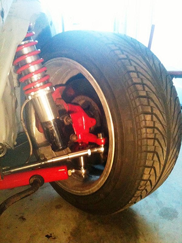

vw1303 February 15th 2013 13:21
Here is a picture installed on the car.
http://i7.photobucket.com/albums/y25...a.jpg~original

Tim February 16th 2013 05:53
Awesome. I have sent you an email.
