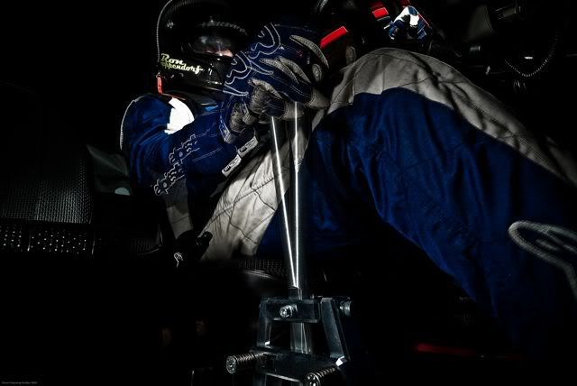

i was thinking on my way home tonight after working on my car. i have a scat drag fast shifter i modified a little to look more like a proper german look item, BUT while its a good shifter for drag racing and shifts from 1st to 2nd then to 3rd really well, down shifting from 3rd down to 2nd seems to be difficult. so i guess thats why its called a "DRAG" fast..lol! so my question being...ill be looking for a good shifter here soon one better suited for more road racing type of shifting, what are you all running and experiences?

To get the Bug-Tech into the reverse gate, you overcome the spring loaded bar. The spring pressure is adjustable so you can make it as easy or a hard as you want to move the bar.

Yes you can. The price for a bug shifter is 299 Euros for standard machine finish or black anodized. Plus 35 Euros for direct shipping to you in the US.
