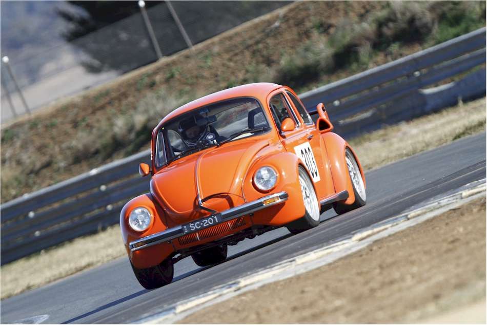

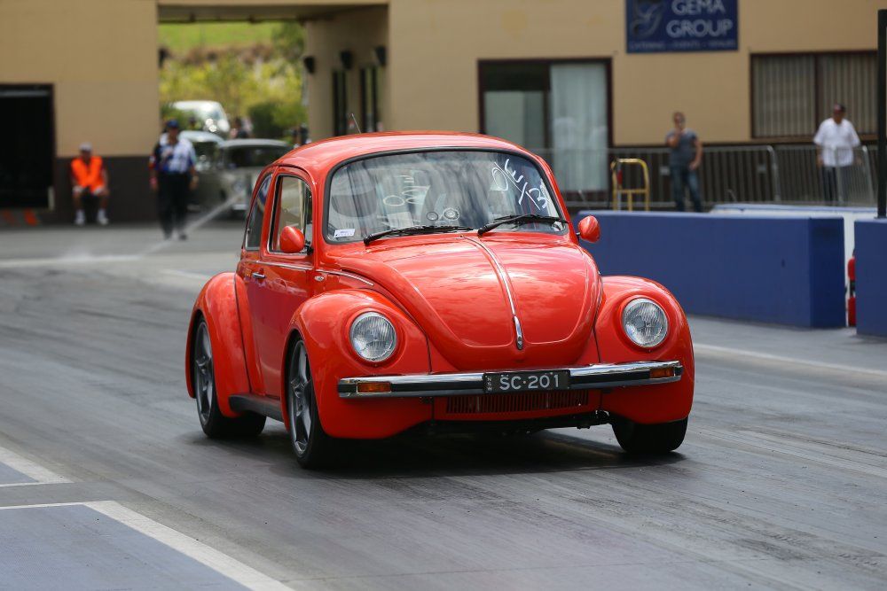

Oval May 22nd 2014 20:26
Lots of factors at play here... Beetles are light (especially in the nose) so only need a small tyre compared to other cars. I give myself a sore neck in motorsport with only 195/205 tyres (semi-slick) and in fact any wider (especially on the front) doesn't heat up sufficiently
spannermanager May 27th 2014 14:37
This is Bang on^^^^^^, :)but of course it's Motorsport where the wrong moves on tyres and brakes show up,, over braking and over trying is easy to do, brake temperature is tyre temperature, especially over the all important first few race laps where a properly set up Beetle can do a lot of damage to embarrass the others, too big on discs or calipers will mean no brake temperature to heat the hub/wheel and tyre core, it's even a problem in winter with the bog stock VW caliper on light cars of say 700 to 800 kg.
One advantage, to a point, of WIDER tyres on light cars, is you can run softer compounds at lower pressures, which on theory make it a quicker car, but again, it comes back to good brake temperature to heat the bigger tyre to best operating temperature.

spannermanager July 16th 2014 15:20
There is case for more rubber on the road, or footprint as it's called, were bigger is better and can offer more grip over a smaller footprint, but,,, there becomes a point where a much smaller tyre working at the proper temperature will be quicker by a significant margin,, the key with a Beetle is getting temperature into the tyre, any temperature is hard won as the tyre loads are comparatively low, brake caliper sizing is also key to core tyre temperature, my race car starts to lose grip as the fuel load, weight, comes off the front axle and tyre temperature drops, I run a soft compound on the right front and even that struggles on right hand tracks, most are. One advantage of wider tyres is a softer compound can be used and it needs less pressure to support itself, given it still needs a correct 'come in' pressure, if it's cold all the time, it's too big, no question.
Various cheats can be used on the front to generate temperature in cold weather, more camber and caster, the two are closely linked, more pressure to load given parts of the tyre, up on the crown for example, or on either shoulder, and then the toe settings.
It's harder to use extreme settings for longer dry Tarmac races, but it's common on shorter events, and you can ignore all this for road cars...
Oval July 23rd 2014 08:08
You can ignore all this for Hill climbs, too.. the car must 'work' from the start line with everything cold...
I've just gone from 15 to 14-inch wheels and saved more than a kilo per corner.. Yay!
