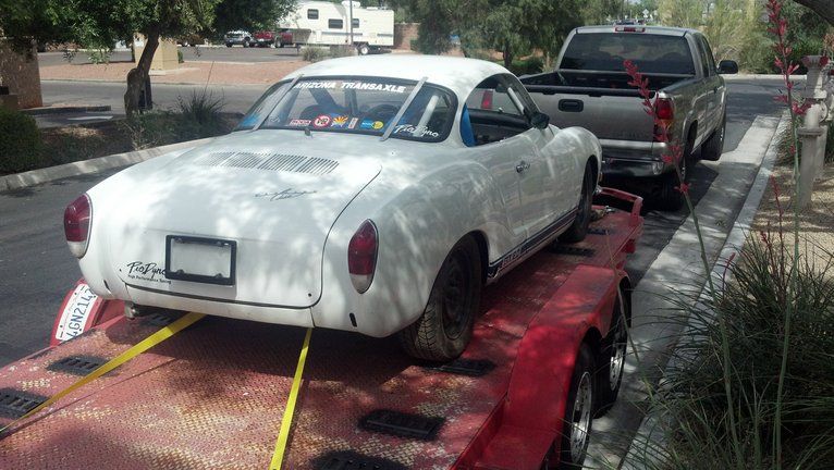

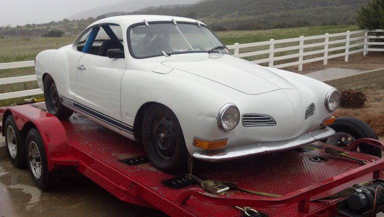

Picked up the Ghia in April of 2012, in a little town about a hour and a half north of Phoenix..... The car had been in VW Trends magazine in August 1997. The PO had been road racing it in Phoenix and Las Vegas and had parked the car in '02 to start racing open wheeled cars, so it hadn't been touched in 10 years. Here's some pictures of the way it was when I brought it home, a 6 hour drive to SoCal.

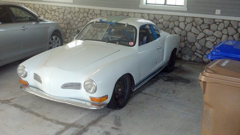

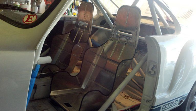

It came with no engine and a 901 Porsche 5 speed trans -- and you can see it was a stripped out race car -- --
I had a big engine laying around and some plans to put it back on the street, as a fast street/track car. Initially, I had plans of doing some land speed record stuff with it and wanted to so a trip to Bonneville and race it on the salt and maybe do some drag racing and some SOLO parking lot/cone racing.. In other words, I wanted the car able to do it all.
Here is the car setting on the ground just after getting it off the trailer....
http://i586.photobucket.com/albums/s...7.jpg~original

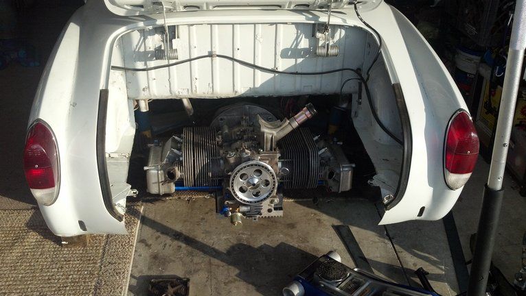

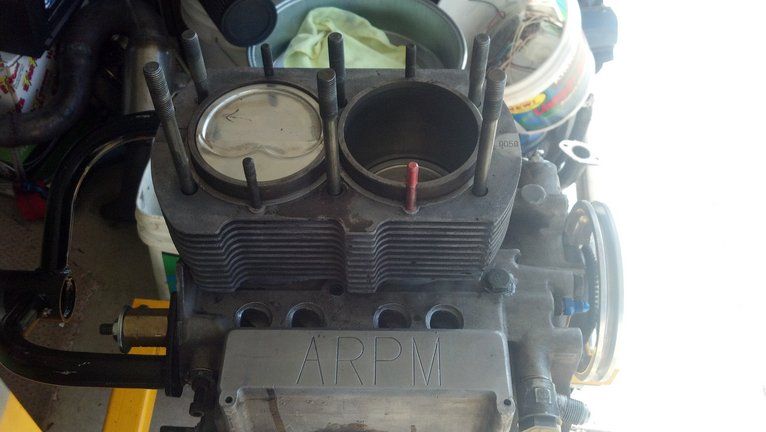

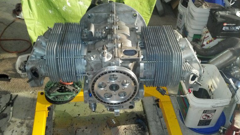

Here is the engine that I had decided that I wanted to put into it..... Notice anything strange

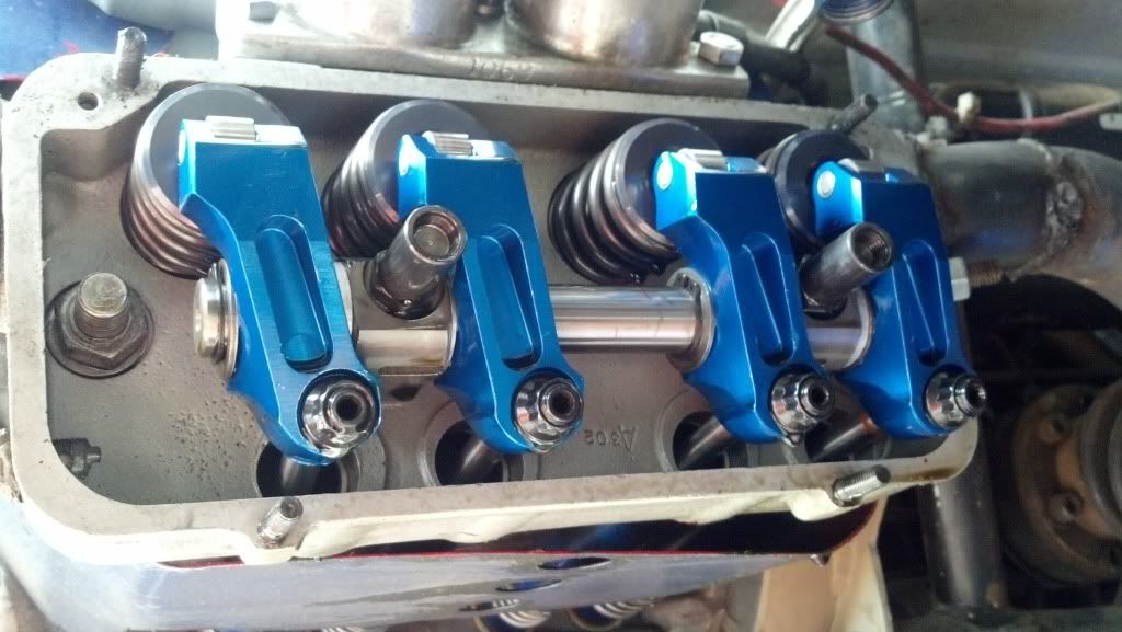

This engine was originally purchased and built in 1987. It is based off a ARPM case and barrels, and has angle port heads. It's displacement is 2989cc's, almost 3 liters. It uses Siamese cylinders to that 4" SBC chevy pistons and rods can be used -- and with a 90mm crank, offset ground to accept the small journal chevy rods. -- -- It also incorporates a drop cam placement of 150 thousandths so that there is no cam interference with the big crank..... ARPM also used a very different head stud setup with 6 main 1/2" studs and 4 smaller studs.... All this means is that if anything breaks, I will be so screwed to replace it LOL
http://i586.photobucket.com/albums/s...4.jpg~original
http://i586.photobucket.com/albums/s...5.jpg~original

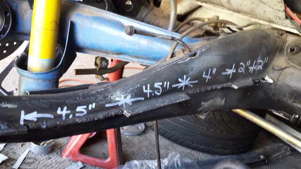

This engine is also 3" wider than stock, so there is a lot of modifications required to get it to fit in any VW
Fiatdude April 9th 2015 10:36
Here is what the engine compartment looked like when I got it.... I bought a box of cutting discs to get ready to put the engine in there -- One positive, is that the car came with a removable rear valance already done......
http://i586.photobucket.com/albums/s...9.jpg~original
Afterwards:::::
http://i586.photobucket.com/albums/s...6.jpg~original

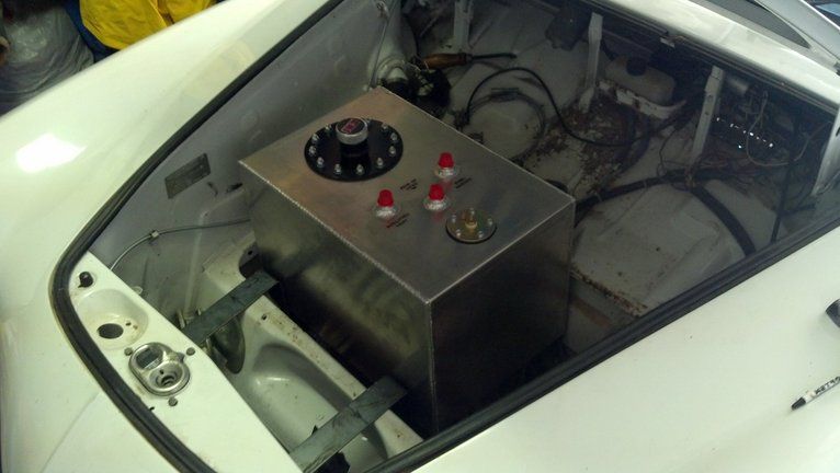

The car came with a stock gas tank, which of course wouldn't do --

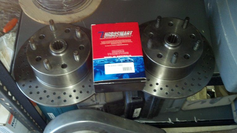

All the brakes on the car proved to be junk so I upgraded to some new ones.

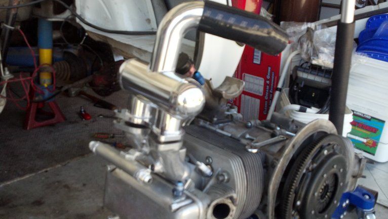

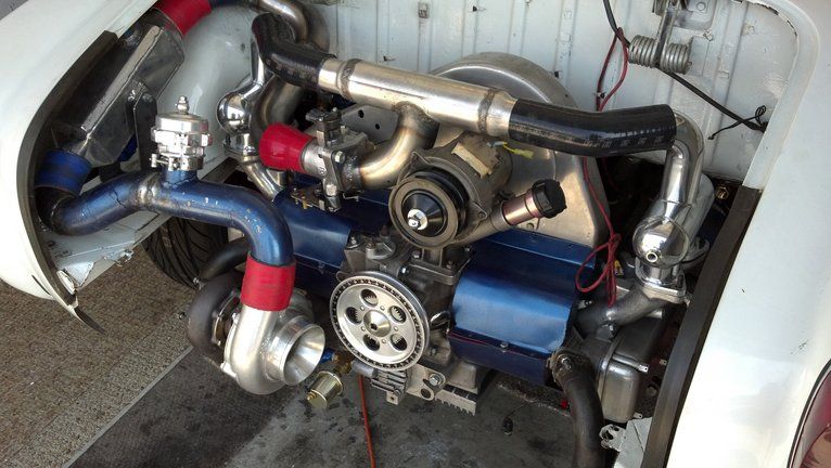

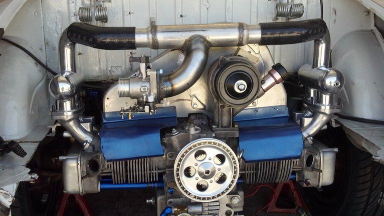

Being everything had to be fabricated, I had Marty Skaggs hand fab me some intakes
And since Marty Runs the US division of TurboSmart, a quick decision was made,,, to turbo the 2989 ... I'm still giggling about that..........
http://i586.photobucket.com/albums/s...8.jpg~original
So I, the worlds worst welder, decided to start fab-ing up the intake and exhaust,,,, You can't buy any of this chit anyway..... Here is some early attempts -- --
http://i586.photobucket.com/albums/s...0.jpg~original

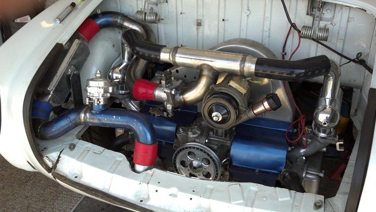

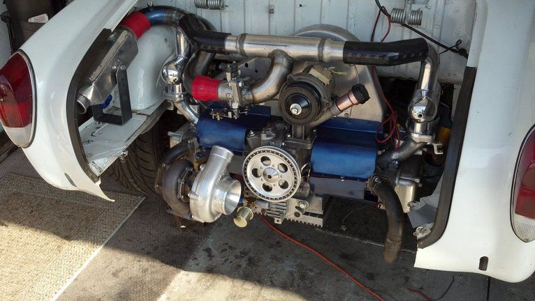

Fiatdude April 9th 2015 10:57
The exhaust and turbo are fab'd -- -- OK, OK bubble gumed together
http://i586.photobucket.com/albums/s...1.jpg~original

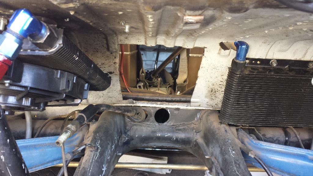

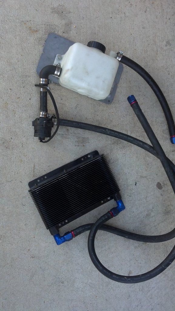

of course it needed an intercooler -- so bought a water/air one off ebay -- a few more bends and poof, chit has occurred LOL
Here's the rest of the intercooler system -- a tank and pump (mounted behind passenger seat) and a small radiator (oil cooler) that I mounted under the car --

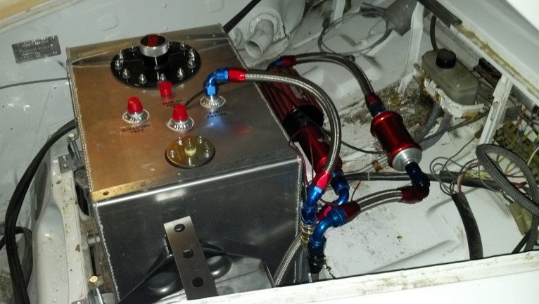

Fiatdude April 9th 2015 10:59
The Battery, Fuel Tank and fuel pump getting their initial lay out, and lines ran

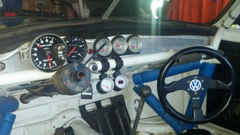

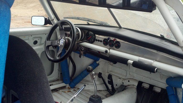

The Dash gets a little redo

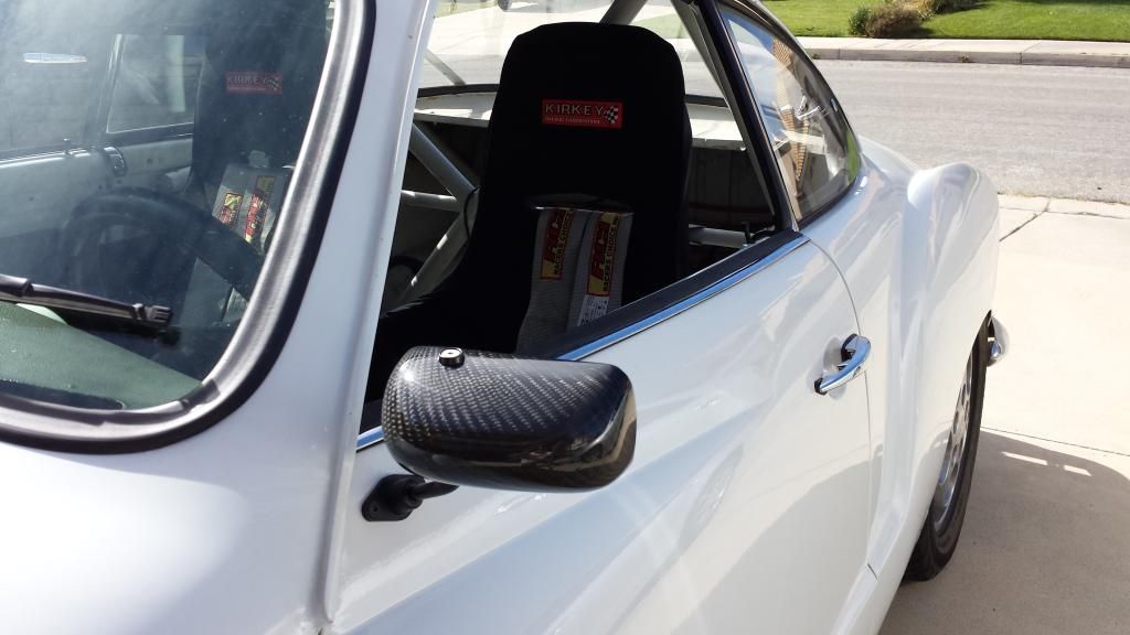

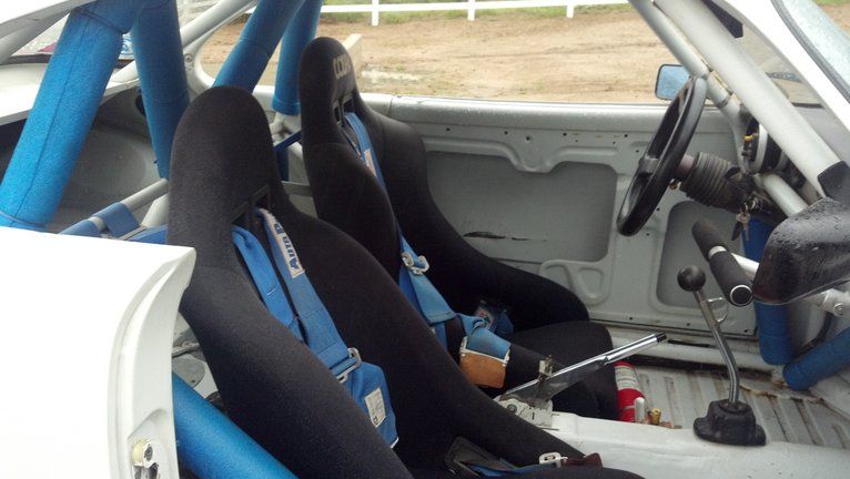

Those itty-bitty small-ass seats that were in the car, got pulled and given away, and were upgraded to some Kirky seats

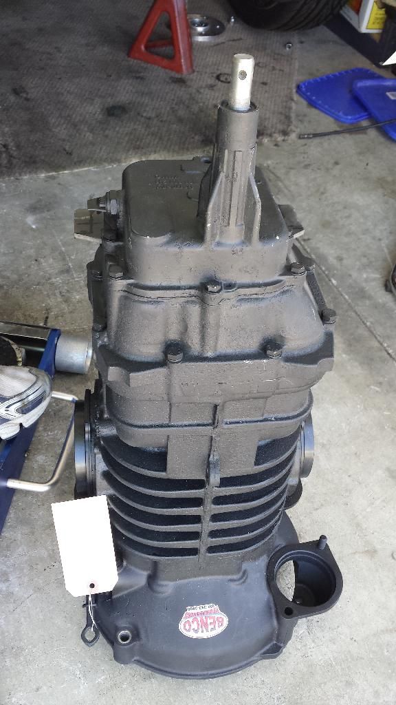

So suddenly I get the new 091 Bus trans -- --
http://i586.photobucket.com/albums/s...p.jpg~original
of course, it is nothing like the 901 that was in there and the old rear of the car has to be redone to fit this monster in there

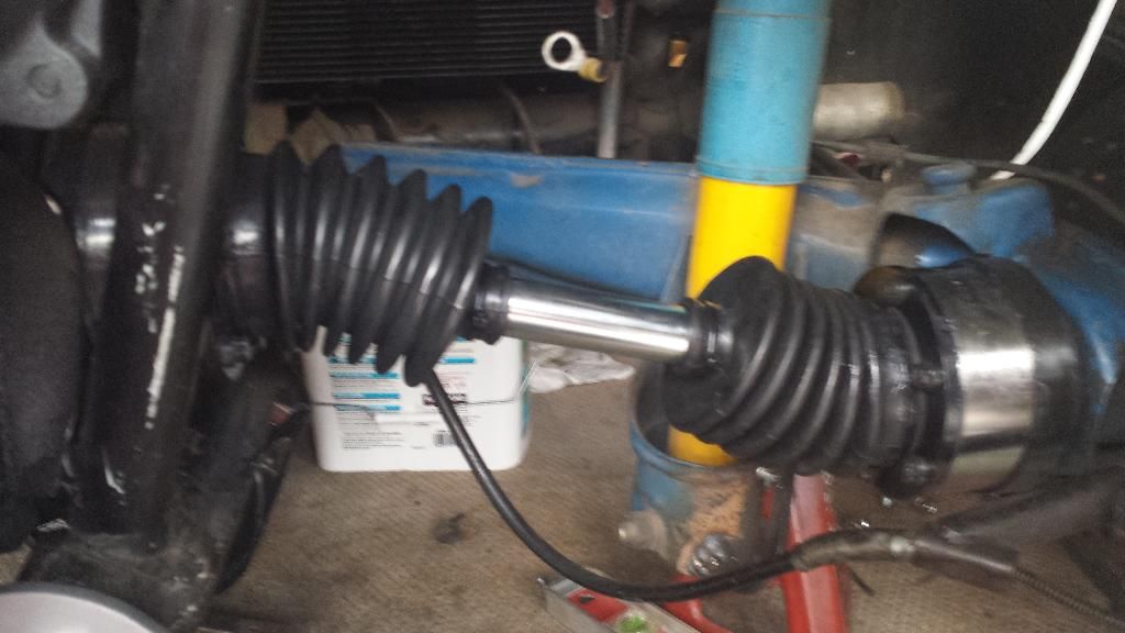

Some new 930 CV's and axles and stubs are in order

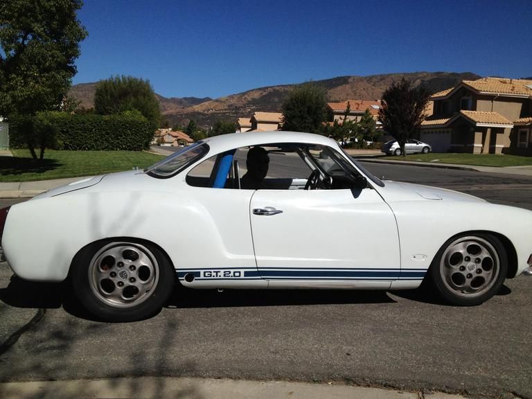

I went out and did some parking lot stuff and found that without a posi in the car, it would just burn the inside tire going around any corner, so the motor and trans had to come out again to get a new LSD put in....
and the car got cleaned up and a few things done to it

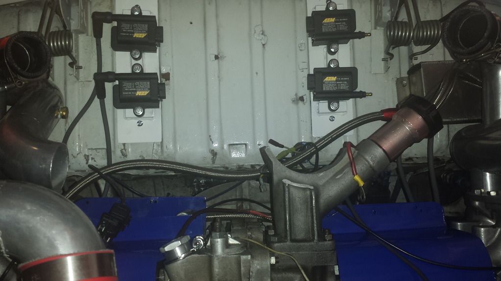

It was while on the dyno I started having issues with my Electromotive EFI system -- so currently the car is all tore apart (AGAIN) and all the electrical is getting redone as I put in a AEM EMS4 system
http://i586.photobucket.com/albums/s...z.jpg~original
http://i586.photobucket.com/albums/s...f.jpg~original
http://i586.photobucket.com/albums/s...l.jpg~original
