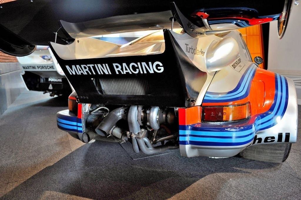

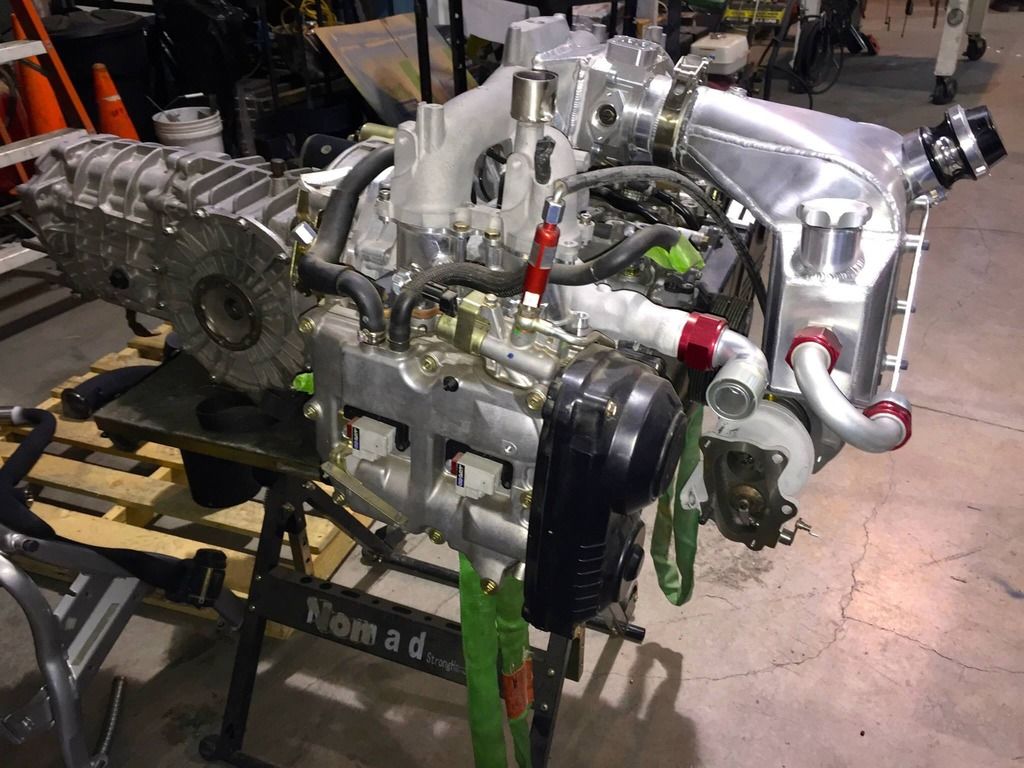

the original engine was going to be a 450 + hp Subaru STi with a 930 transmission with the car built for a Pikes Peak run. After being put into the unlimited class, I decided to use the engine transmission in a better chassis if I am going to run Pikes. So I am putting a 2.3L T4 that I already had into it. Notice the chassis and torsion tube were cut to accept the 930. The Suby engine design was patterned by the 1973 RSR Turbo shown here...
http://i1119.photobucket.com/albums/....jpeg~original
http://i1119.photobucket.com/albums/...z.jpg~original

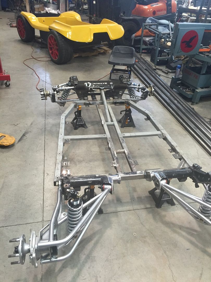

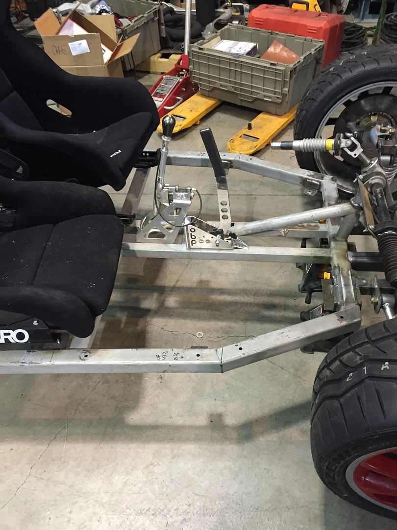

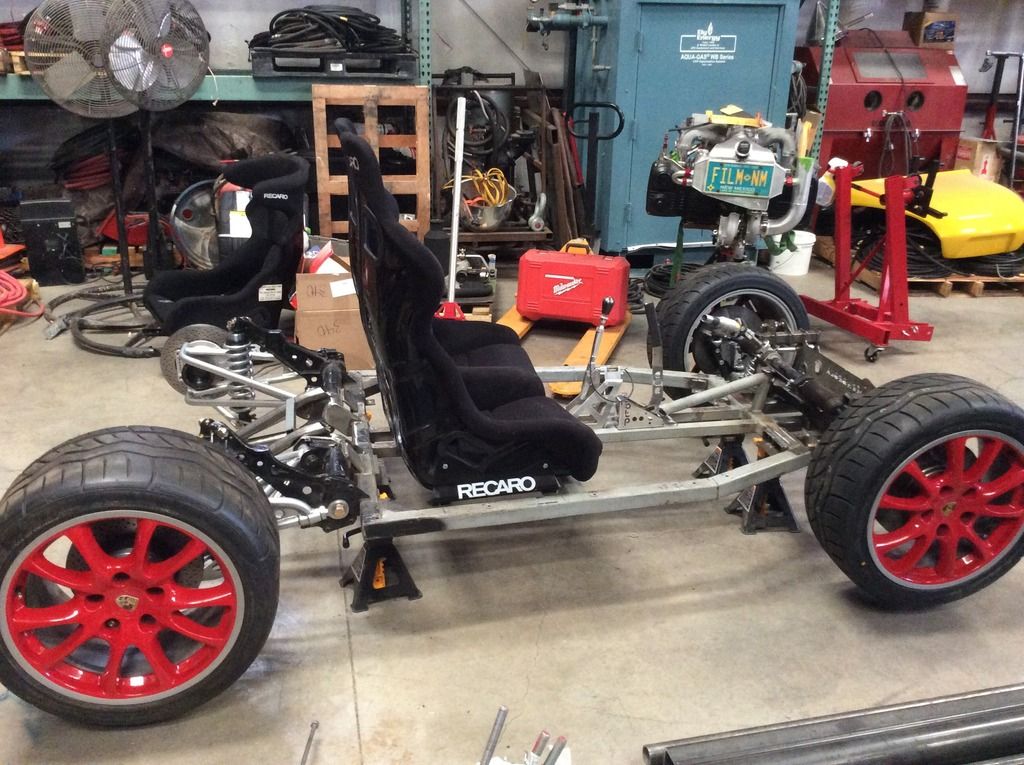

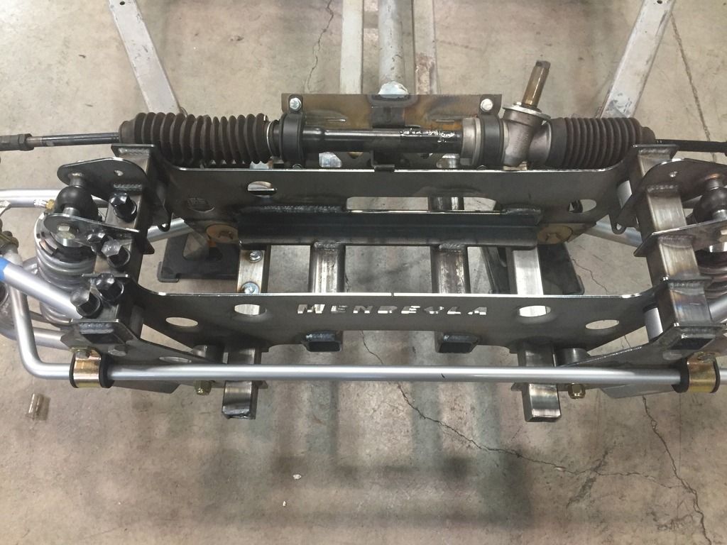

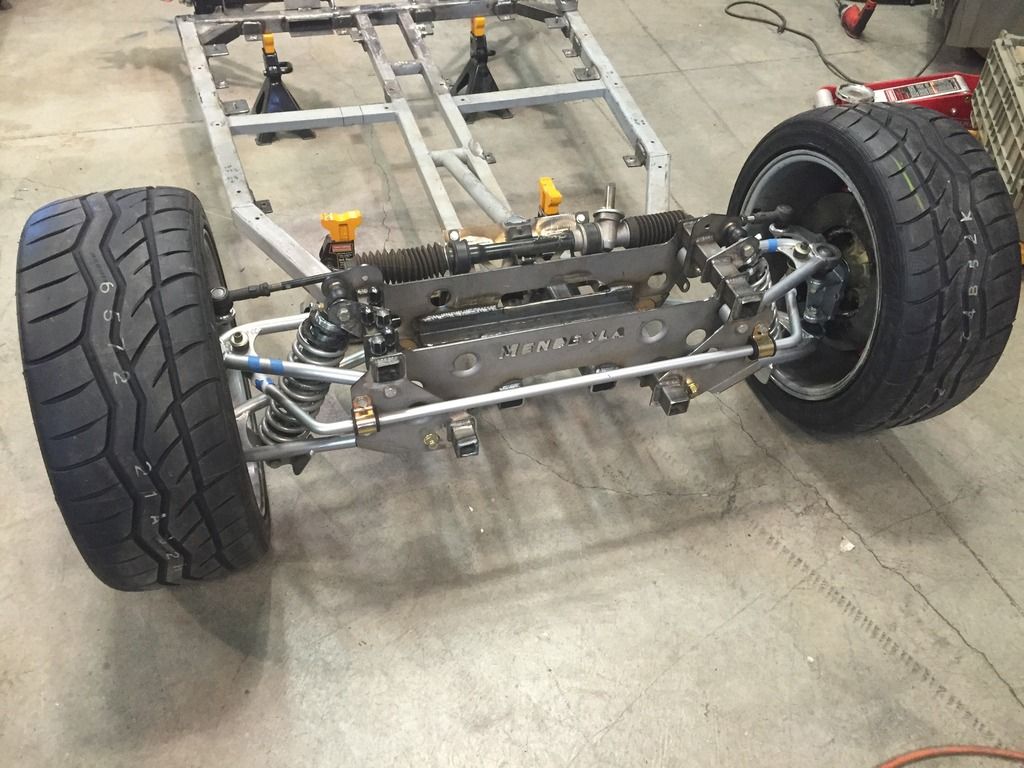

The chassis was based upon a Berrian frame with a Mendeola suspension grafted on. Looking forward to seeing if it performs up to the level it is promoted. Some more chassis shots here...
http://i1119.photobucket.com/albums/...o.jpg~original
http://i1119.photobucket.com/albums/...n.jpg~original

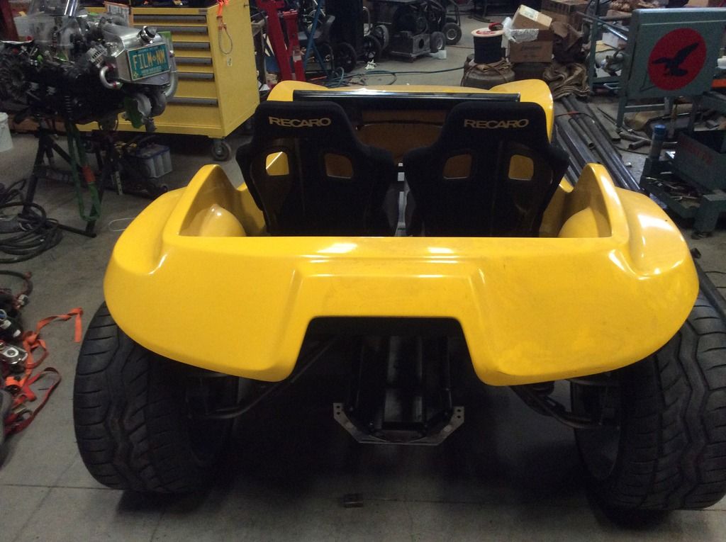

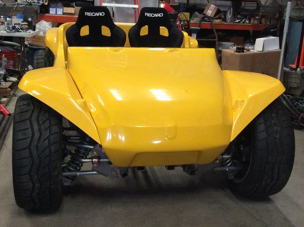

Front shots...
http://i1119.photobucket.com/albums/...e.jpg~original
SuperRSi December 3rd 2015 21:56
another...
