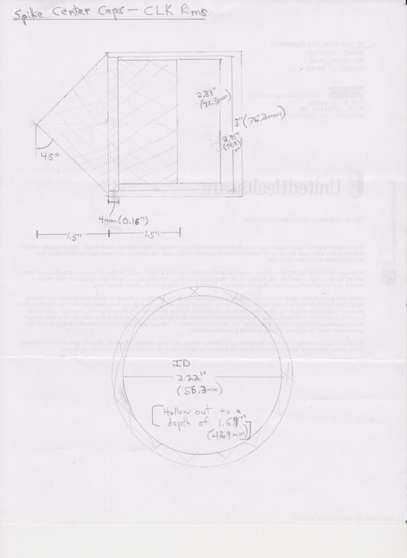

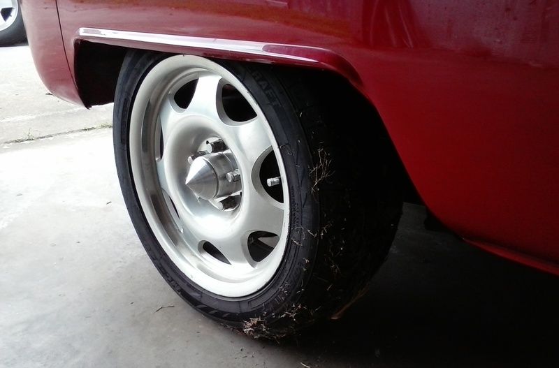

Here's the measurements for duplicating this. I used 3" aluminum 6061 round rod. There's probably other rims out there with a 75mm hub that this would be a similar application to though.
http://i52.photobucket.com/albums/g3....jpeg~original
http://i52.photobucket.com/albums/g3...m.jpg~original
