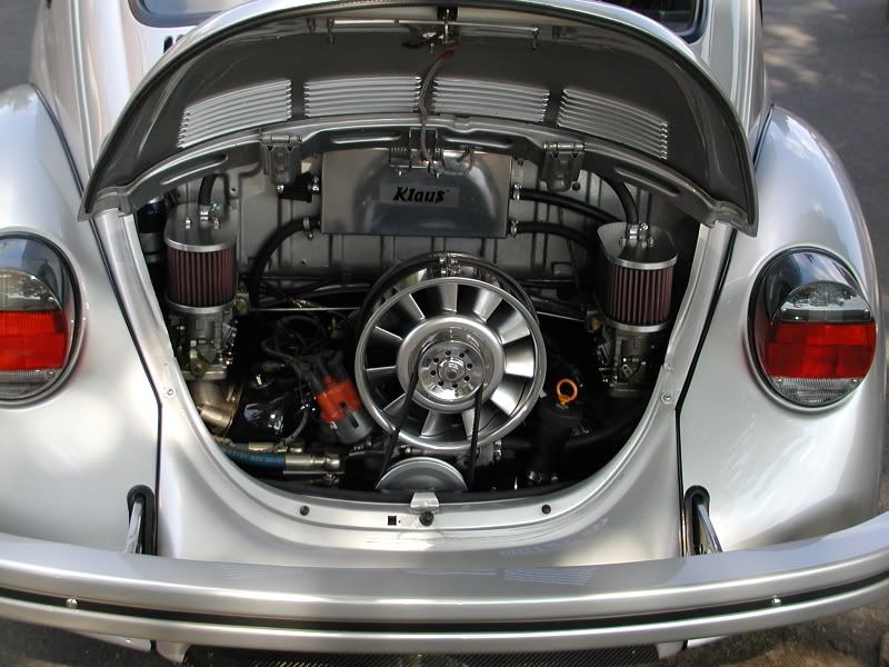

What types of heads and camshaft do you use? I want a compression ratio of 9.8:1 is it possible with this setup? What are you hp figures?
Thanks, verrrry nice ride you've got.
dirk.Gysbrechts December 15th 2005 05:42
dirk.gysbrechts ride
Heads are 041 with 40mm inlet and 32 mm outlet ( is too small) better is with 40mm and 35 mm. Camshaft is 316° from BAS Ahnendorp germany.

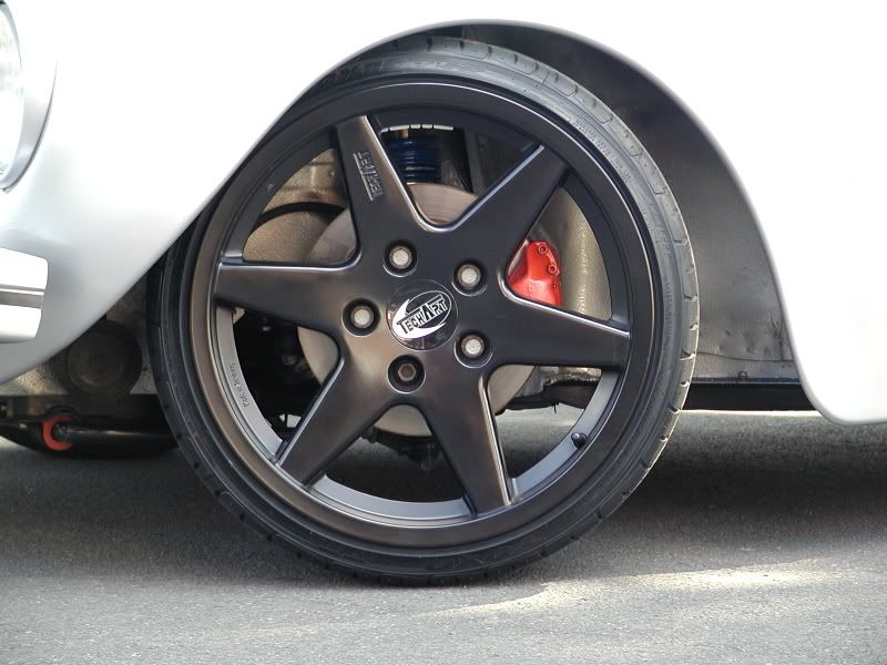

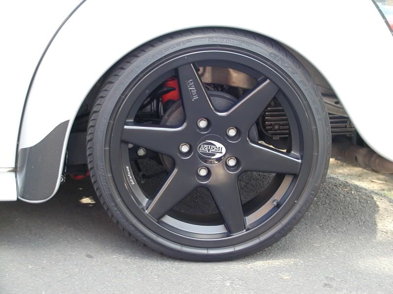

I have planned an update...because meanwhile i have a type 4 engine, Remmele suspension,Kerscher brakes and 18" Tech Art rimms...

Nice black rims!!

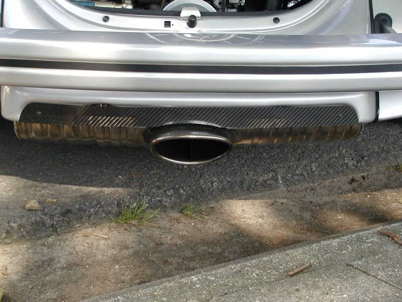

Did you modify the boxter muffler? It looks like you cut the muffler itself, did you remove the baffles. I installed the same muffler on my 2.0L. on a Transporter, I am asking because of exhaust restriction and if the muffler is hindering performance at all.
dirk.Gysbrechts October 23rd 2006 12:08
ride
Hello, i have shortened the exhaust on each side for 10 cm. I don't have made changes to the inside of the Muffler.
