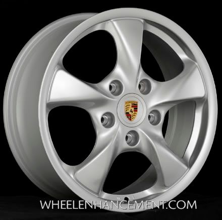

Hi im into the german look with big wheels but unsure how to go by doing the whole gl look with suspension and wheel and tires so far ive researched and I drive a 74 super every thing is stock as far as suspension goes I live in the us so I really only want to buy things from the states I know that a 74 super has to have 55mm ofset wheels to keep it under the fender if im wronge tell me

First off if you only want to buy from the USA you will need to
contact Topline Autoparts in California... they have everything
you need to put wide Porsche wheels on your Super.
You will need a set of MAXX struts (these are narrower then stock)
you will need to have your drums redrilled for the Porsche 5 x 130 pattern
or you will have to buy drums that already have that pattern.
You will need 14mm press in studs for your drums.
In the front you should not need any spacers seeing as you have a 74
In the rear, you will need to run a minimum of a 10mm spacer if you
are running drums in the rear and you will need to grind the top of the
shock tower in the rear a little bit so that the wheel doesnt rub...
I had those boxster wheels on my 71 super and had to run a 10mm spacer
in the front and the rear, but the 71 is 10mm narrower in the front per side.

vujade is right on the money with the recommendations. there are other ways to do it, but they would be custom on your part. just depends if you want to do the work or just buy the parts and install.
check the VKG site for pics of his car with those rims and mine with the same. i am running 8.5ET48 on the rear though.

do some searches on here for more info, but 55mm is not your only option. it is one of the best if you are going to stay with stock fenders, but not the only. and remember that offset is relative to the width of the rim. a 55mm offset on a 7" is going to have a much different position that a ET55 on a 8" rim.
$2000 for wheels????? no, no, no. look around. if you have the time, you can find a much better deal. those rims should be no more than $1000-1200 tops. i got a set of 4-8.5" for $425. sold 2 of them for $400 and bought 2-7" at $600. check Wheel Enhancement as a minimum. not the best deals, but good quality and occasionally the special clearance deal. ebay is a great source. PelicanParts.com another.
