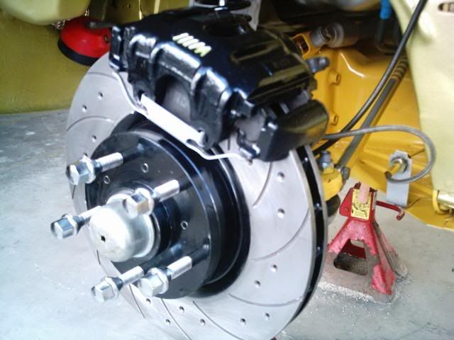

I've put BMW M3 stuff on mine.........
not easy but worth the effort ('Had to use BMW discs as my wheels are BMW stud pattern and I aint changing them!)
http://img.photobucket.com/albums/v7...1.jpg~original
http://img.photobucket.com/albums/v7...3.jpg~original
http://img.photobucket.com/albums/v7...2.jpg~original
I'm using a Porsche 944 split master cylinder with these as the pedal travel with the stock Bug one was sooooooooooooooooo long!!!
Much much better now.
'Any questions feel free to ask.
Al B

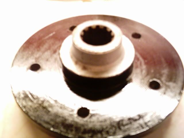

Al B March 27th 2005 06:56
Originally Posted by rip
Al B
how did you attach the rotors? did you use porsche hubs?
thanks
rip
Nope, I made my own hubs up out of the bug discs and drums. (they were blank THICK items that were already drilled to BMW stud pattern)
The rear drum was turned down so that the disc fitted over it, 'Top Hat' style. Then bolted to the hub with countersunk screws and a bottle of threadlock!
heres the rear hub,
http://img.photobucket.com/albums/v7...4.jpg~original
With the fronts I again turned down the bug discs to make a similar hub, but instead of fixing the disc ofvr the top I attatched it to the back again using the 5 screw method, you can see it better in the pic...
