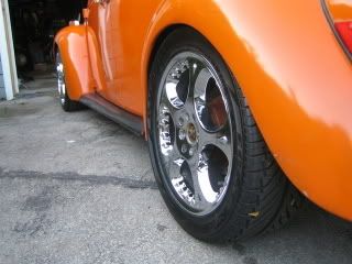

Hi just curious what would be the biggest tire you could get under a stock fender.........oops forgot to mention 73 super beetle..
Barry
petevw August 5th 2005 04:16
'72 super
235/45/17 under stock fenders:
carolinaslim August 5th 2005 07:45
Dang thanks petevw. Nice pictures and dang nice 72. What size wheels are they and are they on stock drums. I guess 17's are the biggest you can go under the stock fenders. Are you using spacers or adapters on the drum.
Thanks Barry
Steve C August 5th 2005 08:32
This bug runs 17x7 fronts and 8.5 on the rear.

petevw August 6th 2005 01:38
Thanks Barry
The rims are 17x7 ET42. They have a universal 4 bolt pattern. 4x100 and 4x112. The Super has 4 wheel crossdrilled discs with no adapters. The discs were drilled/studded at 4x100 by Lanner at VDubCustoms.
I'd get in touch with Lanner, for all your needs. He has all the info to how to make it all work.
