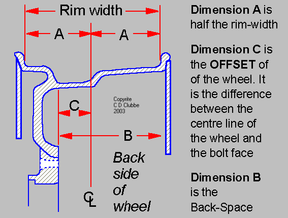

PJL54Oval November 27th 2005 12:56
Just an FYI since I just found this out. OFFSET is often referred to as ET which stands for EinpressTieffe in German. Here is a good diagram
http://i21.photobucket.com/albums/b2...s.gif~original

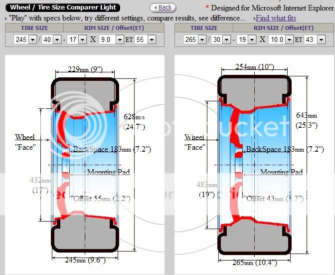

petevw October 19th 2007 19:53
here is an awesome wheel/tire calculator
[click on pic]
http://uploader.meinwirt.com/files/1...re%20chart.JPG
