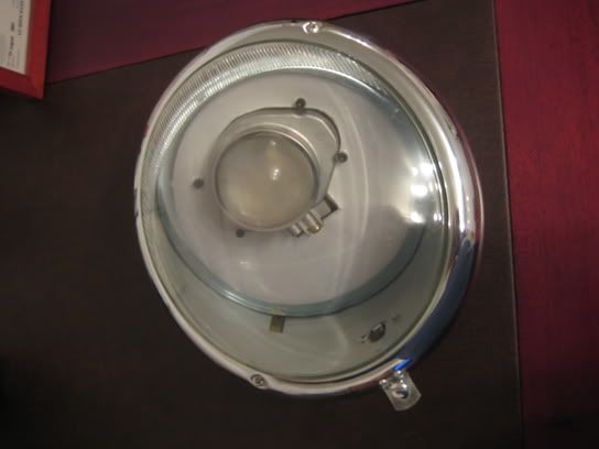

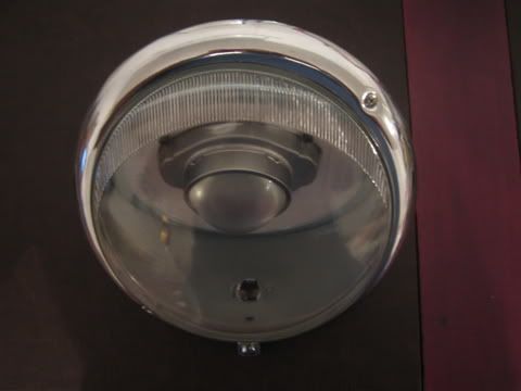

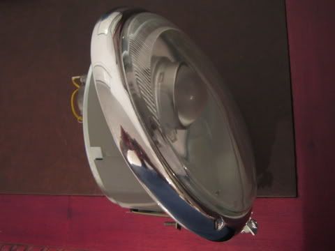

I've been working on and off over the past year on this template for a HID projector in a early housing.
After alot of reworking, trial and error, i have something. Need to close the gap around the housing, use something other than capscrews to fasten it, and decide how to finish the plate. I haven't tried putting it in the fender yet.
Plate is Lexan, and the Bixenon projector is from a FX45.
here's some pics:
Have already started to make another pair, to address the above issues.

Looks great Rich! I tried making a bezel to go overtop, like what you've done, but it looked akward in the oval shape.
These are Bi-Xenons too.
I like the carbon idea, then i'd have to paint the inside of the housing black or the body colour (Seal Grey). Maybe use that carbon tape crap, but it may melt and peel off.
