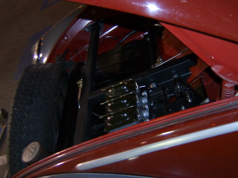

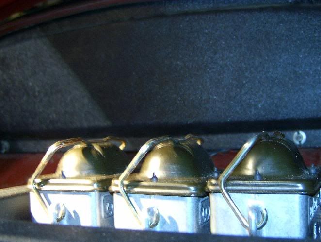

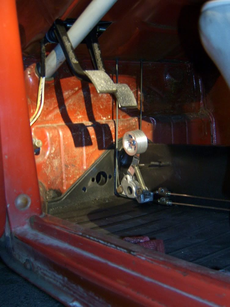

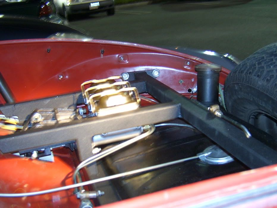

rip January 16th 2006 15:20
volksdent
I resently did a wilwood triple firewall setup seen here
http://i33.photobucket.com/albums/d5...2.jpg~original
http://i33.photobucket.com/albums/d5...1.jpg~original
http://i33.photobucket.com/albums/d5...9.jpg~original
http://i33.photobucket.com/albums/d5...3.jpg~original
2nd gen Rx7 4 pots up front
single piston ford tarus sliders in the back
using 3/4 front mc
and 7/8 rear mc
also using 7/8 clutch mc
people say to use a 3/4 clutch mc but it was still a bit of movment I like the 7/8" better
oh and btw the last pic was without the pedals adjusted.

rip January 16th 2006 18:36
actually with the new seats in the pedals arn't that bad, i'm pretty tall with 12.5 size shoe.
but I was toying with the idea of simply extending the pedal surface a little bit lower. this is easier than the false floor. Not to mention ever try to get into a bug with a false floor? not to easy for taller guys. the steering wheel hits the legs when getting in.
But please keep us posted I was thinking of getting the reverse swing wilwood pedals but thought it would interfer with the steering column too much, that they would hit too low on the foot, and push the pedals too close to the driver. not to mention it seems like you have to build a semi cage to hold them. if you already got a cage no problem, but needless to say a few little things were discouraging me with that setup.
The problem with the firewall setup is like you mentioned the hieght. but if you build new pedals and just use the mount for the mc. you can increase the pedal ratio and drop them further. just gotta rethink the mc size then. but its all fun.
