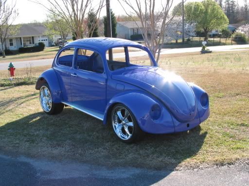

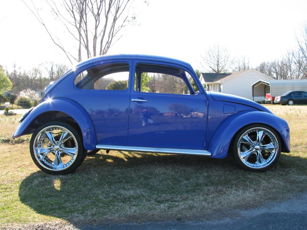

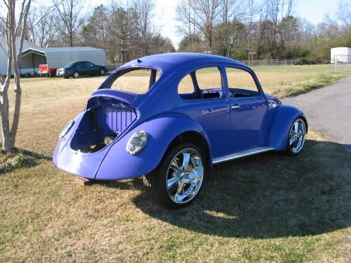

tell me what you think. im building this vw for someone. theres no engine or trans yet. its different. this is exactly what this guy is looking for and hes paying. i mean im a germanlook guy no doubt about it.

Looks good... but those wheels are a little rediculus! i guess every one has there own taste, i just dont like the tast of bling ;) what size tire is that anyways? a 30 series? lol
Will be intersting to see it done, what motor/trans is going into it?

I'm assuming once the drivetrain is in it won't be that raked with its hind end sticking way up. Otherwise, I like it ... except for the part that I'm about thirty years too old to look right with it. ;)

it's nice ,don't fancy cleaning the wheels though ha ha

I think it looks beautiful, its a great color. The wheels aren't my taste, but the offset and the stance will be great. What was done to the front suspension to get those wheels to fit so nicely?

the fronts are 215x35x18 the rears are 255x40x20 im the same way with the bling the engine will probably be a type 1 2276 kinda mild almost a daily driver i talked to chico at reynolds last weekend he seems to think around 125 - 130 hp. with a type 1 gear box
the front is a cb adjustable beam with 2" dropped spindles. hopefully the rear will sit almost the same when the engine/trans is mounted i pretty sure i already know what the car's name will be anyone wanna guess?

The front end isn't narrowed at all, just dropped spindles and beam?
no narrowed beam just regular stuff
Like the body-work, (Can see that many hours of prep went into it) The bling....not so much. I see more and more of the over-polished rims on Bugs and it does not work well. But then if we had the same taste, our cars will all look the same!
lots of body work some said they had taken better cars that what this one was to the junkyard. im the same way with chrome but im sure the hot rod crowd will love this car. b4 its over this car will have lots more chrome. this guy loves my car but wanted something different.i think he got it
