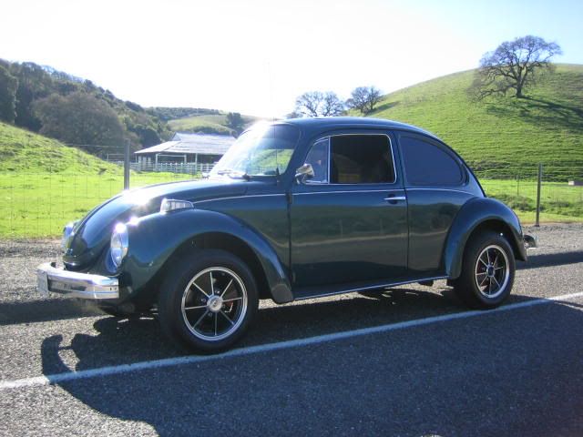

I guess a lot off tes fitting would have to be done. these wheels are off of a 2003 acura tl there 5 spoke wheels and would look a little diffrent that the porsche look. the weels say they have the 55 mm offset so i would figure they would fit. i guess i would have to find some and test fit them up to the car. I would have the paint striped and paint them a gunmetal color. how would they look.
http://img.photobucket.com/albums/v3...U.jpg~original
http://img.photobucket.com/albums/v3...8.jpg~original

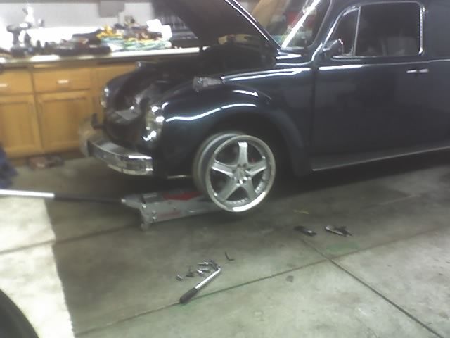

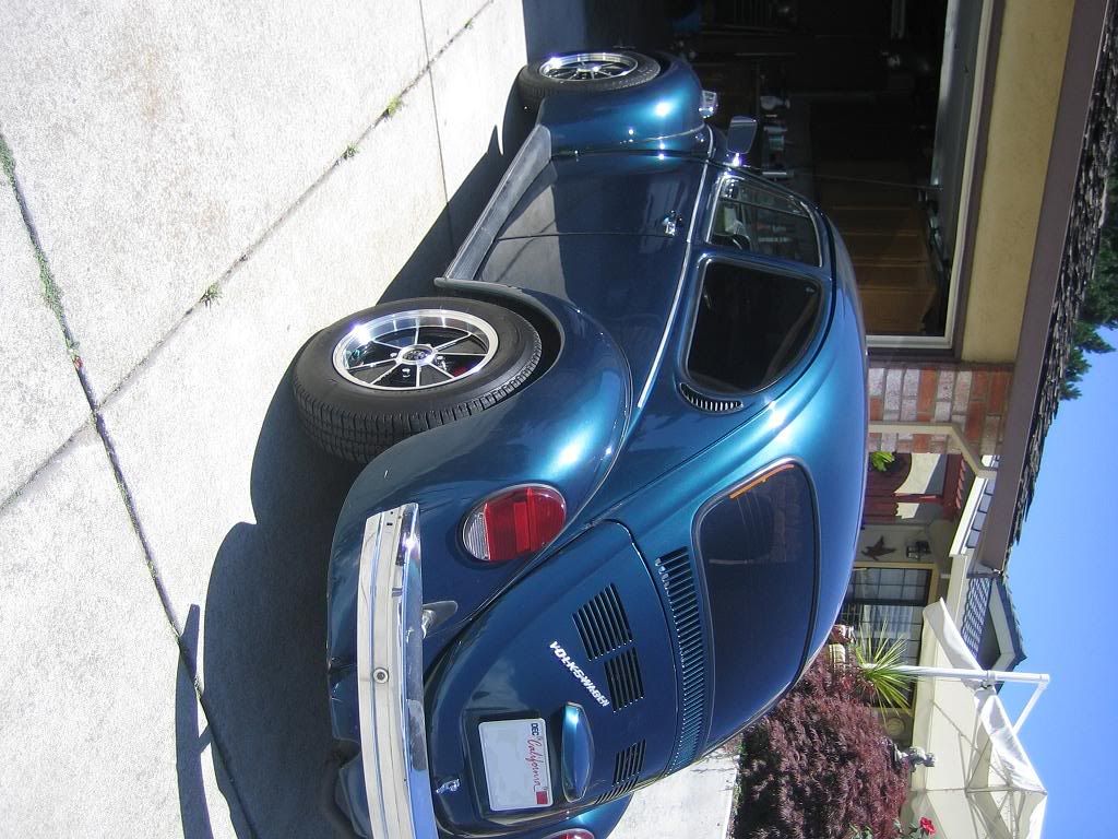

well now the car is lowerd. I finally got my lowering kit from topline. got new pics just need the wheels
http://img.photobucket.com/albums/v3...k.jpg~original
http://img.photobucket.com/albums/v3...1.jpg~original

did you get the new bolt pattern put on or is the wheel just hanging on in the 2nd picture?
also what city are you in ? i am in so cal too.

I currently have the brms on the car and I personally dont want them because I guess they clear coat the black paint and its flacking on the rear rims only. the 17's dont fit they have a 42 offset anyone have a idea if 50 offset would clear instead of toplines recomended 55. the 42 lines up with the fender in front so I believe 50 would clear. The rotors are still stock no drilling yet done still deciding if i should go wider fenders or stay stock and hunt down 55 offset wheels. any suggestions. I live in northern california
