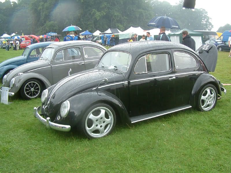

I run 205/40/17's and 215/45/17's on 7" wide cups...
[IMG]http://i151.photobucket.com/albums/s...6.jpg~original~original[/IMG]
alanhughes February 16th 2007 07:16
adam,
what brake and suspension set up are you running? discs or drums? spacers etc?
cheers
Adam Lee February 16th 2007 09:33
Originally Posted by alanhughes (Post 57162)
adam,
cheers
The car runs standard link pin and swing axel suspension, front brakes consist of CB spindles with post 68 beetle standard-ish discs and calipers and the rear s sit on long axels and are a mixture of Porsche 914 discs with Golf GTI calipers. No spacers were needed. The wheels are genuine with an ET55 offset. Hope this helps!
