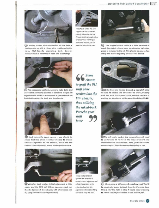

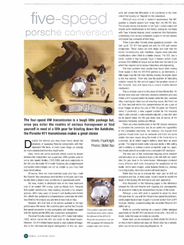

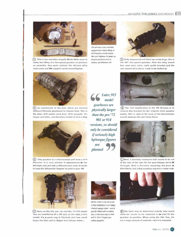

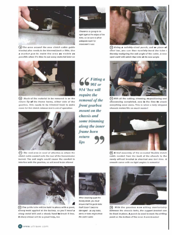

Bug@5speed Porsche 5 Speed Conversion Article
Gents,
Please let me know if this is legible. Trying to share some of our info. If you would like a high resolution pdf please PM or email me.

wrenchnride247 February 20th 2007 22:41
Hey, I think I've seen this somewhere :rolleyes: . This should help others make the decision to get 5th gear ;) easier... before you ask... my conversion is not complete (dealing with clutch linkage) will start back hopefully by April.
Zman February 26th 2007 14:53
Me too! I am almost finished with my conversion. Everything is fitted except the hydralic clutch slave cylinder and working on two shifters designs, one that works with Martin's 5 speed shifter and one that works with other shifters. Tech article coming soon, once I have the different shift models worked out and which design shifts the best.
Very Nicely done Kit everyone! Very high Quality. Doesn't get much easier to turn your ride into a 5 speed. :D
