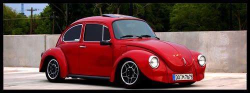

Alright well I got a little away from the GL look with my previous project, the reason being was my daily was totalled and I need a driver ASAP. I like the car and all, but am not happy with handeling...or speed. 1600 DP Here it is as it rides now.
http://i47.photobucket.com/albums/f1...6.jpg~original
