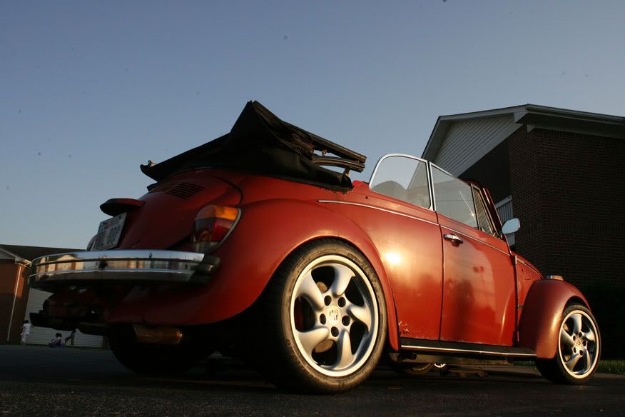

i'm running the porsche 944 setup, which means 11.5" rotors on all fours corners. they're cheaper because you can pull them from a junkyard, and you wind up with easily upgradeable parts. my wheels are porsche boxster s wheels, mostly because the porsche bolt pattern is an odd one and pretty much requires porsche wheels. you're going to find that you need some pretty big offsets, meaning upwards of 50mm to fit most wheels to your super. my 17x7" et55 205/40/17 fronts are what's recommended for the front, but my 17x8.5" et50 245/40/17 rears will require wider rear fenders. there aren't a ton of bugs with 18" wheels, mostly because it's a pain in the butt to fit them under stock fenders.

davetaylor May 16th 2007 21:39
here's what i'm working with. i'm going slower than i'd like because i'm poor. by the way, i wanted a triple black but i couldn't find a good one. i just sent a triple black parts car to the crusher because it was too far gone.

those wheels look almost smaller than stock, but man there's nothing better than a triple black bug convertible. that will be sweet with the mods you're wanting to do.
