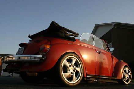

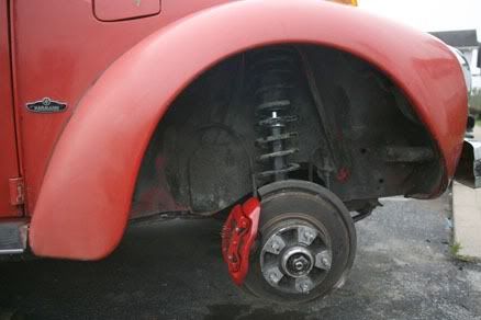

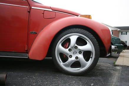

davetaylor June 14th 2007 14:33
my convertible is still in progress, and it's going to be stock except the motor, wheels and brakes, so my ideas are few. i already have the brakes and wheels, but no motor yet. i might have a lead on an ej22t, but i was just told there was a legacy "with turbo on the back" in a local yard with a clean motor so we'll see if that pans out. i have many ideas, but i can't implement them since i'm a poor college student.

Bug@5speed(US) June 14th 2007 15:48
Dave,
LOL, I remember those times, hell, I am just a bit older but still poor ;)
Its always nice to see verts getting redone. If you have some pics would be interested in seeing..

davetaylor June 14th 2007 16:11
those pics are the only ones worth looking at so far. the stock engine is sad, and the interior looks like wild boars lived in it. it sat for 13 years at a body shop and i drove it once and started taking stuff apart, so it might not move again for another 13 years! i still have to buy longer brake lines and such before it'll move again, but maybe it won't be too long.
