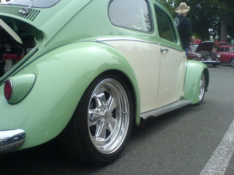

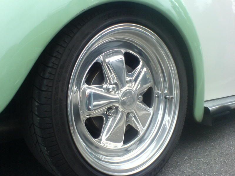

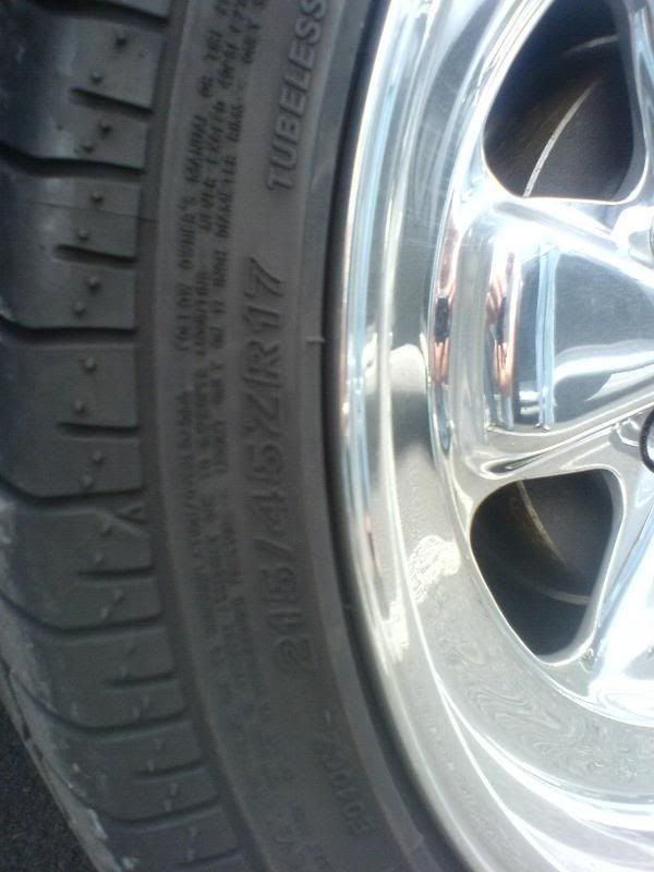

At a local car show I saw a set of 17" Fuchs on a bug (shown below). Are these actual porsche items, or did the owner have a Fuch center mounted to a 17" rim?

ricola August 25th 2007 16:59
I've seen split rims made using 16" fuchs centres but never what look like one piece like those..

The Lindsey's are a 16x6" center that is cut out and welded/fastened to a BBS outer. You must supply core wheels. The Rota's are a cast wheel and they only come in 2 sizes as of right now. The advantage of the Lindsey's are that they're forged and you can get them in custom offsets. The disadvantage is price, as they are expensive.
