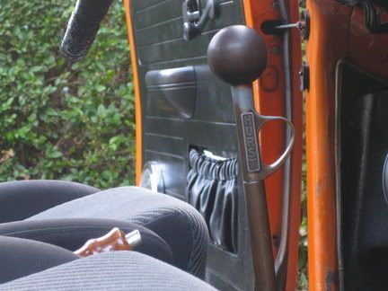

I have run the empi trigger style before and will again, the style with the round ball and lift up ring. I think the main reason I like it is that it is sprung to 3rd/4th. Berg and CSP are certainly tighter but I definitely prefer the empi.
Rich
vujade September 8th 2007 09:29
Rich
isnt the Empi trigger just a copy of the Original Hurst Trigger shifter?
I had an OG hurst shifter and I really loved it.... :agree:
