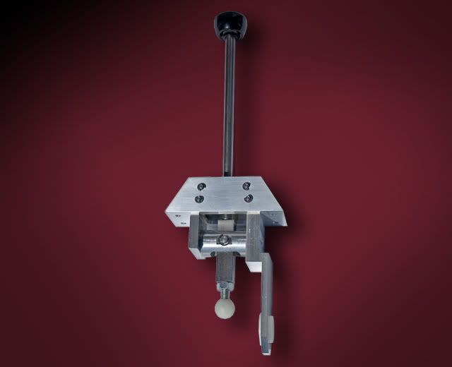

Now regarding The Bug@5-Speed Shifter: I have enclosed a few pics of the shifter and a few showing how it looks when fitted to a beetle chasis. See below:
Pic 1 5 Speed Shifter
http://i78.photobucket.com/albums/j1...r.jpg~original
Little info regarding the shifter:
- The Shifter can be looked as a short throw shifter, due to the reduction in shifter throw.
- The base of the shifter provides additional support for the beetle shift rod as well as a bushing for the beetle rod to ride smoothly on. This support eliminates a lot of the issues that some folks may have due the bending their bug shift rods like a Z or are not having the proper alignment. With the supported shift rod, proper alignment from the shifter to the input shaft on the Gearbox is maintained.
-Shifter has spring gate to prevent accidental shifting into reverse.
-Can use with a stock, aftermarker or our shifter ball. As you can see the shifter can be fitted with the Stock Beetle Shift Knob or you can use an after market one like ours.
Pic 2 of our shift knob on our shifter:
-Some folks have experiences issues when going from 1st Gear to 2nd Gear when using 901/914 boxes when using other options, precision of shifter helps fix this issue.

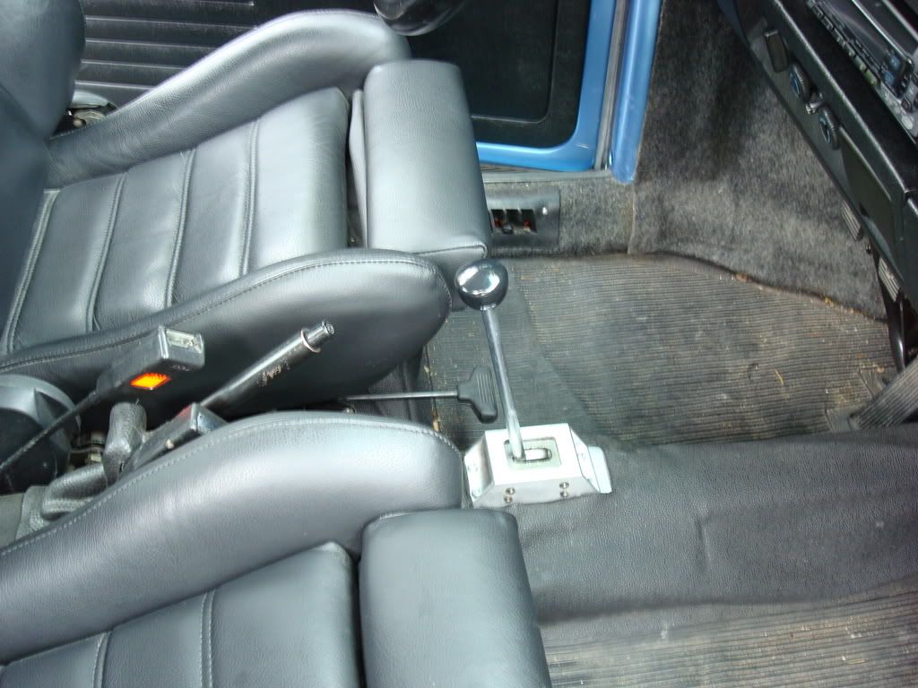

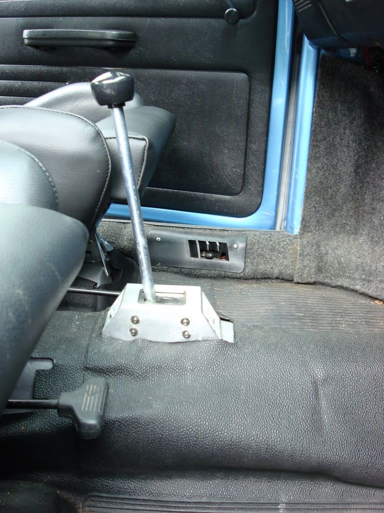

Some more pics of Shifter mounted to Beetle tunnel.
Pic3
Pic4
Pic5

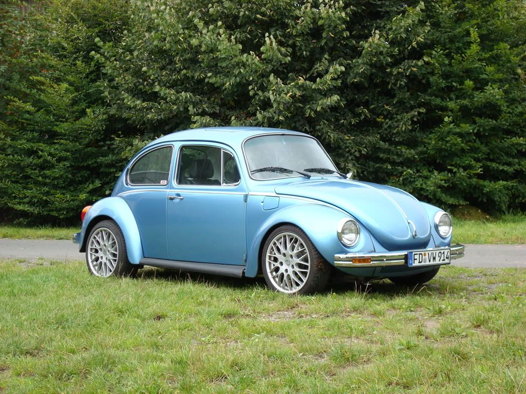

But yes its a 2.2 from a JDM Legacy. Non-Turbo. Custom Exhaust.
Suspension components are from GWD and Remmelle.. Brakes Remmelle, I remember from talking to Martin..
Has some nice early BMW seats, that look like they were suppose to be there.
Gearbox 914 with Bugat5speed conversion.. as well as Bug@5speed shifter...
Custom radiator and fan setup..

Does the shifter fit directly to the tunnel or do it require modifications to the hole in the tunnel.
How do you get the shift rod trough that bushing when it i so close to the tunnel floor?

But regarding the questions.. you essentially remove the old shifter cut a square where the old shifter use to be. You then fasten with 4 bolts to the tunnel. You can drill the 4 holes then thread them..
If I understand you second question correctly.. The bushing sits below the plane of the tunnel. When you put the shifter back, you push the shift rod thru the hole in the front, then thru the bushing which is supported by the lower bracket of the shifter.
