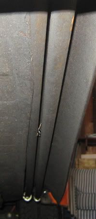

petevw September 27th 2007 03:08
I was running a 96-plate Mesa in between there on my '72. Motor was drysumped with 3/4 lines running to the front by way of the passenger running board. The cooler has a slight "bend" to it. Same radius as the spare tire well. Worked well for me.
