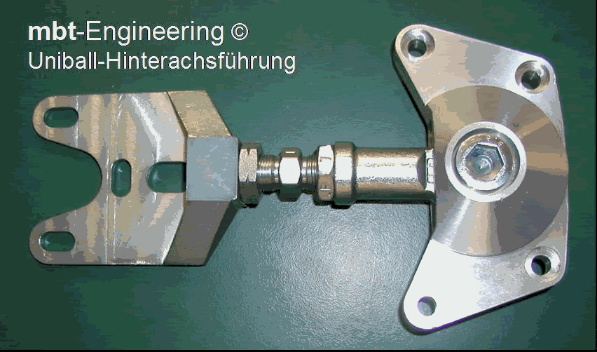

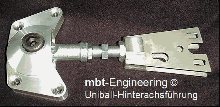

things like these
http://i66.photobucket.com/albums/h2...n.jpg~original
they stop the lateral movements of spring plates whilst not having tporsion bars, but still retain the twisting and up/down movement needed for the suspension.

Turbo Haraune2 November 4th 2007 08:52
Mine are made of aluminium with stainless steel plate against A-arm.
Much more complex design.
Those things you show there is going to break or bend under extra power from big engine. Ok for a sunday driver thoug.
Cost efficent? No not if you count your work hours.
but if you have acces to milling machine and lots of spare time, yes it is.
Mine look like this:
http://v-dubs.no/haraune/album12/photos/photo_15.html
split_trix November 4th 2007 13:10
where would they bend and break ? at the rose joint bolt possibaly ?
chris
Turbo Haraune2 November 4th 2007 14:43
Most likely the fastening of the bolt would rip of. or the bolt trough the uniball breaks. The bolt holding the uniball needs to be supported on both sides.
I have already bendt one turnbuckle assy due to overload, so i changed to harder material in the treaded part.
split_trix November 4th 2007 14:53
turnbuckle ? the threaded part in between the torsion housing plate and the trailing arm plate which defines the toe-in / out ?
also in your opinion would 3mm mild steel be strong enough for the laser cut items ?
chris
Turbo Haraune2 November 4th 2007 15:01
Yes the threaded part bendt. it was made of 304 steel i think, but i changed to 316 ss.
3mm is not enough.. at least use stainless steel. and make a sandwich type construction. with spacers between plates with same size as the uniball.

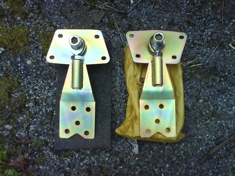

Steve C November 4th 2007 19:01
I cant tell by the pictures shown, but it looks like they only rely on the 4 bolts to secure it to the torsion bar housing. They need a boss so that the load is transferred to the torsion housing and not just the 4 bolts.
Hoghead November 5th 2007 00:36
I have the Eagle Performance part, and it spigots into the torsion bar tube. The idea is to take the load on the torsion tube, but the fit in my 40 year old corroded tube is not so great, and I question on how well this will work.
Current thought is to attach with grade 12.9 Allen bolts and TIG to the torsion casting.
The thread engagement on the heim end joint is about 25mm. A bit more thread would be nice.
I got straight plates for a 944 and not a Beetle with offset plates as shown in the pic. I think he was confused by my 944 arms so be very careful when ordering. The plates are now in Thailand and the freight to bring in offset plates is more than the part.
All I can do is use a spacer or get new plates made here
