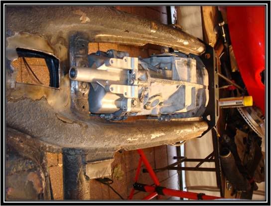

Slide 1- 5-Speed Conversion: Installing a Porsche Gearbox into your Type I IRS Chassis

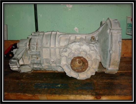

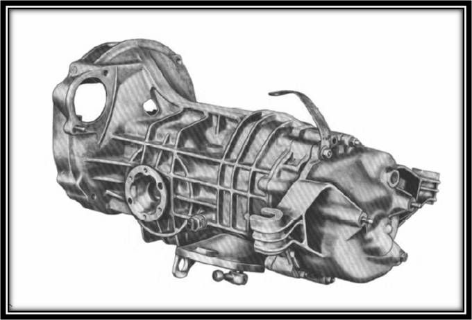

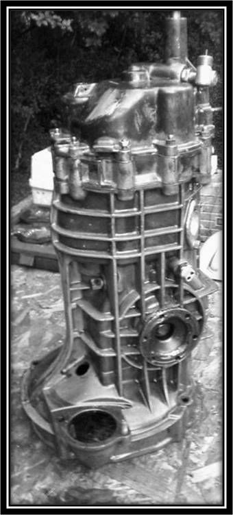

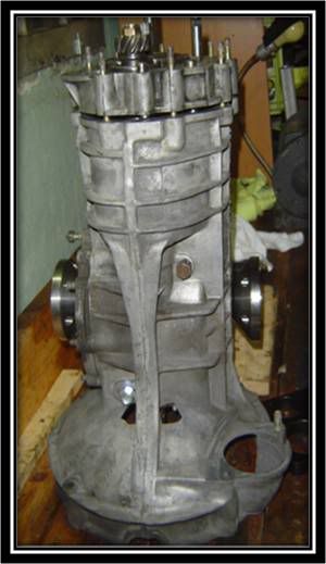

Slide 4- Distinguishing Porsche Gearboxes
This is an example of an early 911 gearbox. (used in the 911 from around 1965to 1968)
These boxes are referred to as 901 boxes.
Identification marks are located on the bottom of the gearbox
The 902 boxes are identical to the 901. It was found in early 912, and has the same internals as the 901 but different ratios

Early 901 Transmissions
Were made of Aluminum 65 to 68.
These boxes had a Push Type Clutch

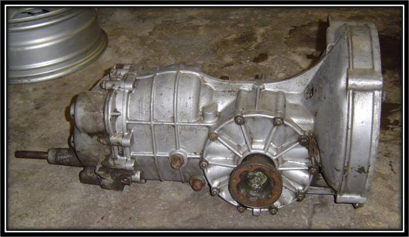

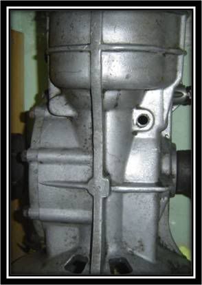

914 Tail Shift Transmission
Found in 914 Porsches (pre-1973 914/4 and 914/6)

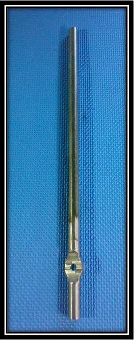

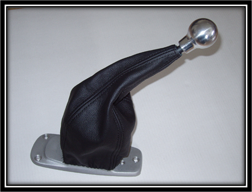

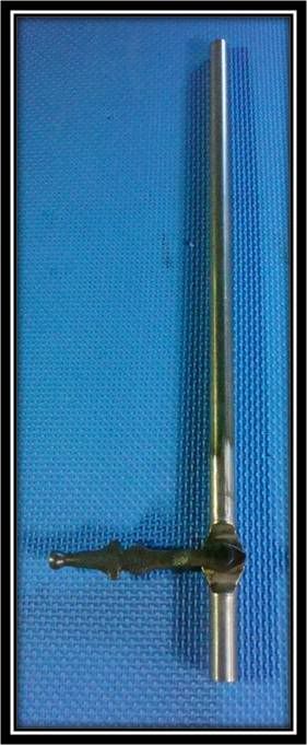

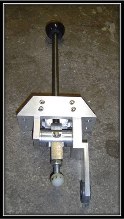

Bug@5-Speed “Beetle Shifter”
The Shifter can be looked as a short throw shifter, due to the reduction in shifter throw.
The base of the shifter provides additional support for the beetle shift rod as well as a bushing for the beetle rod to ride smoothly on. This support eliminates a lot of the issues that some folks may have due the bending their bug shift rods like a Z or are not having the proper alignment. With the supported shift rod, proper alignment from the shifter to the input shaft on the Gearbox is maintained.
-Shifter has spring gate to prevent accidental shifting into reverse.
Can use with a stock, aftermarket or our shifter ball.

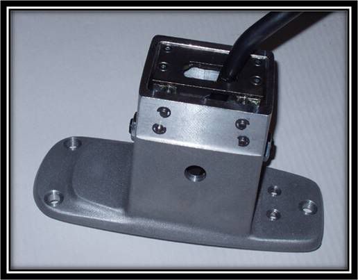

Bug@5-Speed “Porsche Style or aka Square Shifter”
This Shifter is similar to the beetle style but with obvious differences.
Shifter comes with a 911 style base to attach to a Porsche tunnel or modified beetle tunnel
Additionally comes with bent shift rod, leather boot, and machined shift knob.
This shifter can also be looked as a short throw shifter, as the shifter has a throw of less than 60 mm per gear.
The Shifter has spring gate to prevent accidental shifting into reverse.

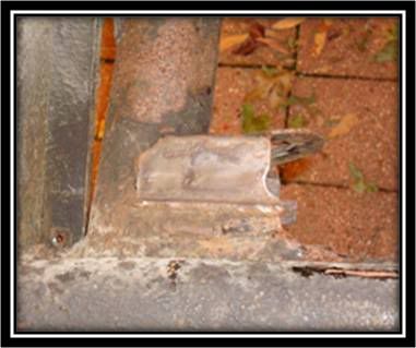

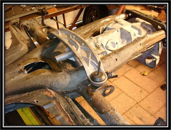

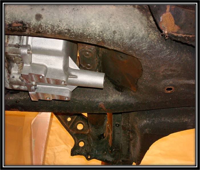

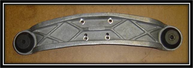

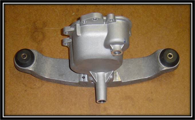

Bug@5-Speed Front Traverse
http://i78.photobucket.com/albums/j1...a.jpg~original
http://i78.photobucket.com/albums/j1...b.jpg~original
Cast Aluminum, with Hardened Black Mounts
Creates mounting point for Nose Cone.
Attaches to the based of the IRS mounts via special wedge spacers and M12 sized bolt

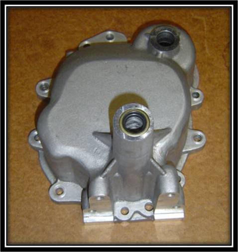

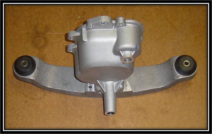

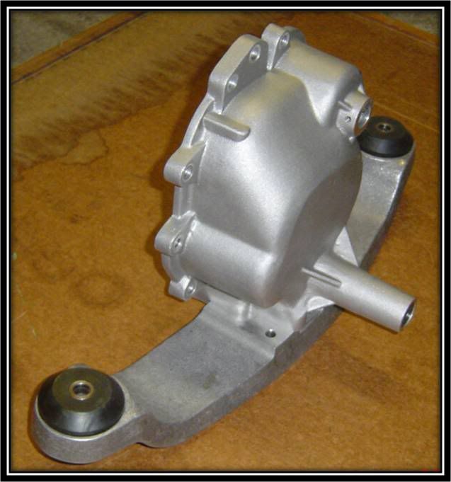

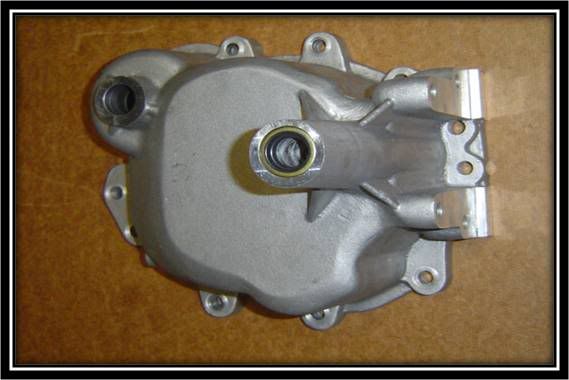

Bug@5-Speed Nose Cone
Cast Aluminum, and machine finished.
The nose cone allows the transmission to be moved fwd 30 mm thereby giving you more space out back and providing better weight distribution.

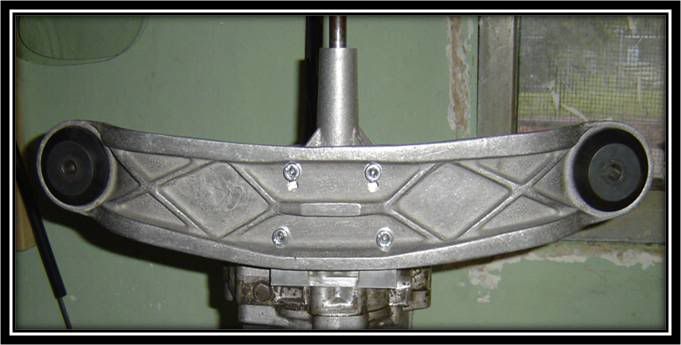

Slide 13 Bug@5-Speed Kit Components

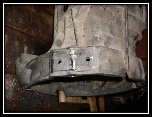

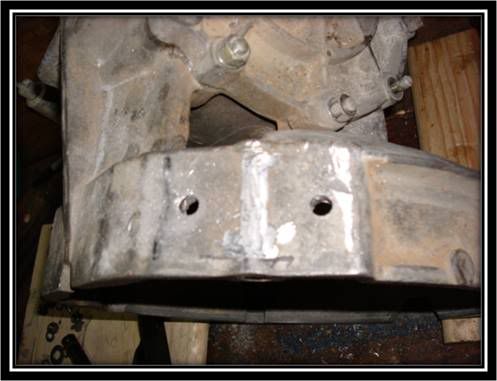

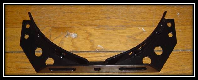

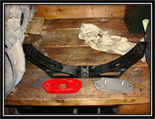

Bug@5-Speed Rear Support

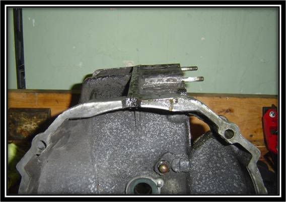

901 Style
914 Style

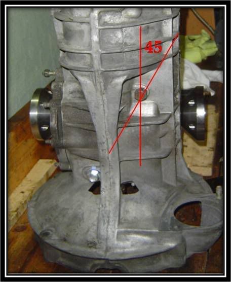

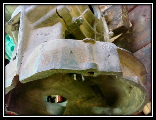

There are two designs due to the shape of the gearbox bell housing shape
901 style is designed to attach to 901 and 915 bell housing which don’t have the flat sections that the 914 ‘s have
914 style is designed to attach to the bell housing via beetle rear transmission mounts

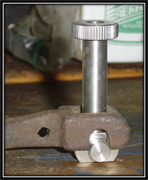

Bug@5-Speed also carries Inner Shift Forks for use when converting 914 tail and side shift gearboxes
http://i78.photobucket.com/albums/j1...1.jpg~originalhttp://i78.photobucket.com/albums/j1...2.jpg~original
Slide 16 Bug@5-Speed Kit Components

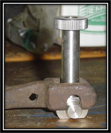

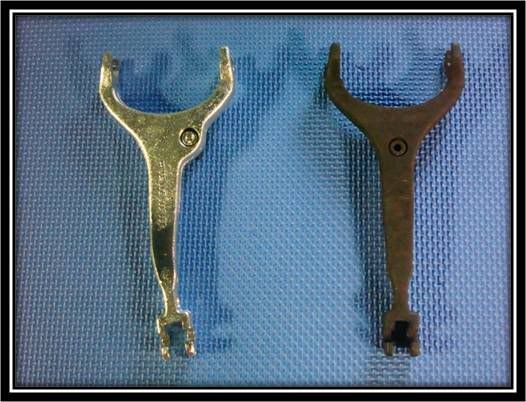

Bug@5-Speed also carries Modified 901 and 914 TOB Forks for use when converting 901, 914 tail and side shift gearboxes
Modified forks are bent to provide better geometry
These can be purchased on an exchange basis
Lever is newly galvanized after the modification/adjustment*and equipped with a new guiding socket at the back.*

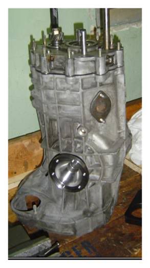

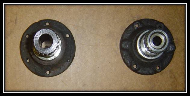

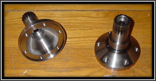

Bug@5-Speed Gearbox Output Flanges
Come in two sized:
Stock Beetle diameter (78mm)
944/T2 diameter (86mm)
Machined and Hardened
Note: early 901 flanges have larger opening and must be specified
Bug@5speed(US) December 12th 2007 22:26
Getting Started (Partial Disassembly)
Slide 19- Getting Started (Partial Disassembly)

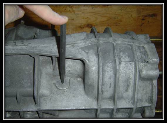

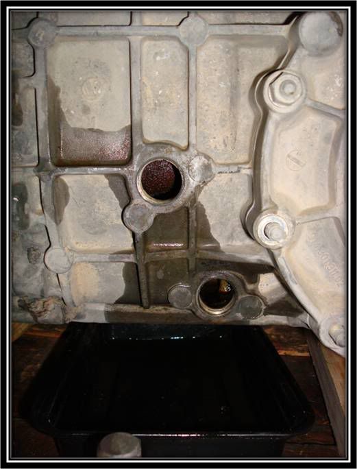

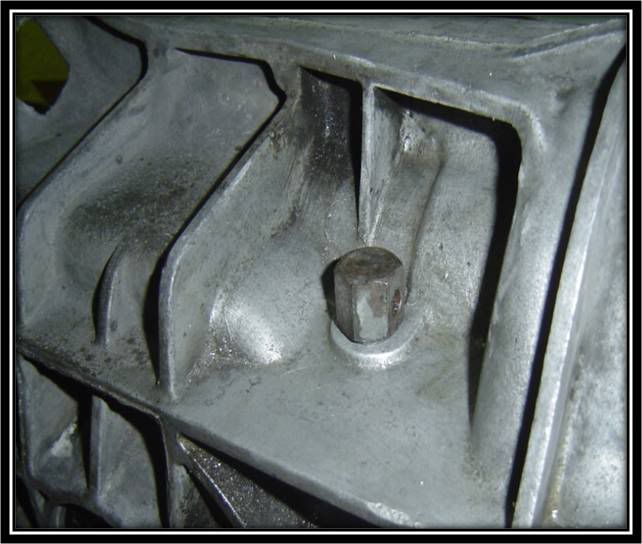

Drain oil via two plugs on the side of the gearbox (17mm Hex Drive)
Lower plug is magnetized to capture filings
It is a good idea to inspect this plug to have an initial idea of condition of internals

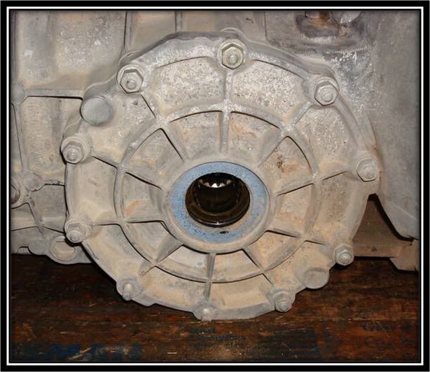

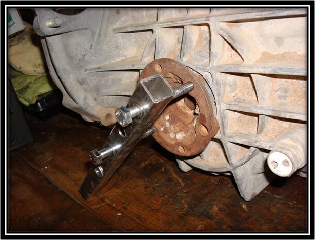

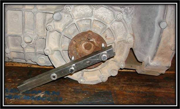

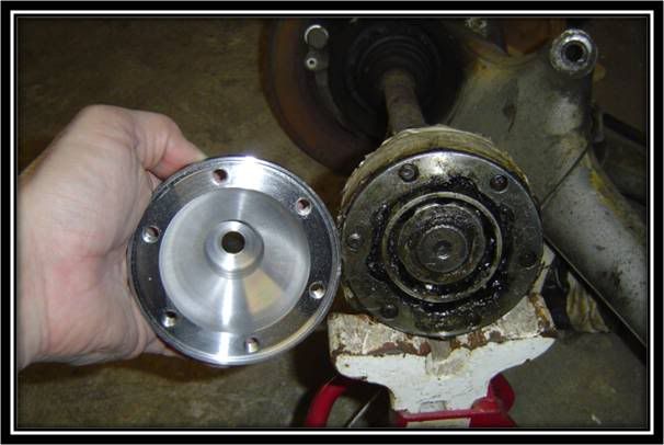

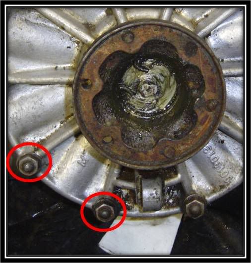

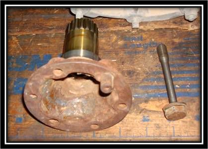

Removing Flanges
Utilizing 1 inch square stock special tool is made to prevent flange from spinning
Bolt on flanges are size 19mm and are referred to as diff expansion bolts

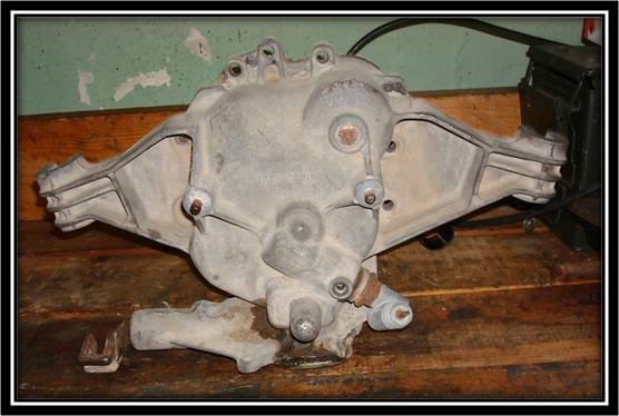

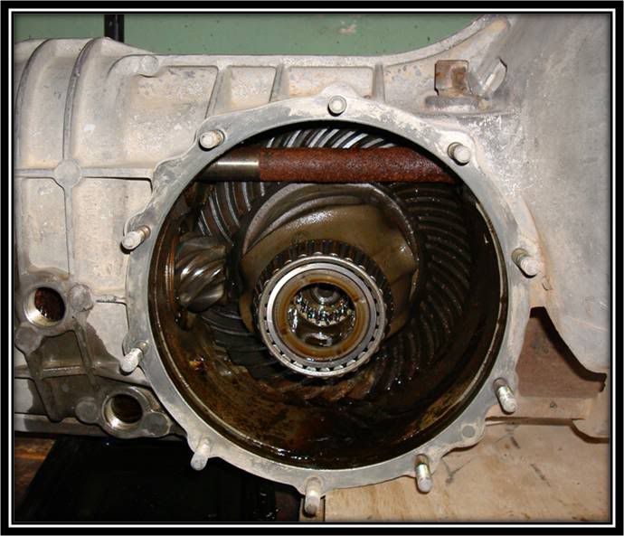

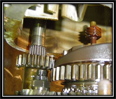

Slide 21 Getting Started (Partial Disassembly)

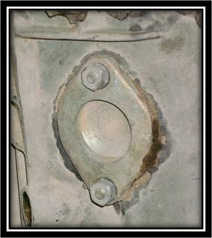

The differential side cover/plate is secured by 13mm sized nuts
Removing of the side cover is necessary in order to flip the differential
This is necessary on the 914 gearboxes due to the 914 boxes being set up for mid engine configuration
Failing to due this will yield one fwd gear and 5 reverse gears

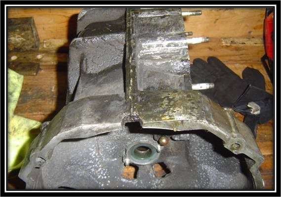

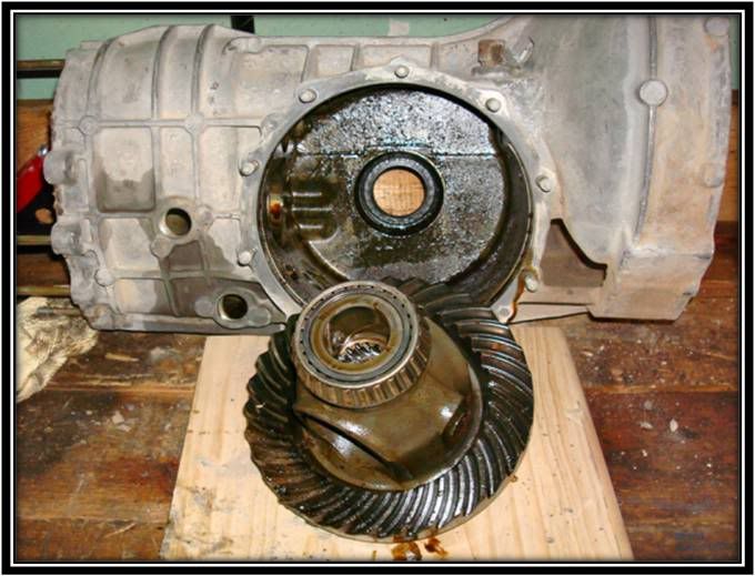

Slide 22 Getting Started (Partial Disassembly)
Side Cover removed exposing a poorly maintained gearbox
This is not what you want to find
With cover removed it becomes evident that in order to remove the diff, the pinion shaft and main shaft will have to be removed

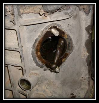

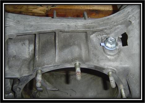

Few more items that need to be removed to enable the intermediate plate, and gear stack to be pulled away from the case to access diff
Unbolt 2 13mm nuts to removed side cover plate; freeing inner shift rod
Removed reverse gear switch and pin
Bug@5speed(US) December 12th 2007 22:37
Getting Started (Partial Disassembly) (Continue)
Slide 24 Getting Started (Partial Disassembly)
With the intermediate plate and gear stack out of the way you can now pull the differential from the box
Now reinstall with differential Ring Gear facing the opposite way

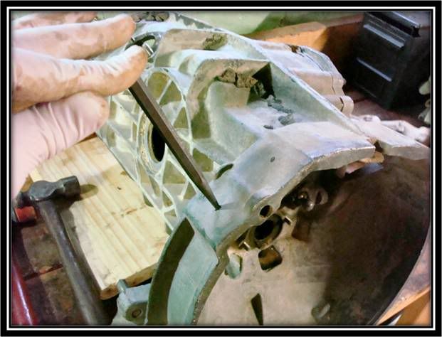

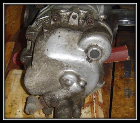

Nosecone is secured to intermediate plate via 13mm nuts.
Once nuts are removed utilize a rubber mallet to remove nosecone
Take caution when removing the nosecone, as the reverse gear assembly may fall out/off

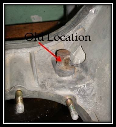

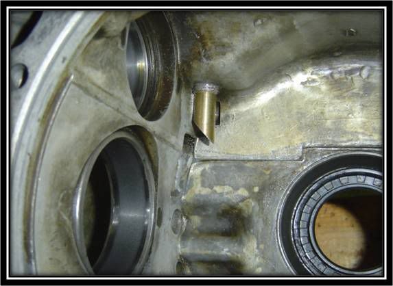

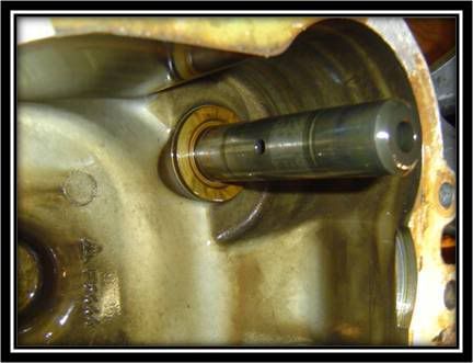

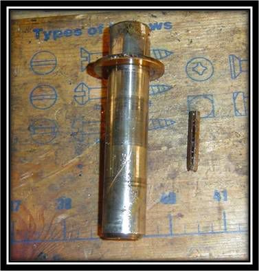

With cover removed now is a good time to transfer reverse gear shaft onto your new nosecone
Example shown of early 901 nose cone
Utilize a small punch and remove small pin
Remove reverse shaft and relocate onto Bugat5speed Nosecone
Reinsert small pin to secure/lock reverse gear shaft
Slide 27 Getting Started (Partial Disassembly)
Reverse Gear shaft shown on the old nose cone
Reverse Gear shaft and locking pin

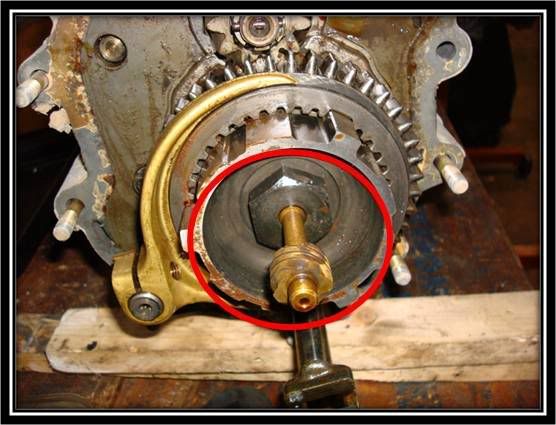

With Nose Cone removed, now is a good time to remove the speedometer drive gear
Two approaches
(1) Use a hacksaw and cut (Not best approach)
or

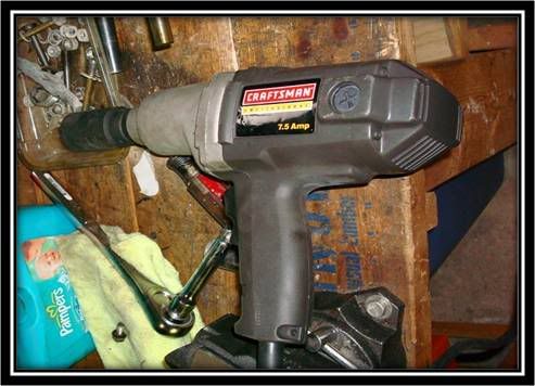

(2) Remove Expansion bolt (held in place with (80-87ft/lbs) and decouple drive gear (Better approach)

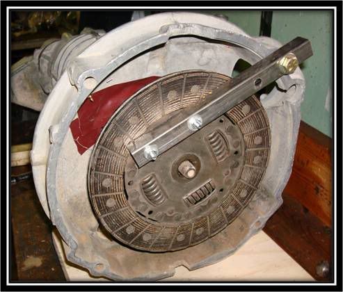

Slide 29 Getting Started (Partial Disassembly)
The Expansion bolt is size 32mm, and will require that you lock the gearbox down in order to utilize an impact drill to remove.
There are many methods to locking the gearbox, one such method is to utilize an old clutch disk, using some one inch stock and a few bolts (See side picture)

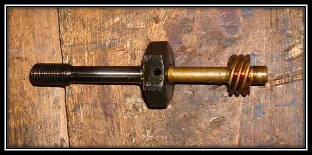

Once expansion bolt is removed from, you will notice that the speedometer drive gear is secured via a small pin
To separate remove lock pin

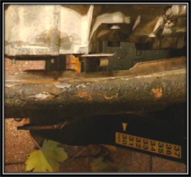

The Bug@5-Speed Nose Cone and Front Traverse are shown on the right.
With the reverse gear shaft installed and locked in, you can attach nose cone to the intermediate plate and gearbox.
Be sure to replace the factory gasket or utilize a liquid gasket to create a good tight seal
Secure to gearbox with the self-locking nuts and washer
Torque 13mm nuts to 18 ft/lbs (Per Porsche Manual

The Front Traverse is secured to the nose cone via (4) hex bolts
This is what the final nose cone and traverse should look like.

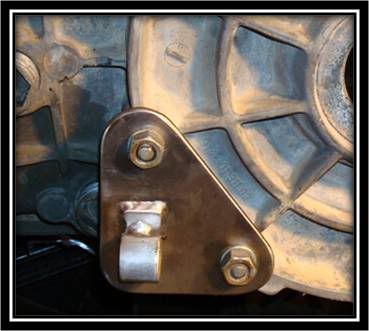

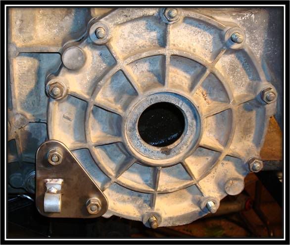

Bowden Tube/Clutch Cable Adapter Plate Install (914)
The Adapter Plate is utilized to redirect and establish proper geometry for the clutch cable and Bowden tube
Install is accomplished by placing adapter plate onto differential side cover via two 13mm nuts
Shown is install on a 914 gearbox

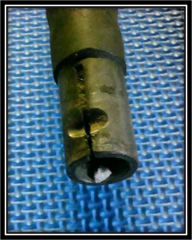

Slide 34 Getting Started (Partial Disassembly)
Bowden Tube/Clutch Cable Adapter Plate Install (901)
While the 901 early gearbox has an eyelet for the clutch cable, this is not the optimal setup.
It is recommended to use the Bug@5-Speed Adapter Plate. The Plate is utilized to establish the proper geometry for the clutch cable and Bowden tube
Removal of the 901 eyelet will be necessary.
This can be accomplished by cutting the old eyelet and plugging hole with automotive plug
Failure to plug hole will yield hole in side cover
Slide 35 Getting Started (Partial Disassembly)
In order to attach the cable extender to the 901 or 914 Tob Fork, you need to attach the adapter piece which will serve as a guide for the knurled extension

Slide 36 Bug@5-Speed Rear Gearbox Support
This is the bell housing side of the gearbox.
The rear gearbox support is attached to the bell housing via beetle transmission mounts.
It is affixed to the two flat areas on the bell housing
Slide 37 Bug@5-Speed Rear Gearbox Support (Cont)
Both variety of transmission mounts can be used with the Bug@5-Speed Traverse
To begin the installation process, you must mark where the attachment holes will need to be
Slide 38 Bug@5-Speed Rear Gearbox Support (Cont)
With the bell housing marked, use a punch and hammer, to mark the pilot holes for the drill bit
Slide 39 Bug@5-Speed Rear Gearbox Support (Cont)
http://i78.photobucket.com/albums/j1...a.jpg~originalhttp://i78.photobucket.com/albums/j1...b.jpg~original
With the 4-holes drilled into the bell housing, the next order of business is to utilize a grinder or dremmel with grinding bit to create a flush mounting surface for the transmission mounts
Slide 40 Bug@5-Speed Rear Gearbox Support (Cont)
The last order of business is to attach everything to the bell housing with the manufactured supplied bolts/nuts or grade-8 or better hardware
Bug@5speed(US) December 13th 2007 22:06
Bug@5-Speed Output Flange
Slide 41 Bug@5-Speed Output Flange Install
http://i78.photobucket.com/albums/j1...b.jpg~originalhttp://i78.photobucket.com/albums/j1...c.jpg~original
When ordering its important to know if you have the early 901 sized flanges (Large) or 914 flanges (Small) due to the different sized hole in the flange.
Bug@5-Speed Flanges are affixed to the differential with the removed washer and expansion bolt (It is recommended that you replace bolts with new ones
Tighten to recommended manufacture specification
Bug@5speed(US) December 13th 2007 22:18

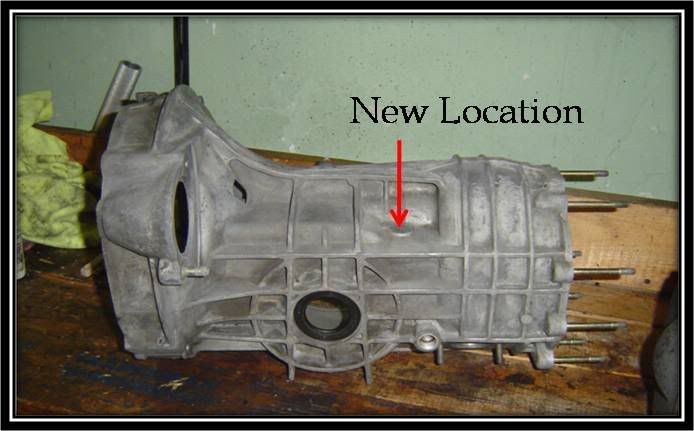

Relocating Oil Breather
Slide 42- Relocating Oil Breather

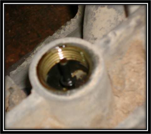

When using a 914 box it is necessary to relocate the oil breather tube to the same location as it would be found on a 901 box
Bottom picture shows where the new location will be on the 914 box
Slide 43- Relocating Oil Breather (Cont)

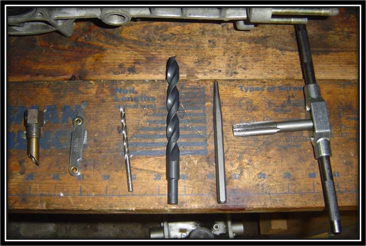

Some of the tools you will need to accomplish this task:
Oil Breather
Thread Pitch gauge
Small drill bit for pilot hole
Large bit
Punch
Tap and Handle
Note: Remember your safety equipment (eye protection)
Slide 44- Relocating Oil Breather (Cont)
Use a Punch to mark the new location of oil breather tube
Ensure new location of tube clears case internals
Slide 45- Relocating Oil Breather (Cont)
Use a small drill to create pilot hole
Use appropriate large drill to open up hole to correct size for tapping
Use gauge to verify correct tap size
Using cutting oil, and tap with handle cut new threads onto case
Slide 46- Relocating Oil Breather (Cont)
Lastly fit breather into new location. Breather should have approximately 45 degrees offset
Plug old hole with automotive plug
Oil Plug can be used

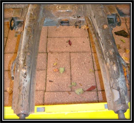

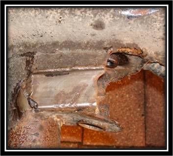

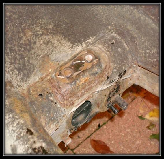

Type I IRS Chassis Prep
Slide 46 Type I IRS Chassis Prep
Installing the Bug@5-Speed Conversion kit can be done with body on or off.
When installing the kit, it will be necessary to remove the old beetle transmission mounts as shown in the top picture
A grinder and some eye protection make quick work of the transmission mount bolts
This is what chassis should look like after bolts are ground off and surface made flush
That's it for today..
Tomorrow the rest of chassis prep
Enjoy and comments always welcome.

Slide 49- Type I IRS Chassis Prep
With 30+ years of grim and dirt, now is a good time to wire-wheel and clean the bottom of the IRS mounts
Also clean the flat section of the frame horns
This will help with test fitting the gearbox and when you need to identify areas that need to be clearance
Slide 50- Type I IRS Chassis Prep
One of the first areas that you will notice that needs to be marked for clearance is the right hand side of the nosecone/intermediate plate (looking from top of chassis)
Slide 51- Type I IRS Chassis Prep
Shown here is the clearance for the reverse gear switch
Slide 52- Type I IRS Chassis Prep
Shown is the clearance for the Clutch Cable Adapter Plate and for the TOB Fork

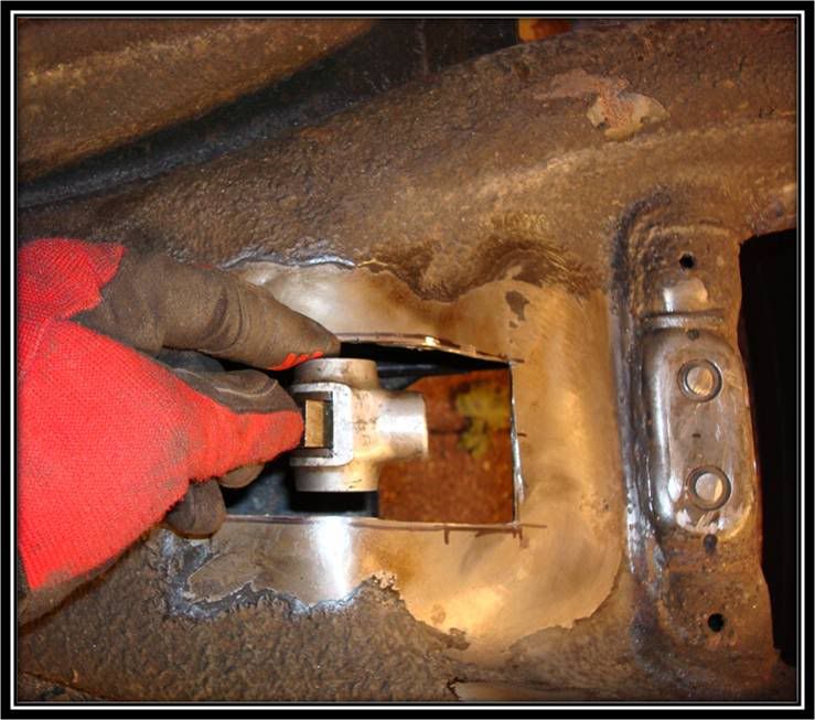

Slide 55- Type I IRS Chassis Prep
Gearbox is situated between frame horns to begin marking area to be cut for the inner shift-rod that will enter tunnel in the new location
Slide 56- Type I IRS Chassis Prep
Using a wire wheel, area to be cut was cleaned to enable marking of the necessary patter for the shifter coupling to fit through the tunnel:
Porsche Shifter Coupling requires hole cut to 60mm x 120m
If using a VW Shifter Coupling it requires hole cut to 70mm x 120mm, due to larger size
Slide 57- Type I IRS Chassis Prep
Once the hole is cut this is where the shift rod will enter tunnel.
Notice the Porsche Shifter coupling
Slide 58- Type I IRS Chassis Prep
With shifter coupling hole cut, its now time to center our attention onto the front traverse, and the IRS mounts which serve as the mounting point for the gearbox
Slide 59- Type I IRS Chassis Prep
http://i78.photobucket.com/albums/j1...a.png~originalhttp://i78.photobucket.com/albums/j1...b.jpg~original
With the gearbox installed with the front and rear traverse, we will mark the location for the bolts to attach to the IRS mounts.
