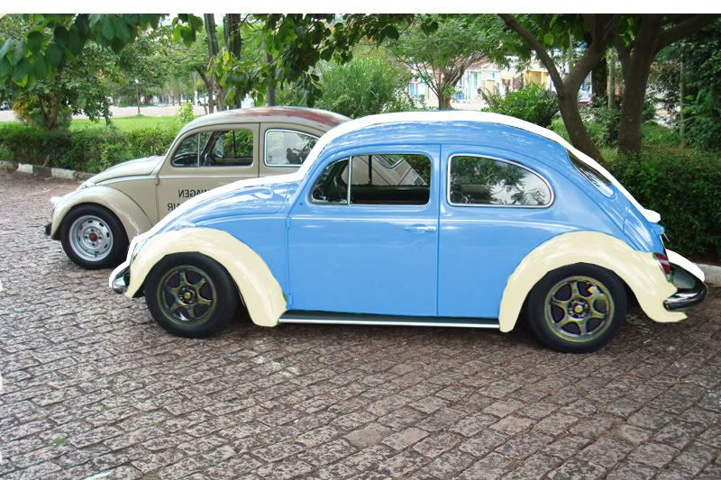

Veedub March 1st 2008 01:13
Just for kicks and giggles I did a photoshop of my bug.My other car is a 96 Sentra, and it has a set of 5zigen RSX-6's on it.There 15x6.5, offset unknown to me.
What you guys think, its different.The sentra Im eventually goin to get rid of but not anytime soon just yet.Since these wheels were 160 each new an arent that old, thought maybe switch them over to my bug.There Hyper Black by the way.The tires on them now are 195/50/15's on the sentra, but on the bug Id go the same size.What you guys think?
