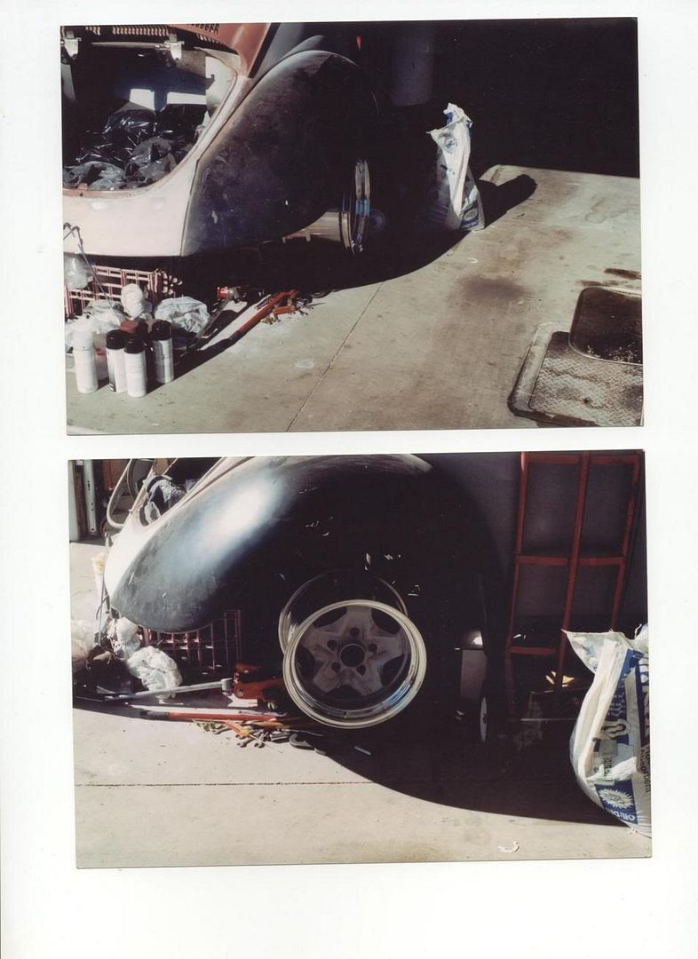

So very correct. I started just wanting a mildly strong type IV. First is was to be a 1302 Super Beetle, then I saw how that I likes the 1303 more. If you give your self a budget and It's small, be perparied to go way over it. Since my story is ongoing, I don't have a finished car to show; here are some pieces.

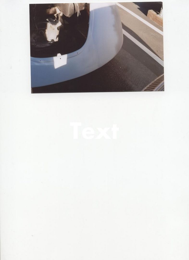

I want to body to look nice, but I can't afford a body man; so I'm doing it myself.
http://i86.photobucket.com/albums/k9...3.jpg~original
Plus I want to be different, so I reverse directed the louvers.
No fender beading like the Porsches, fiber glass fenders, with .,020mm plumber tape for a barrier.

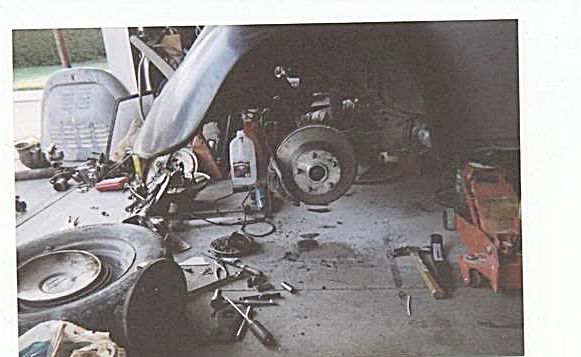

Now some brakes.
http://i86.photobucket.com/albums/k9...t.jpg~original
The brakes are 1985 944 front calipers all the way around

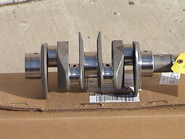

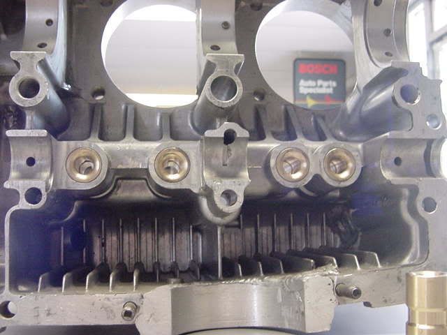

Here is some engine stuff.
Converting to 356 lifters 650.00US
Modding the type IV case to adapt a type one sump and exterior pressure releif valve

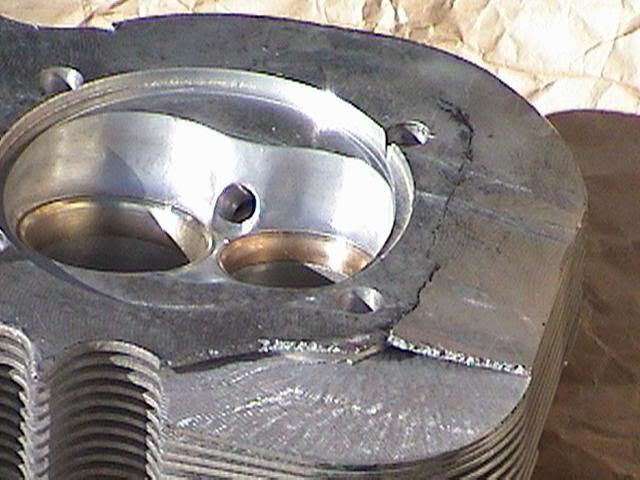

Buying a brand new set of type IV high performance heads and intakes, only to have them shipped bulk rate un-insured, not to mention a seller that will not make it right 3962.00 US
How about a custom crank 1800US.
What about supertine pullies for a 911 cooling system?
The point is, I trully agree to the point of either seeing you ideal come to life or except your progress and wait. When you start buying thing not on the shelf, it cost even more:o , Welcome and good luck on your project :)

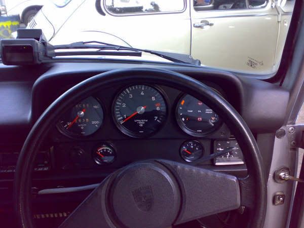

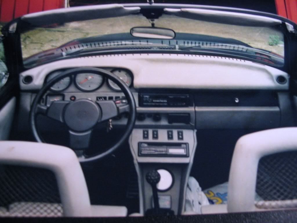

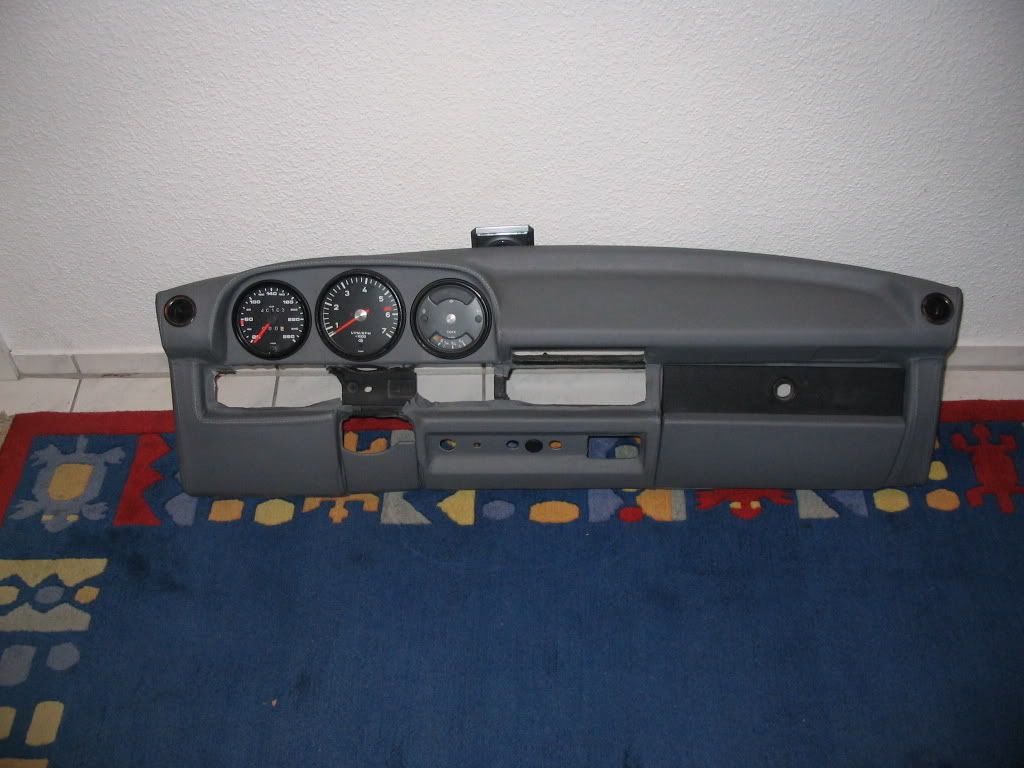

Almost forgot, which car is your choice? If you choose the Super Beetle flat windshield, replacing the dash pad won't be a problem. But if you choose the curved windshield Super Beetle, there is a problem. In the USA, there are no replacement parts for the curved windshield Super Beetle dash pad. The one source that I have seen in Germany will only sell the dash as a total restoration package. Dumping allot of money into your dream and finding out, you may be stuck with a crap, cracked dash feels bad.
http://i86.photobucket.com/albums/k9...0.jpg~original
For me, this is the way to go, a modded curved windshield Super Beetle dash pad, modded for the Porsche 914 gauges; note the padding. CSP sells a fiber glass 911 dash unpadded. Just things you should be aware of, and one more thing; if you see some posts you like, print the page and save them in a folder for future reference.
