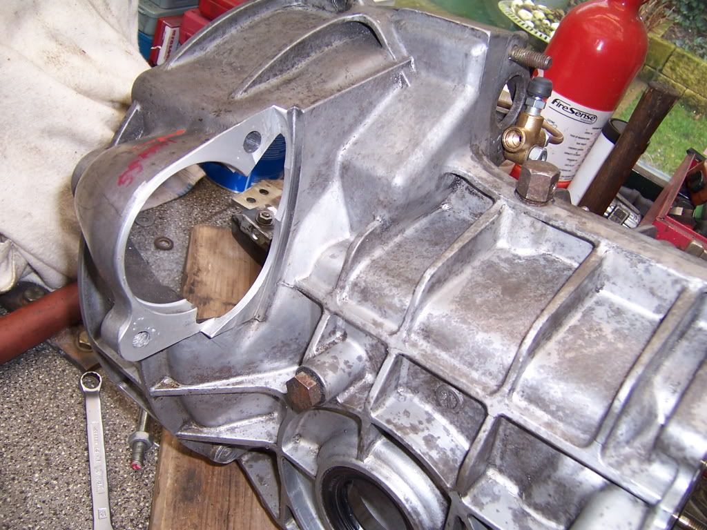

First of all, the shortening of the bellhousing I see as mandatory for how I want the gearbox to be positioned in the car. I.e. not cutting the torsion tubes and loose structural strength, which neccesatates new pieces of even heavier iron strcutures welded in elsewhere.
A local company wants to help me machine off the first rib of the bellhousing

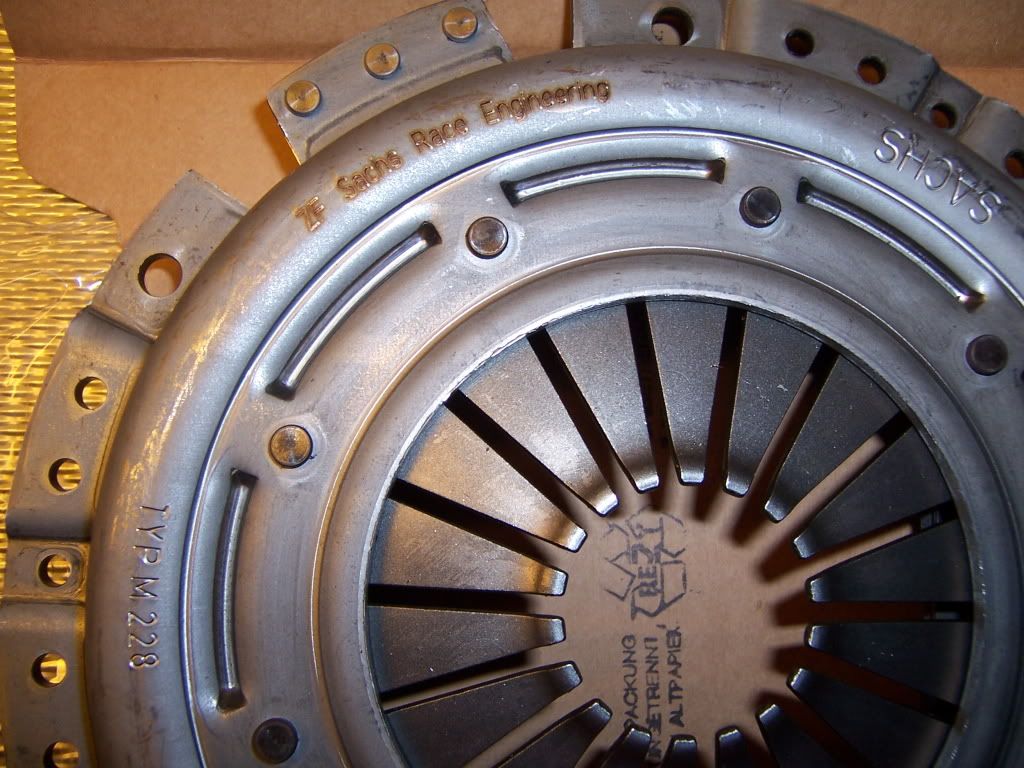

Also the VW Bus 228mm flywheel seems the best solution, so i will probably order the aforementioned KEP clutch. An annual throw-out bearing still seems the best solution for that. Then I don't need to order the G50 update kit for the original G50 hydraulic relase arm bearings, which still works with a pull type TO-bearing system anyways and that doesn't supports my 228 VW flywheel and pp push TO-bearing idea.
With the conventional 228mm pp I also think I retain the option to have a double clutch plate option for future power upgrades without using a super duper costly porsche aftermarket G50 solution with double plates.

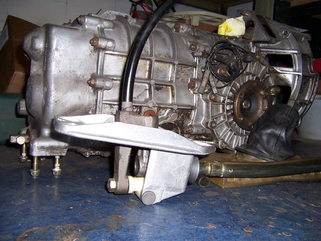

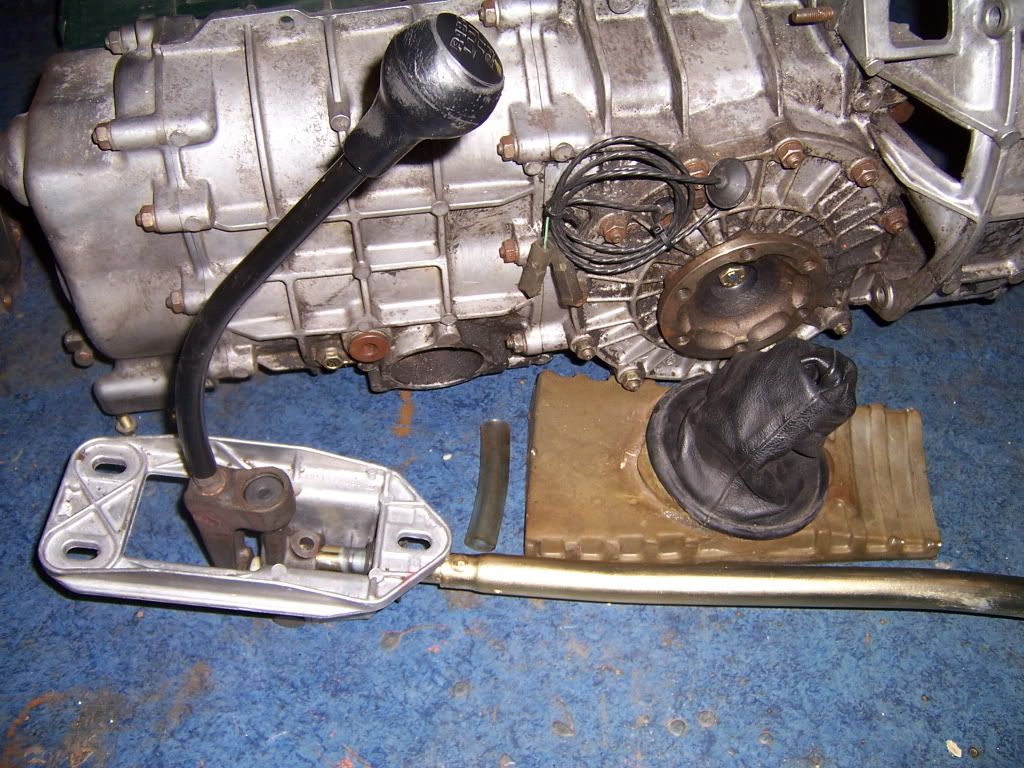

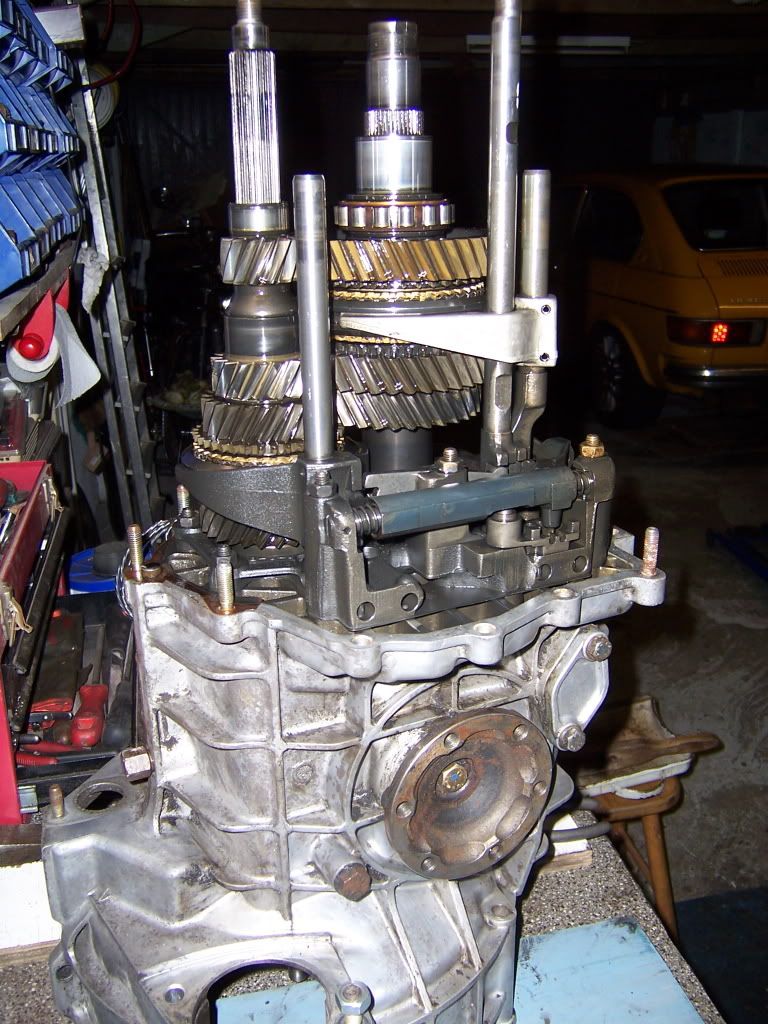

Wally October 13th 2008 16:42
Found the shifter and shaft again :)
As you can see, its quite different from a 915 shifter and its operation.

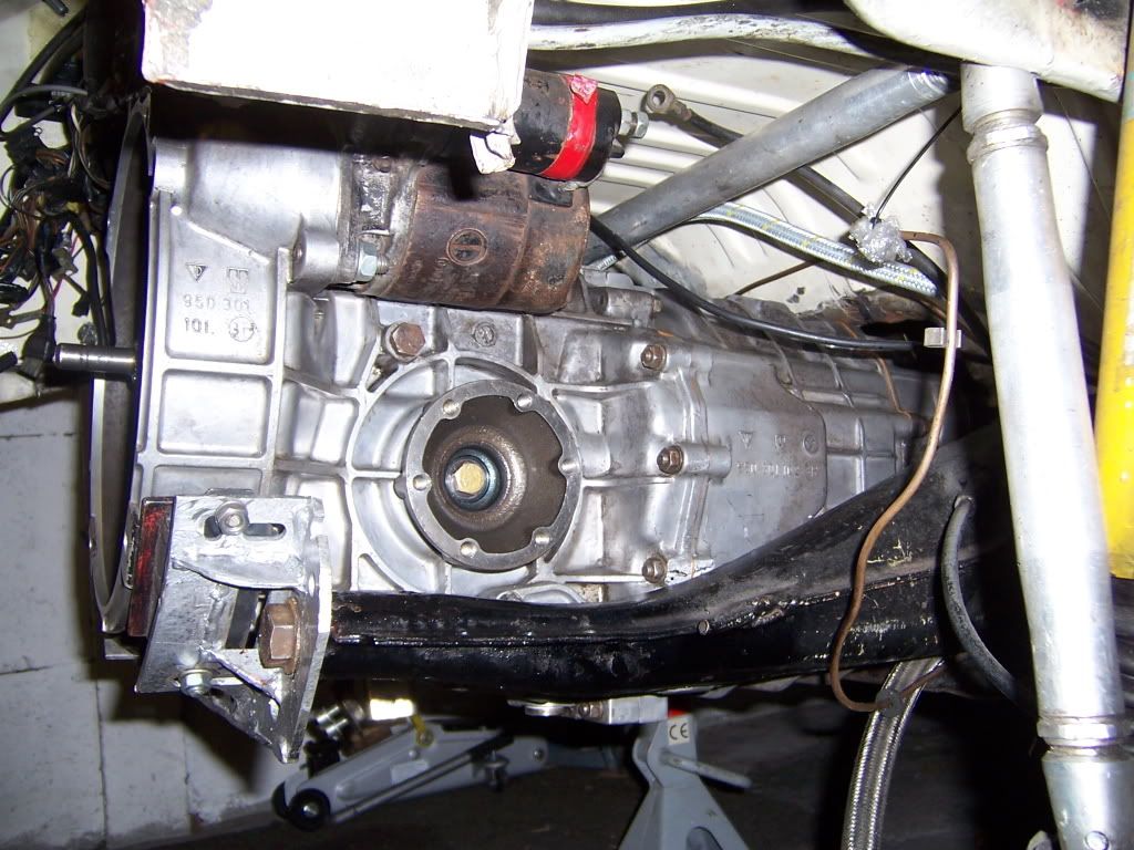

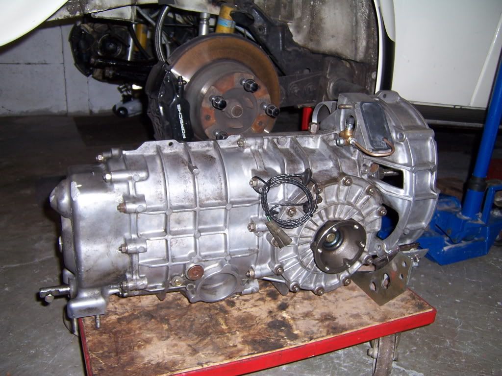

Wally October 21st 2008 09:42
Some pics when positioning the G50/01 between the forks. It seems that only some of the horizontal parts of the forks need trimming:
http://i174.photobucket.com/albums/w...hassis/007.jpg
http://i174.photobucket.com/albums/w...hassis/008.jpg
http://i174.photobucket.com/albums/w...hassis/010.jpg

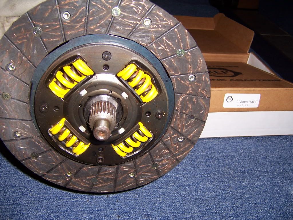

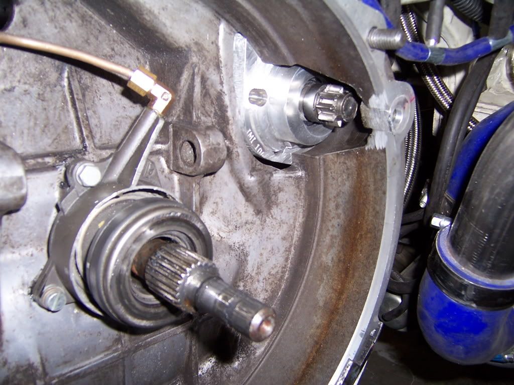

I decided to order an organic disk from Kennedy, G50 center, 228mm and spring centered. Flywheel will be a lightenend bus 228mm unit and for now a stock pp to do some measurements.
Plan is to mount up a dummy type 4 case to see what needs to be done to get the clutch engagement working. I hope to be able to fit an annular hydraulic throw-out bearing instead of the pull style arm that is in there now.
Anyone know what the most shallow universal hydr. annular TO bearing is on the market?
Steve C October 22nd 2008 08:46
Hi Wally
I was going to use a Saab throughout bearing until I went full G50 clutch.
http://www.clubvw.org.au/images/G50_hc.jpg
http://www.clubvw.org.au/images/G50_hc.1.jpg
