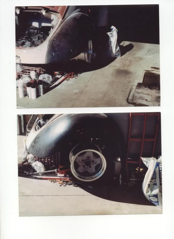

Why not go with 1", 2" or 3" fiberglass fenders. I shorten my own IRS trailing arms, it does take some work. You can shorten the trailing are 1' Per side. Fiberglass fender makes your task much easier:o . I wanted 10 rims so I went the fiberglass way.
