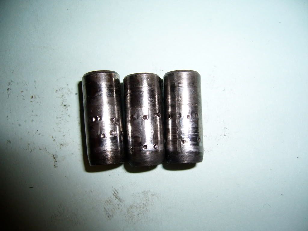

Well bad news, my motor has to come apart:angry:
Basically what happened was i started hearing a weird noise coming from the clutch area. After pulling the motor to investigate, turns out the pilot bearing is effed. But that's not all i found! I take the gland nut out, only to find my flywheel really loose on the dowels....
So i pull it off, and the dowels fall out of the crank! I look at the dowels and they have been peened all over their circumference. (It's a dirty trick to make the dowel a few thou bigger to make them a nice press fit in the hole) The rest of the crank is beauty, real nice piece. But because of some lazy goon, who reamed the crank a thou or to over, they had to make the dowels a little bigger to fit!
Now the dowel holes are all ovaled, and i'll need to put in a new crank!

I'm assuming you 2 didn't centerpunch the dowels. The dowels were in the crank when recieved?

I'm about 8 months away from being a licensed machinist;) We didn't peen the dowels. They came like that, installed from the factory.

Sorry bro, the peening trick is dirty, very dirty. Can't you bump up to a 11/32 dowel and save the crank/flywheel?

I will save the crank one way or another, but am also toying with the idea of bumping the stroke up to 82mm :) I mean the crank has to come out anyways.... same old story lol Plus I may have a lead on some cheap IDAs...

Hate to say it but The cheap china cranks never have passed the sniff test with me. I seen major flex with them and I still have a couple of cracked ones kicking around here.
Crank and flywheel must be 8 doweled together then reamed for the proper press fit. If they are not then you're just pissing up a tree in a headwind.
