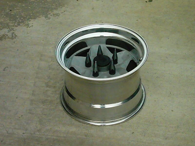

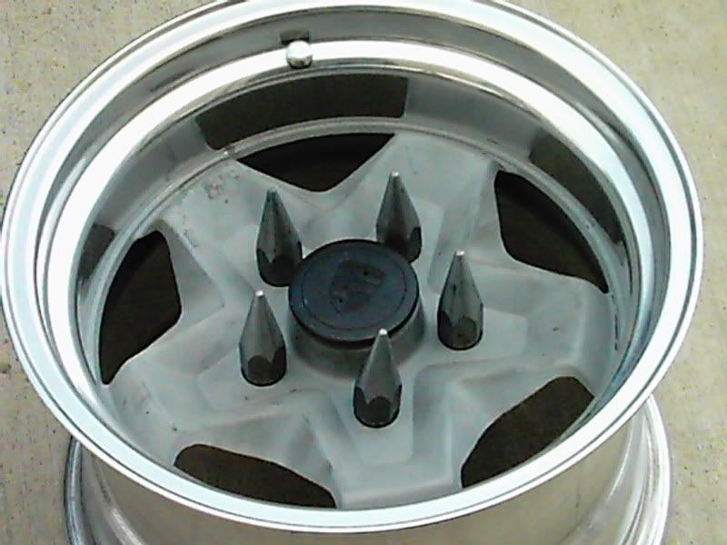

I wanted wider rims, at the time I choose the Cookie Cutters. The guy that did mine, is all he does is Alloy rims, his name is Eric Vaughn; 1-626-358-6413 Eric is very slow, but very good at welding the Alloy rims. I also know of a company that does Steel. How is does it is on a lath, he cut off the outter ring. I don't know if he does 19' but give him a call.
The outside rim is a blank Eric buy for your project. The weld, will there is a machine he jigs up your center section. The weld process is automated, damn good work:D
Panelfantastic September 23rd 2008 15:35
2nd on Erics work. Took forever, but quality is very high.
He widened a set of repo BRMs for my oval (back before you could buy them wider :mad: ). He split them behind the center and added his own hoop to the back half of the wheel. Went from 5.5s to 7s. He was even able to keep the heat controlled enough so as not to discolor the factory paint on the front side of the wheels.

When I wanted Eric to do my rims, I tooked them to him. Once there he showed me what was invloved. No doubt this project or business (that's what Eric do for a living) has its risks. And defineately no back yard welder for me either:o . In the end you make the choice. On the back side, nothing but a very nice weld. Just so you know there is some one out there. This has been three years ago, I don't have the car running, his price was 200.00 per wheel (then)
