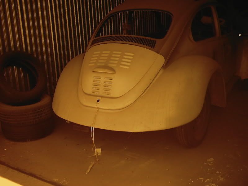

Hi, do it the easy way, go wider fenders(fiberglass). You are asking for alot of work:D
http://i86.photobucket.com/albums/k9...1.jpg~original In this pic, I have a set of 3" extra wide figerglass fender. The rims are 10". I had to go with 4" extra wide because I needed to add the 1" spacer for the needed offsed of the rims and contacting some part of the suspension.
http://i86.photobucket.com/albums/k9...3.jpg~original
This is with the 4" extra wide fenders. If you can go fibergalss, it will make your life simpler.
