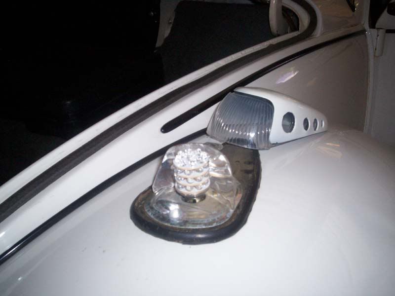

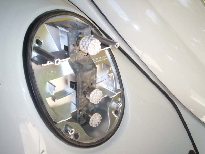

ive switched out every bulb in my bug for LEDs except obviously the main headlights and i didnt worrry bout charge and oil as theres alot of extra work involved in that but all the others are LED now
main reason i did it was the coloured bulbs totally ruined the effect of my clear indicator and elephants feet lenses but my electrical system is working 100x better now without the load of normal bulbs
eventually ill put a HID kit in
http://i226.photobucket.com/albums/d...0.jpg~original
http://i226.photobucket.com/albums/d...1.jpg~original
http://i226.photobucket.com/albums/d...2.jpg~original
evilC June 25th 2009 08:28
What did you do about the flasher relay? did you swap to an led relay or add resistors?
Joel June 25th 2009 19:26
the shop i got all the bulbs from also sold the LED flasher relays
cost me $90AU all up

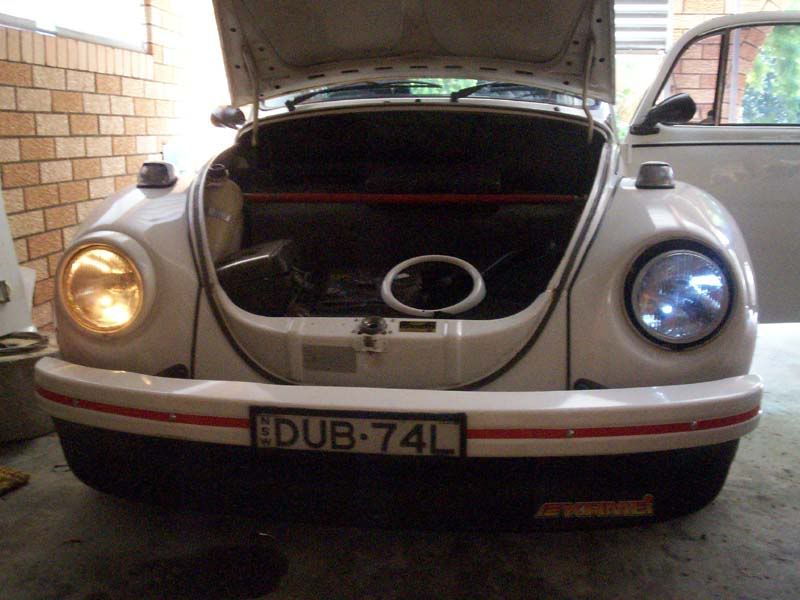

Steve C June 25th 2009 19:58
1 Attachment(s)
Just remembered I had a photo with the Cibies on
evilC June 26th 2009 04:55
I bet you had to tow an alternator and battry pack behind it!:D
