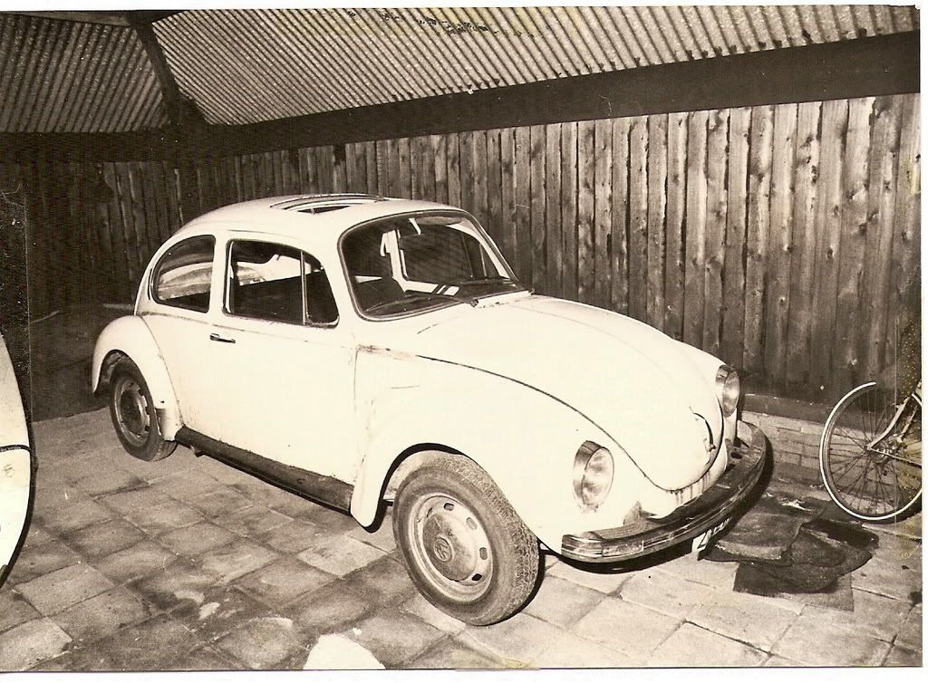

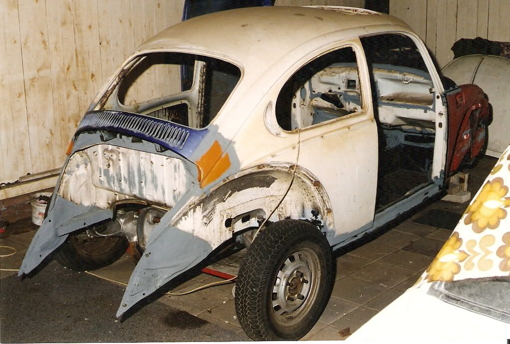

It all started in 1991, when I wanted an original '75 model 1303, registered for the first time in my country, the Netherlands. Not many have been delivered from that model year over here: only 32 !
Upon arrival:

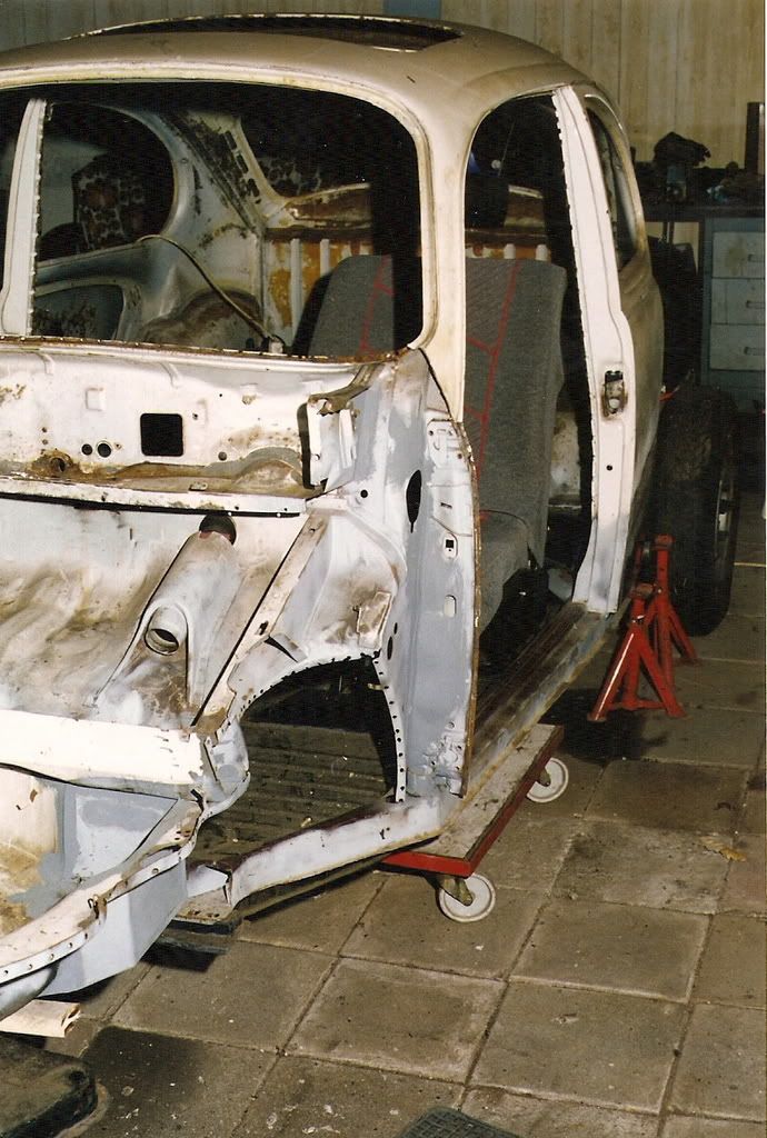

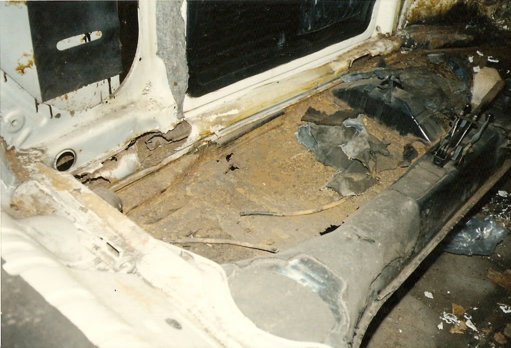

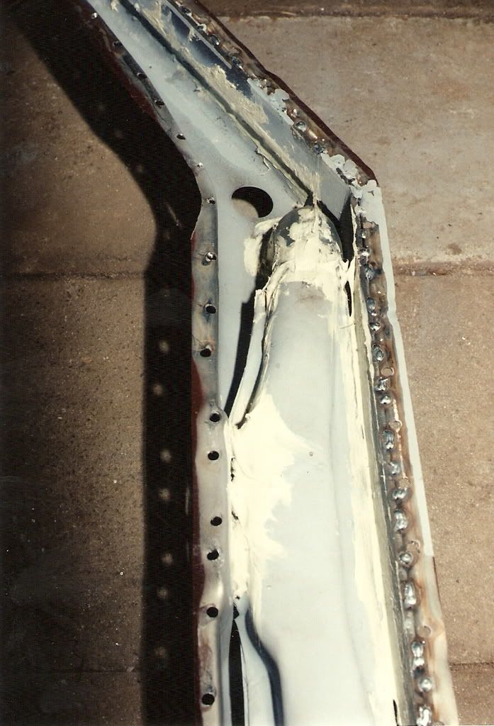

I'll save you all 'the bad' pics, but it was very, very rotten. Largeluy due to the original sun-roof:

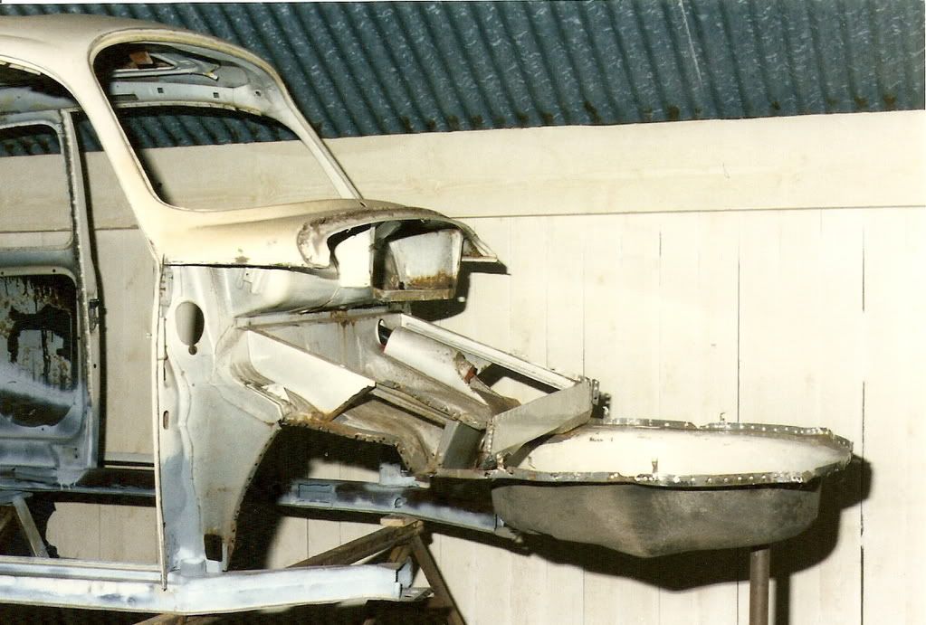

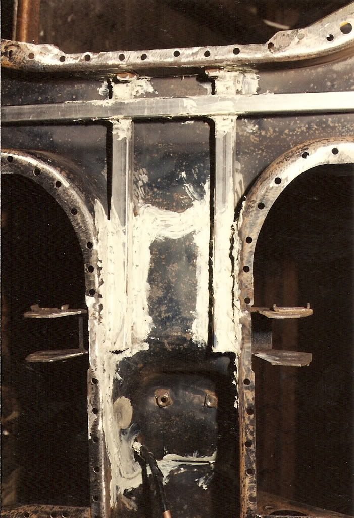

Drill-out all bad parts :

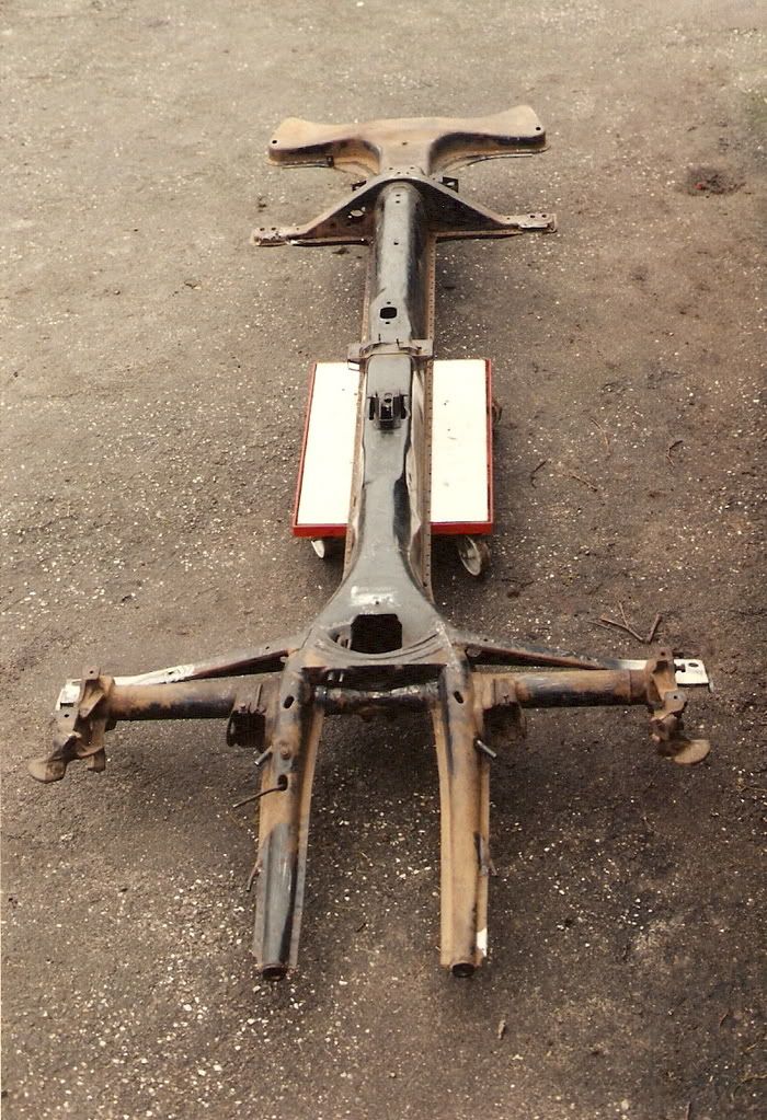

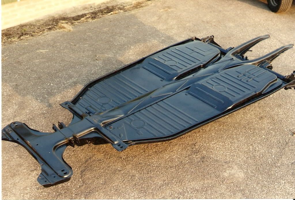

and replace with new. Also added some sill and chassis strength:
http://i174.photobucket.com/albums/w...8.jpg~original

Wally April 14th 2009 04:15
It has been a 9 year restoration process before she was taxed and inspected again...

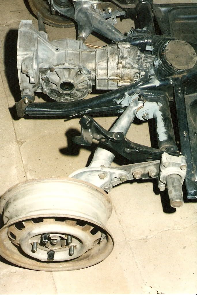

Of course I also made the 944-Cup suspension under there in that period and had to figure it out all by myself as when (1994) I did the entire suspension mod, nobody I knew of had done that (alu trailing arms and Cup-spindles) before.

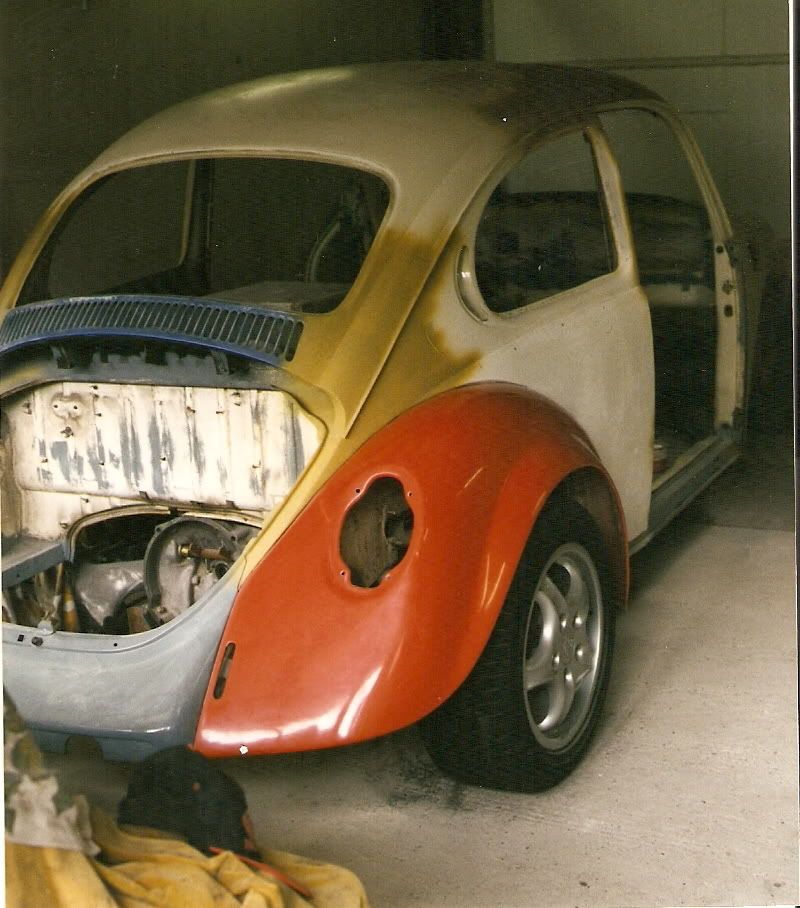

'After' pics:
Also moving house, which also meant moving the car from the farmers barn to the garage I first had to build myself behind the 'new' house back then (1998):

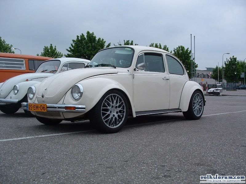

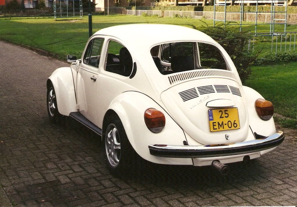

Finally, first time out, painted and on its own wheels (early 2000):
Gotta love the scanner :)

So, first were the 16" rims from a 993 '94 model, then came the 17" BBS rims:
http://i174.photobucket.com/albums/w...l.jpg~original
and of course the current 18" :

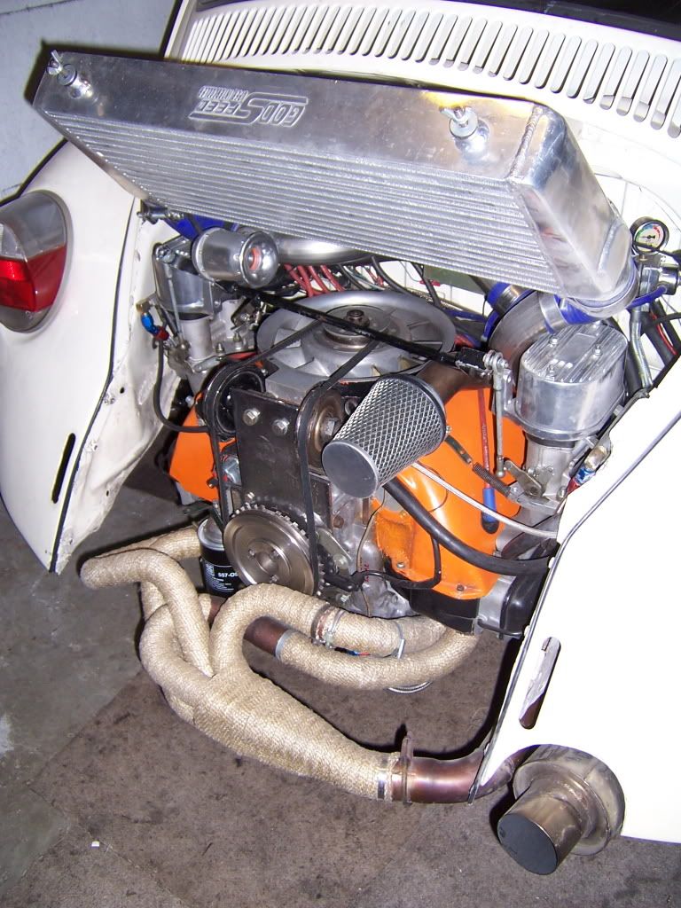

The turbo engine is almost ready. It already ran, but I didn't seal one of the plugs behind the flywheel, so I have some work ahead of me.
I hope I can post a clip of it running leak-free soon!

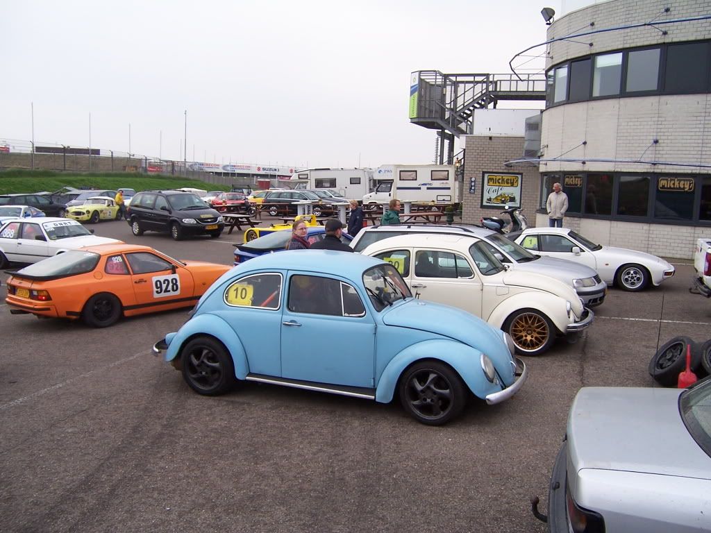

To run her in, I did something 'terrible' and drove straight to the track day that was today :rolleyes:
It really was the first time the car stood on its own wheels for almost 3/4 of a year and the first time I could try-out the new gearbox (G50).
Let me tell you, the G50 shifts beautifully! Very light and easy. Bit long, but its a factory shifter after all.
Engine still had an oil leak behind the flywheel, although last night it seemed leak-free...probably therefore the clutch slipped some when the turbo cam in a bit sudden, but on the track today we (Marius has the blue oval with a tuned type 4 2.0 n/a engine) surprised many cars with our little bugs.
