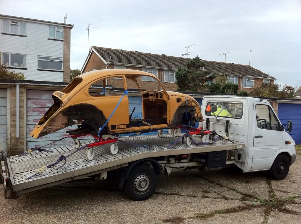

Once it was a bare shell it was sent off to the bodyshop:
A promising start, but sadly it was not to continue... Basically i was not happy with the work being done, and after a few months hauled it out of there :-( Cue 8 months of depression before I found someone else to pick up on it. There's obviously a big gap between above and below, but this is how the shell is today:

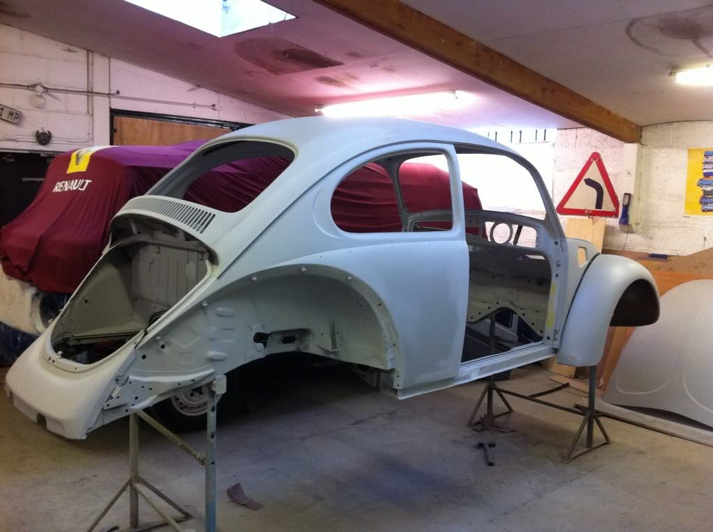

Last few mods to the shell to do, and then next week should be in paint!

Great story! Hmmmmmm wonder what those holes in the firewall are for? Turbo and intercooler?.....
Sadly no turbo/intercoolers allowed - Beetle Challenge regs state "non-turbo", MSV Trackday Trophy rules state "if turbo fitted then must be correct type for engine" so ruled out there as well. Other series seem to have similar restrictions. :-( Still, i'm targetting somewhere around 180bhp so it won't be short of power. The holes in the bulkhead are for cold air ducting straight to the back of the fan (from NACA duct in right rear window) and to oil cooler under boot floor (from NACA duct in left rear window). There is still another hole to be drilled in the boot floor for the oil cooler air-feed.
