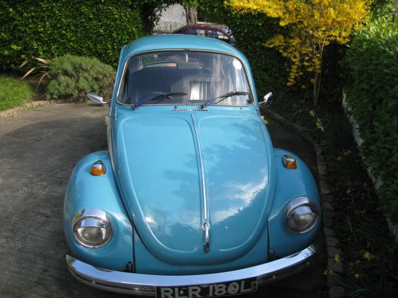

Hey guys I've decided to restore the bug to german look.
Its a 1973 1303 with a 1300 engine , it says 1303s on the decklid but ive been told its not a "S" .
got lots of time on my hands. ive been on the eircooled.com forum but was told to go here cause you guys know everything and anything about converting a superbeetle to German Look
never done this before so im going at it as a newbie
ah ive got so many questions.
so ill let the pictures do the talking , to get me to where i am.

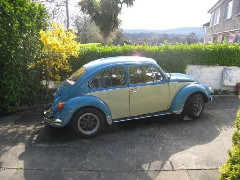

This is how i got the 2 years ago in manchester,

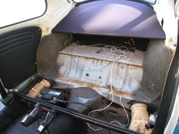

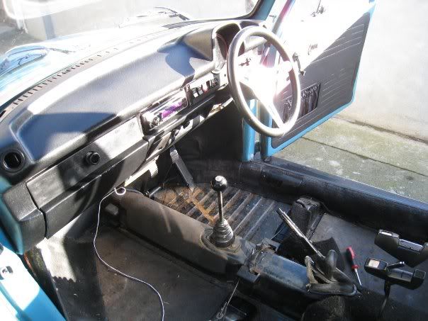

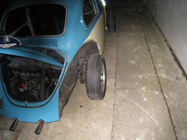

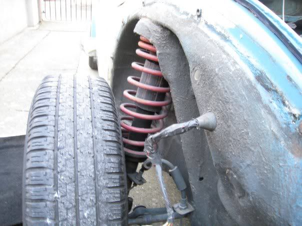

this is where i am at now , fenders off interior out glass out

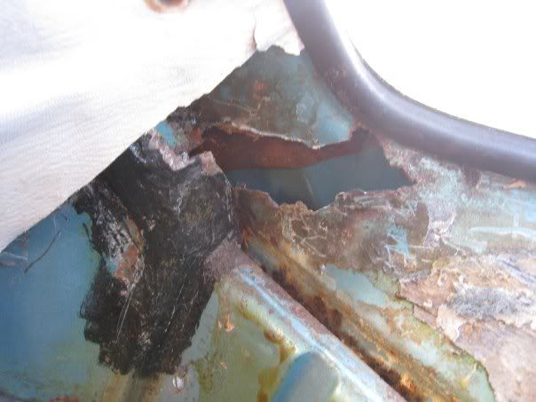

got a bit of rust here ...
so thats that part sorted,
