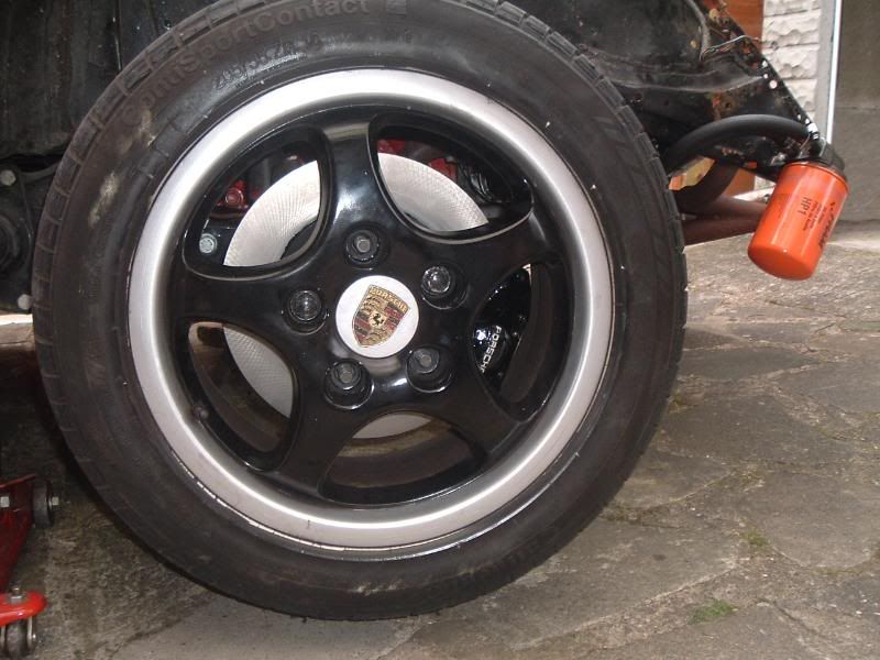

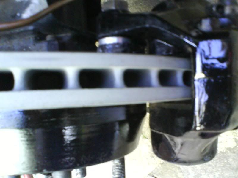

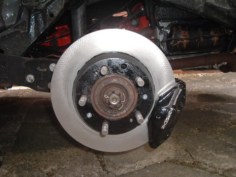

Just trying to get a caliper inside my 911 7x16fuchs without spacers. Does anyone know if the 964 2pots will clear the spokes of 911 number 16inch fuchs?

I have them under 17 inch BBS wheels, that wont help but maybe the photos will.

Can you tell what discs you are using? 944T? Do the calipers extend past the wheel mounting surface of the disc? Or are they well inside?

They are just stock 944 discs, I will do a proper measure if you need it tomorrow, its 11.30 pm here now, I don't want to make a noise, but it looks like the calliper would extend a little past the wheel mounting flange.
I have the Porsche parts system on my PC and it looks like the 7x16 Fuchs was the stock wheel on that model.
I have a 15 inch spare in the car and it just touches the calliper.
I bought these callipers locally, the work well, they have a 42 mm piston and on the front I'm using early Type 3 front callipers also use a 42 mm piston, its was just slightly over braked on the rear before I fitted a bias valve.

I measured 44mm for the 964 C2 caliper, so maybe hence the overbraking?

i ran these calipers on the back of my bug for a while - they were great although i cant help with the answer regarding the fuchs - i ran them with 944T discs (24mm thick same as the 964 c2) and i also ran the 964 16" cup wheels.
one thing to note is if running with the 944 n/a backplate/handbrake bits i had to use a small spacers to centralise the caliper over the discs. 3mm iirc
hope this helps
